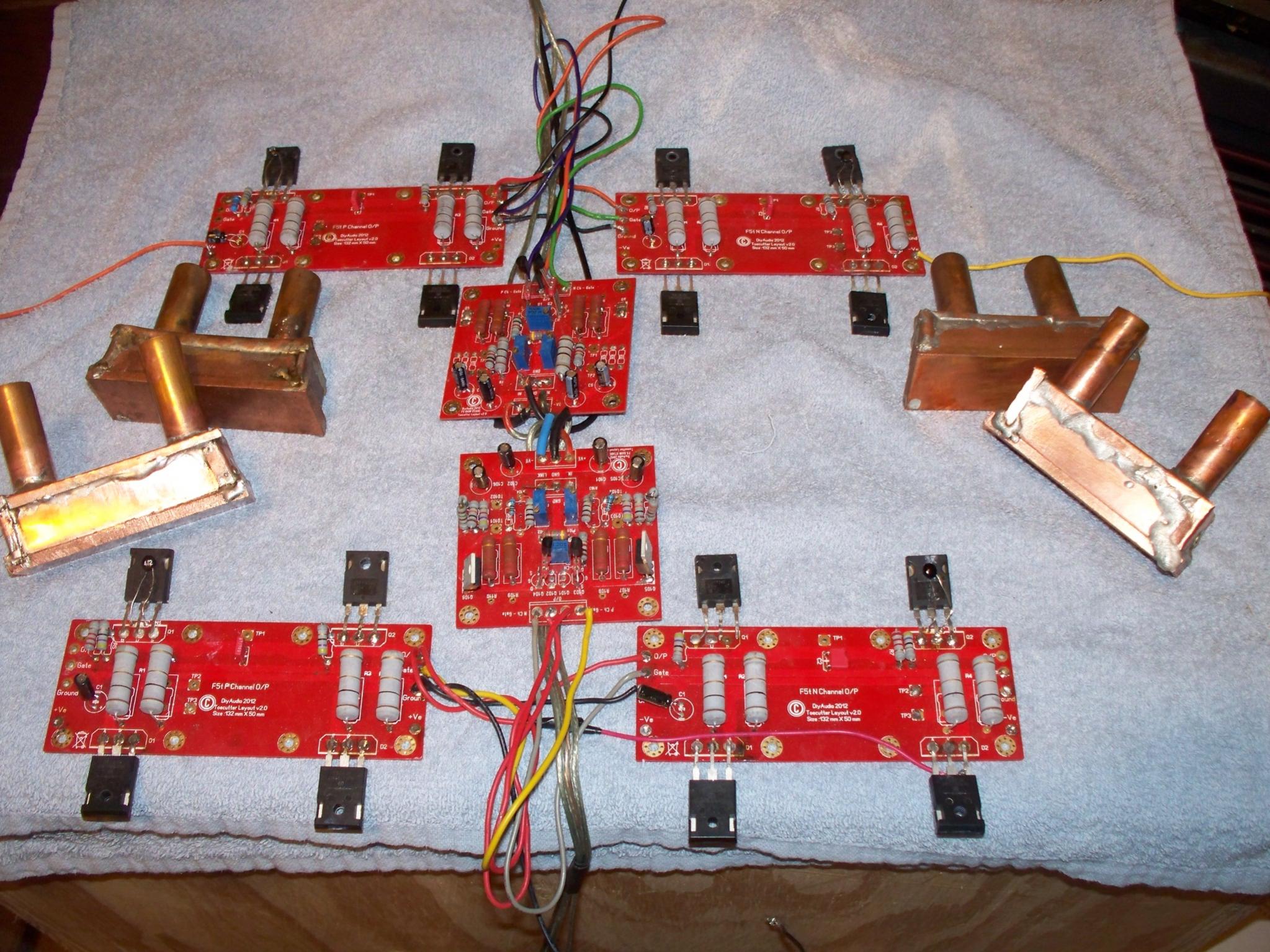

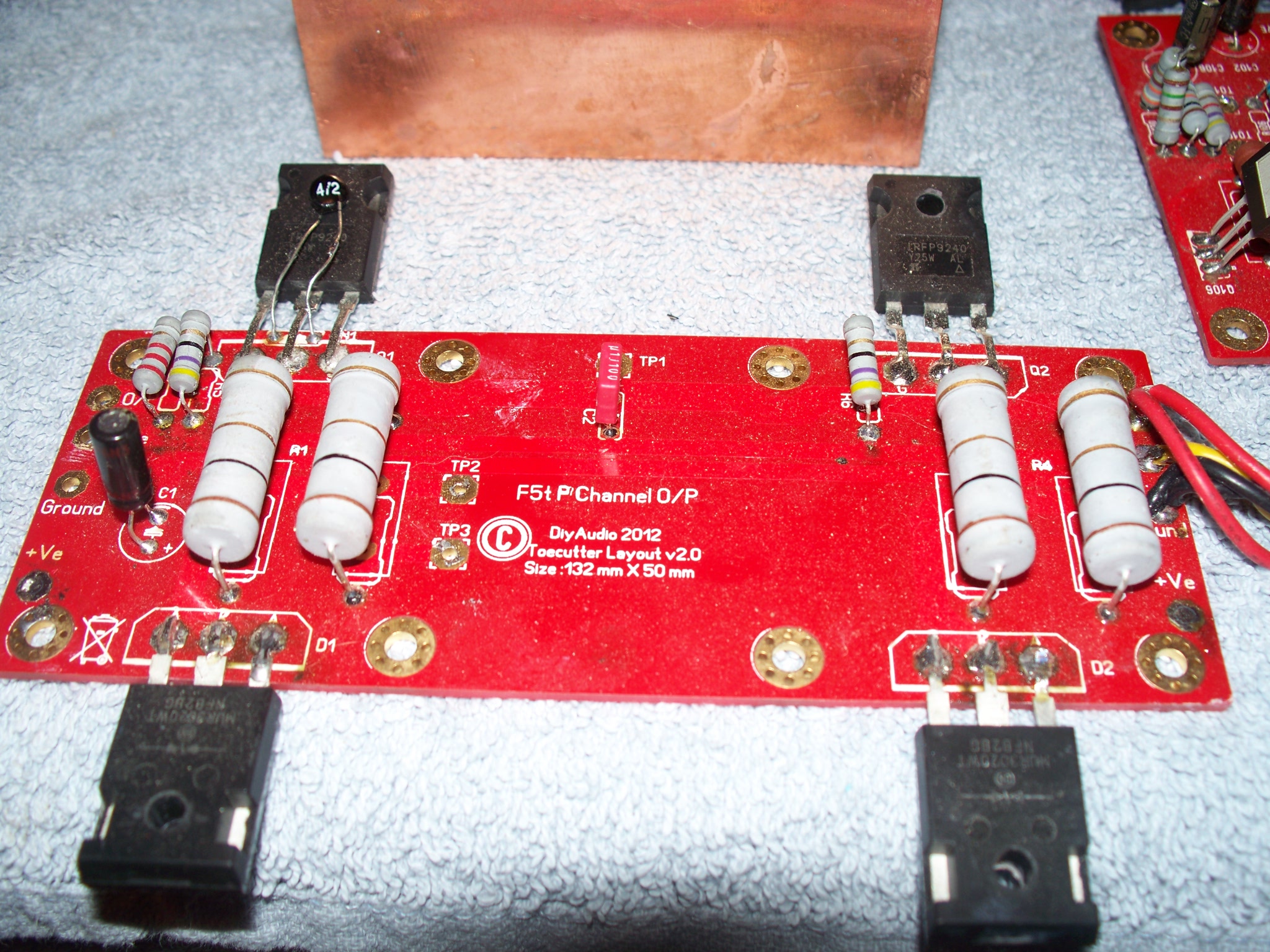

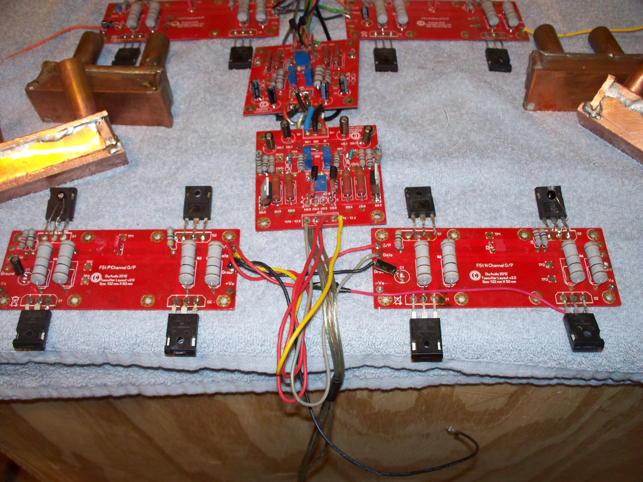

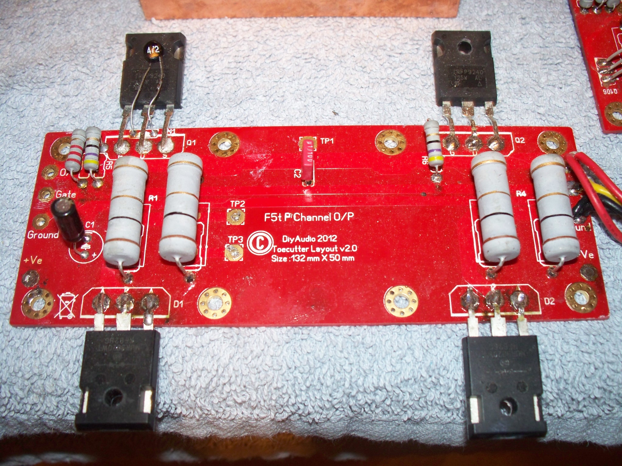

Hi UKTocutter,
Check out these boards they are almost ready to get in the box,They have played and sounded great too!They will be water cooled for the Bigfets the MUR's don't seam to get very hot so they will have standard heat sinks,Gets so hot here in TEXAS got to put water on them,lol.I cut some server copper heatsinks in half and covered them with sheet copper and run 800 gph with a 10 gallon Reservoir,I have a 50 watt F5 setup like this now,haven't had to add a radiator yet,but it's coming,lol.
NS

What did you use for th3 2SK170 and 2SJ74???
I purchased these boards, F-5 Clone, recently and cannot seem to find these transistors OR a drop in replacement? I have been all over the Net looking for these. Ones from China, NA.
Paul
