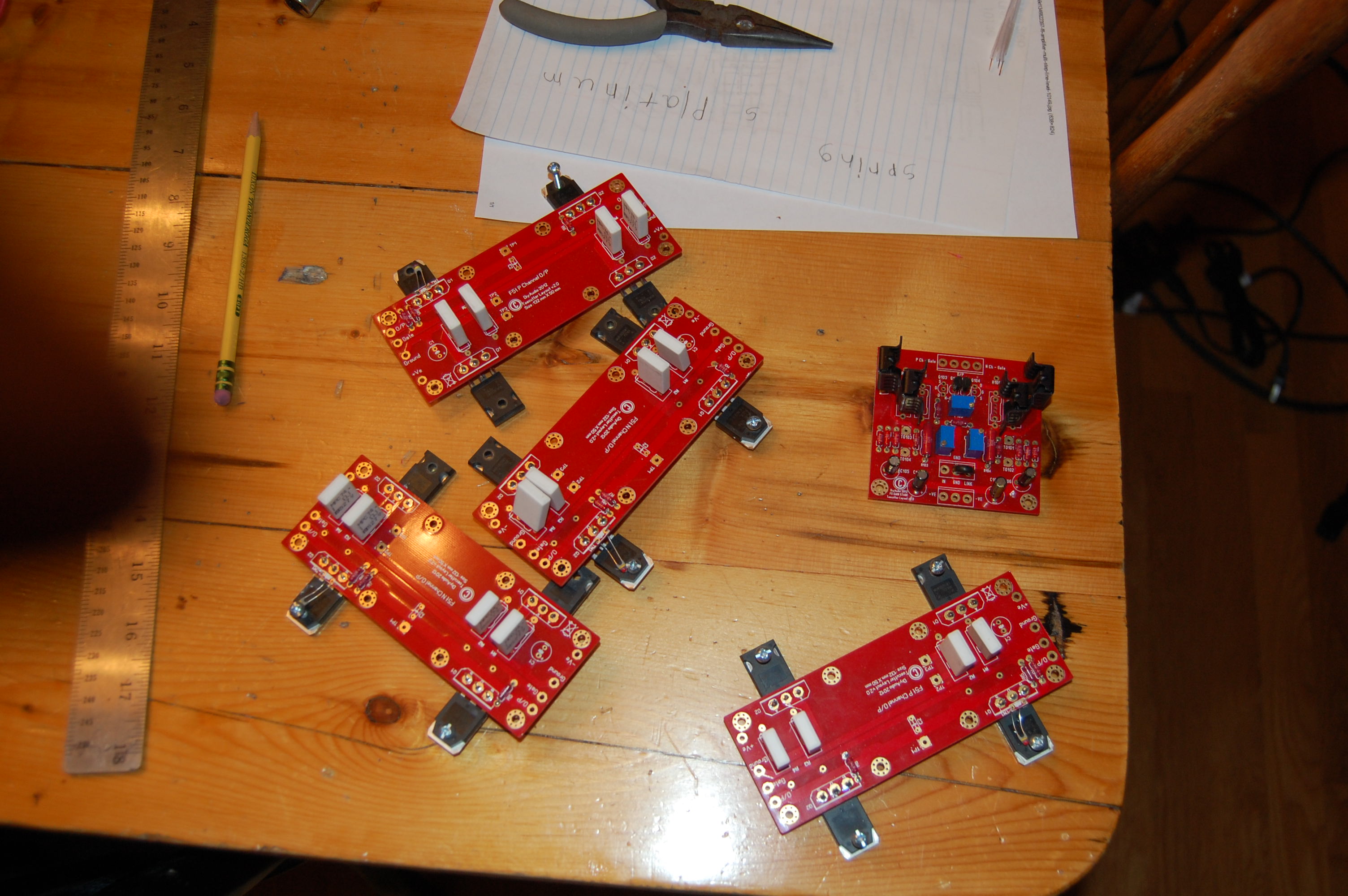

attached the UMS from diyaudio for drilling the holes, overall dimensions can be found in the article details in the store (see Variac's link).
Would you mind clarifying your response and give me your opinion as you stated you have one ?
Max
Gain Stage 146x70 / N and P channel output boards 132x50
While not as well documented as other boards the info is there:
http://www.diyaudio.com/store/ampli...iers/first-watt-clones/f-5t.html?options=cart
The UMS shows how you can mount 2 output boards per heatsink in the 5U chassis

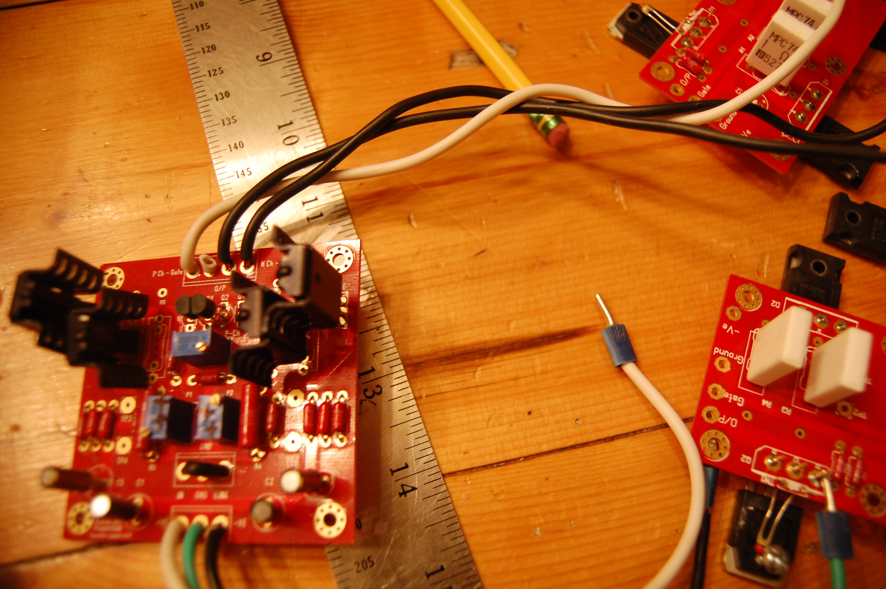

The store boards do make daisy chaining the outputs easy. You will need a long sink, or a tall one that allows over/under positioning. Here are my boards. I used quick connectors to test amps for easy install and to avoid soldering. These boards will be heading back to Variac and hopefully will be given away at BA. I have had zero issue with stablilty. I have built 5 f5T's, as of this set. second pic is quick connectors I use. They fit really well into most pcb's. Radio Shack has them.
