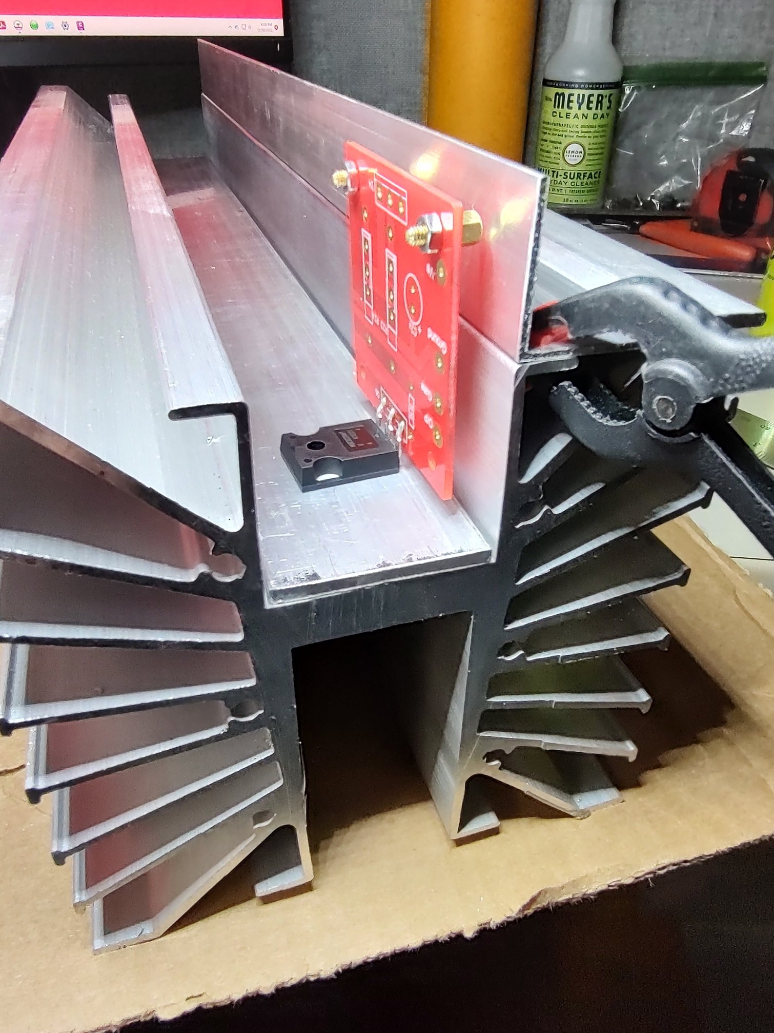

Here is a mock-up. I think 3 points of mounting will be adequate since the fet will be so close to the board I may be able to involve the wide part of the lead in the crown of the solder. I plan to space each fet exactly equal in all directions and am also considering the potential thermal effects of mounting the heatsinks to the chassis. Thinking of thermally isolating the heatsink mass from the chassis at the attachment points so that one area of the heatsink won't track differently than the other. Not sure if I will use the 1/8" base plate or tap the heatsink directly. Probably the latter.Yes, omit the diodes.

Balanced doubles everything, including heat. Keep the plan and continue forward, things can be modded/changed later. F5T is a very nice sounding amp, and can be tuned to taste with P3.

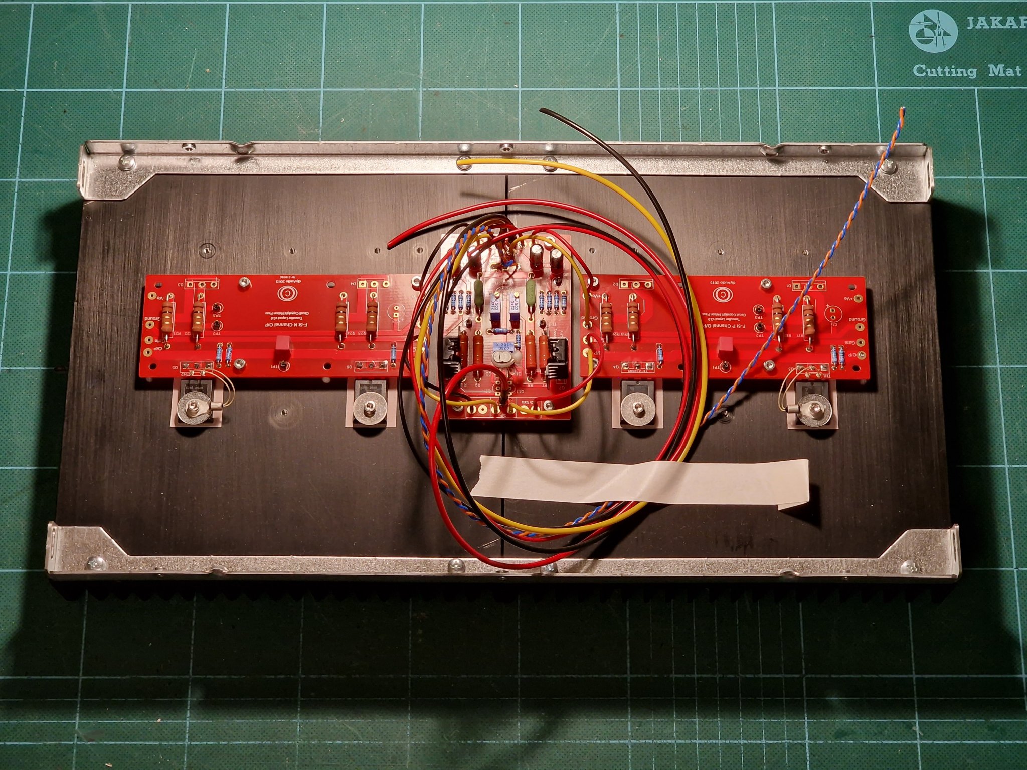

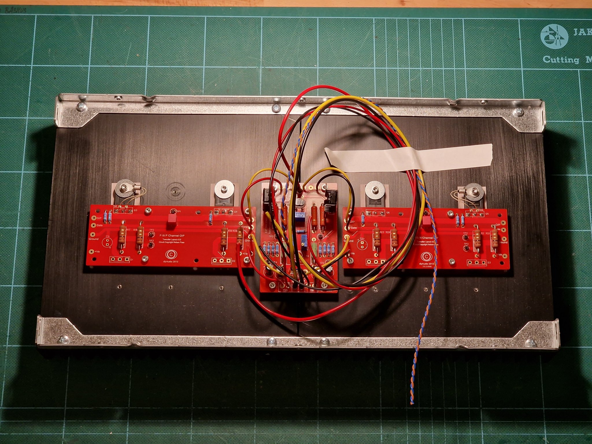

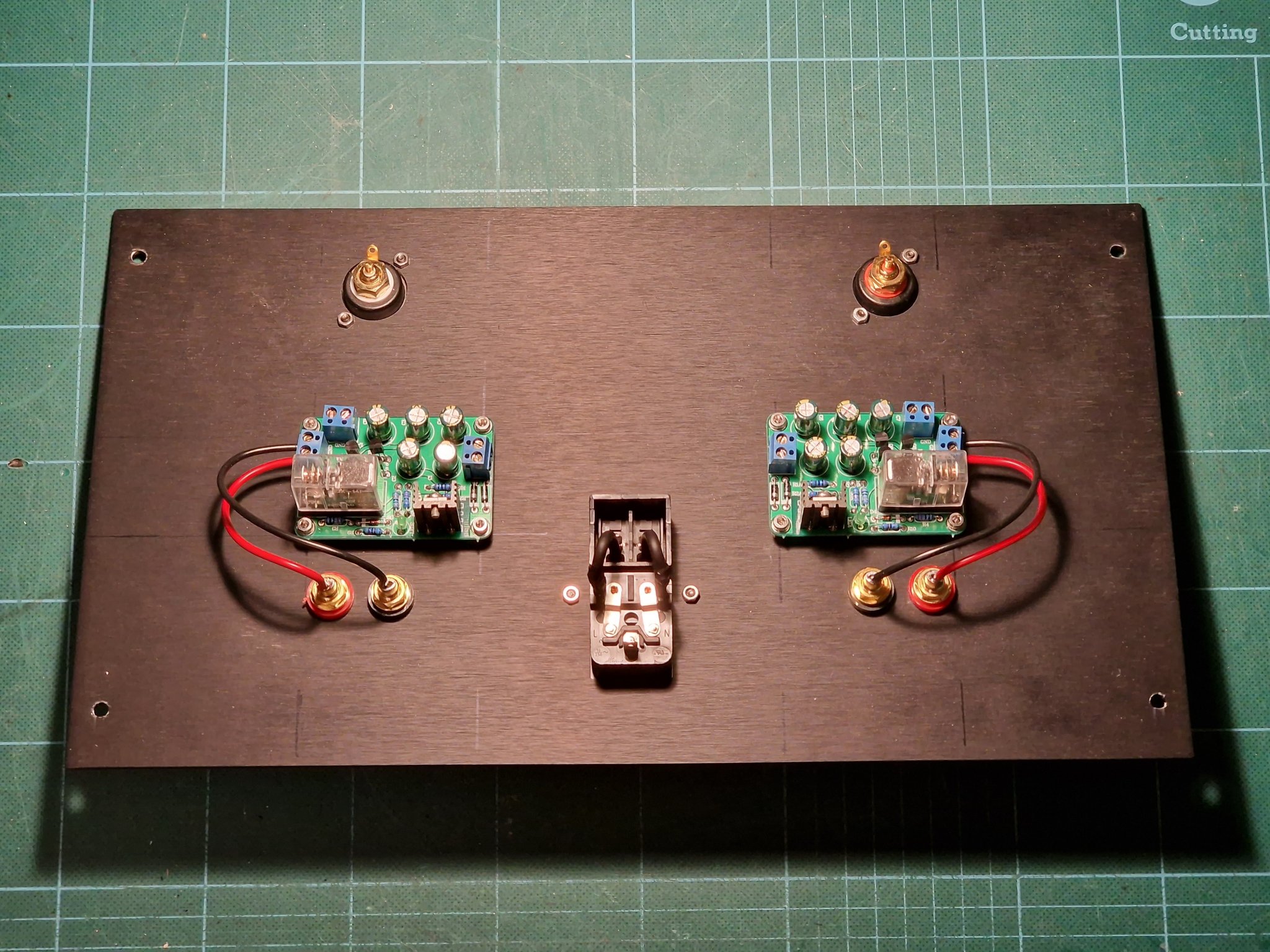

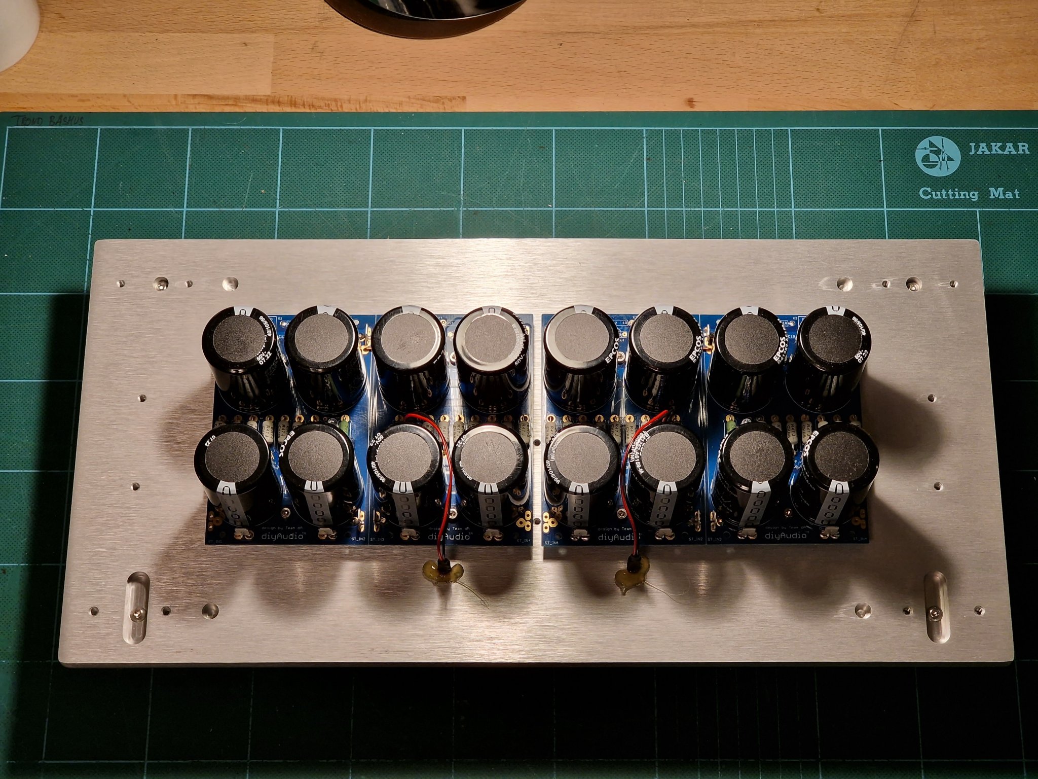

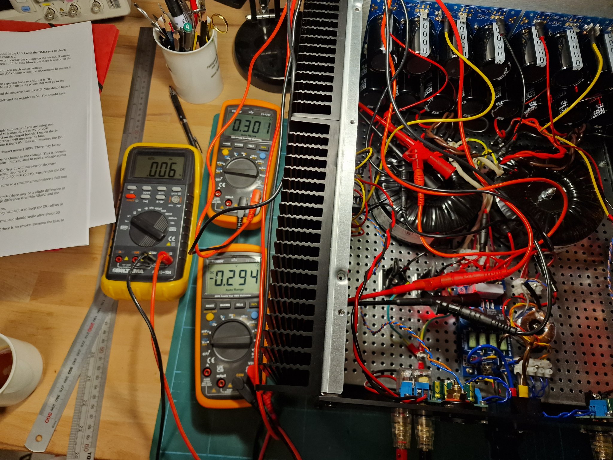

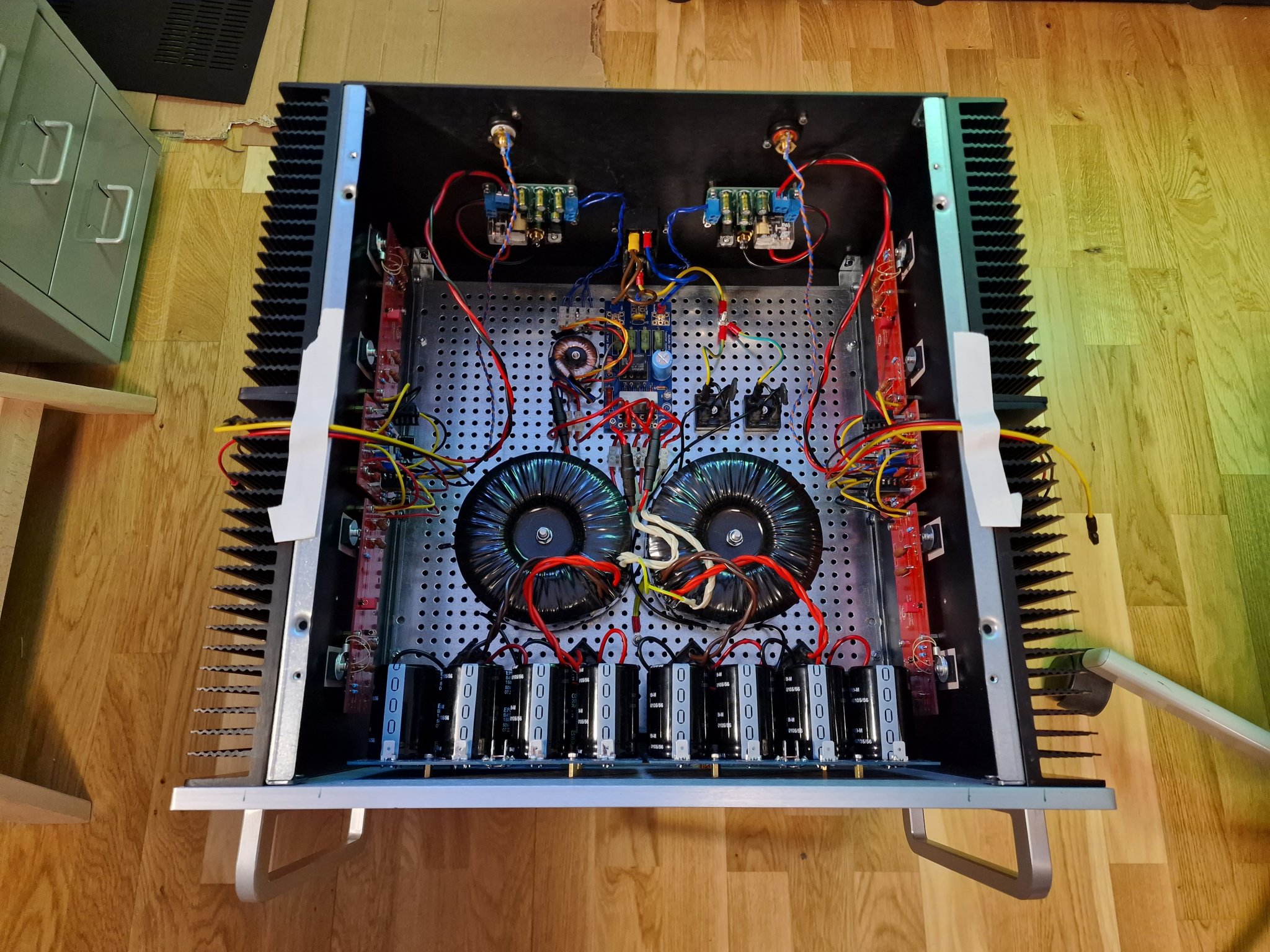

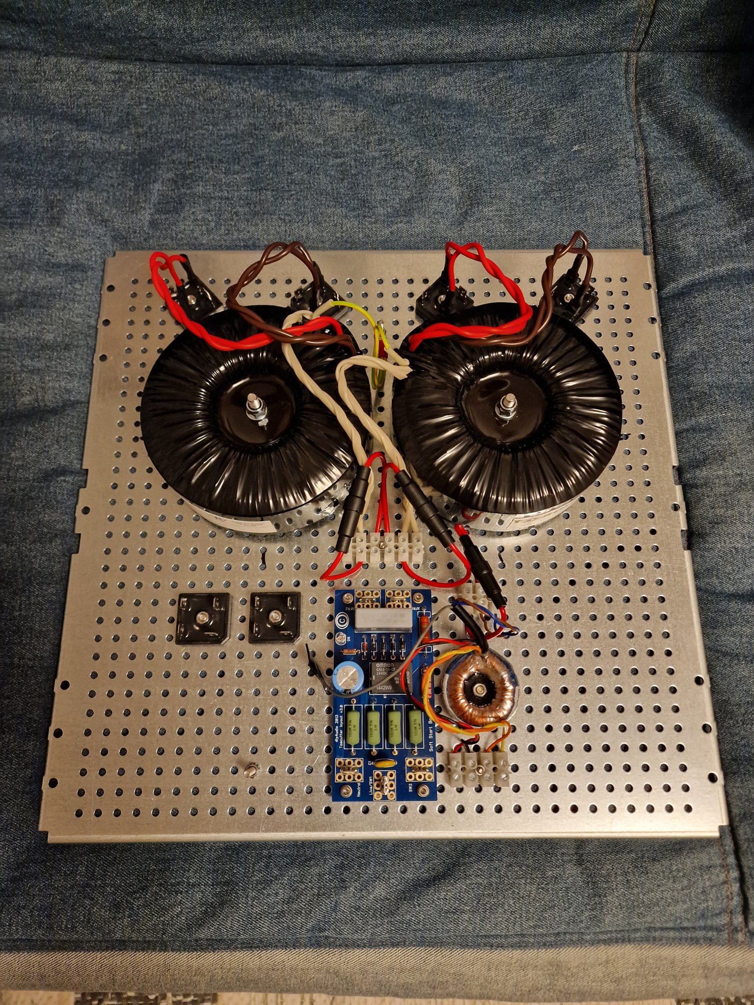

I told myself I should take a brake from building stuff, but now I'm well underway with a F5 Turbo. I'm building it dual mono, although I doubt I'll be able to tell the difference compared to a shared power supply. I've also added soft start and speaker protection.
Some photos below just in case someone can see something obviously wrong ...

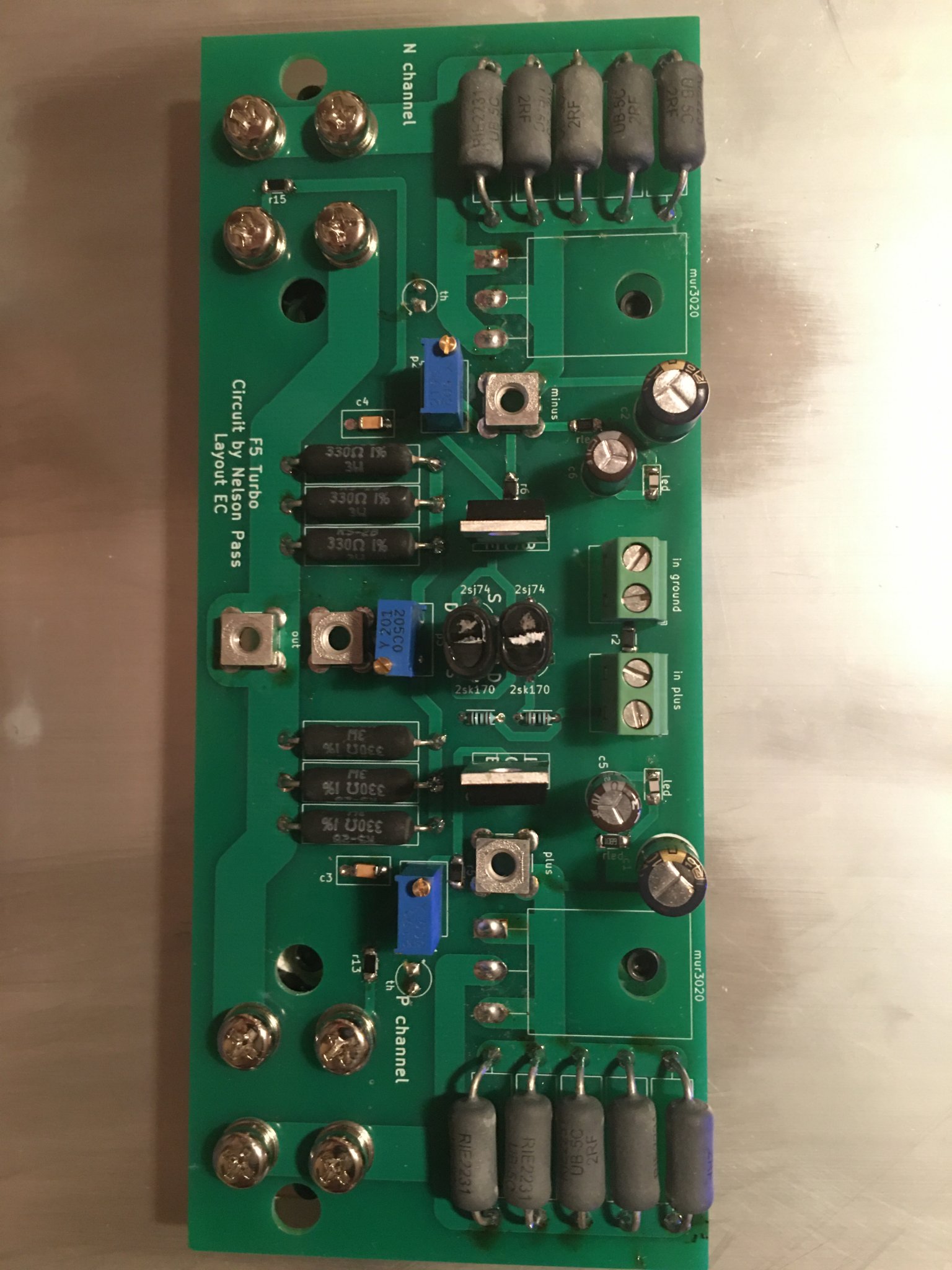

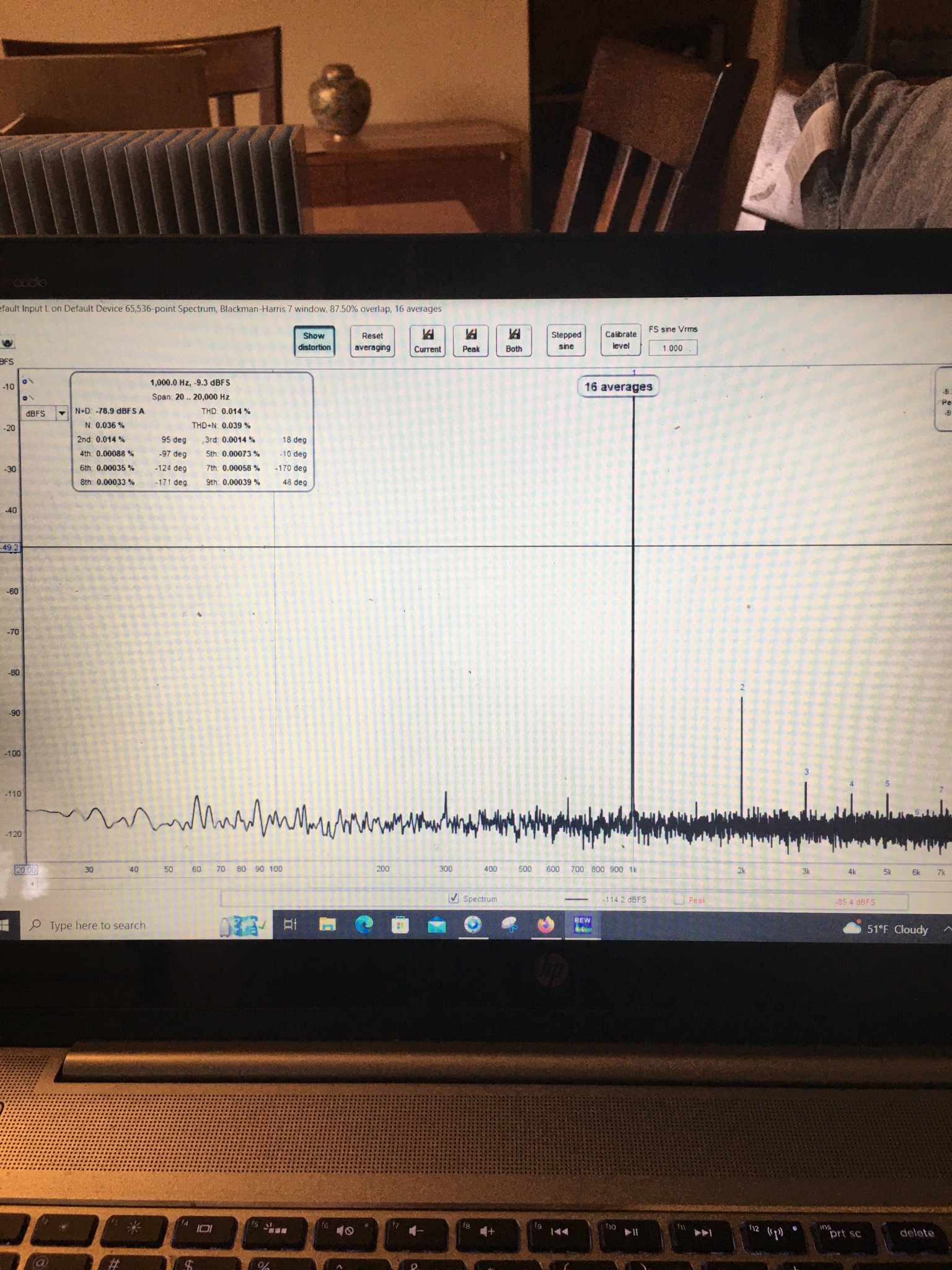

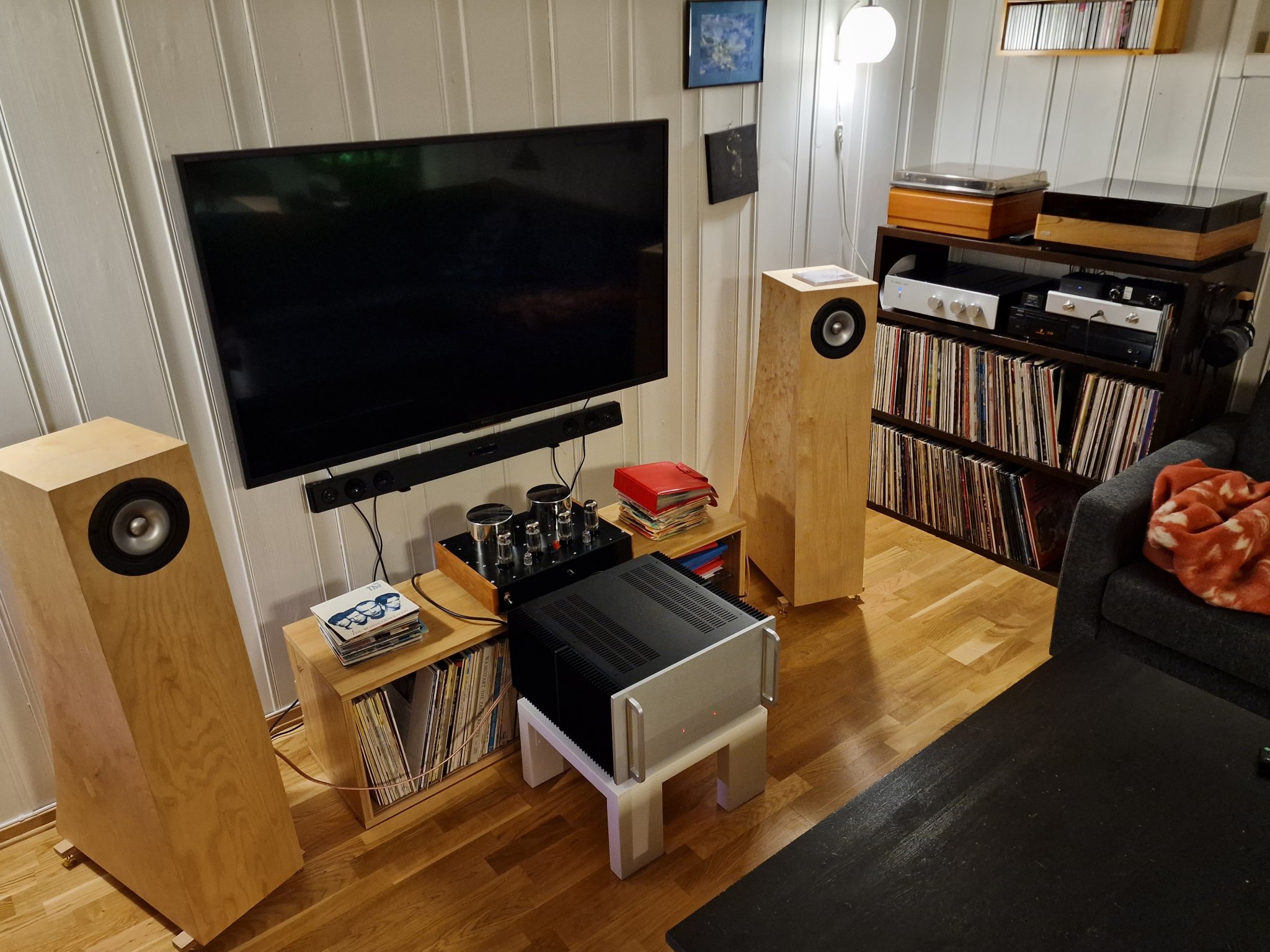

I haven’t been around much lately but I did a thing I wanted to share. 43 volt rails. Bias is set conservatively at .3volts over .4ohms. I have the mur diodes installed. I’ve really liked my f5 but wanted a bit more power. I look forward to trying the amps in my main system after a couple days playing on the shop speakers.
Thanks and enjoy.

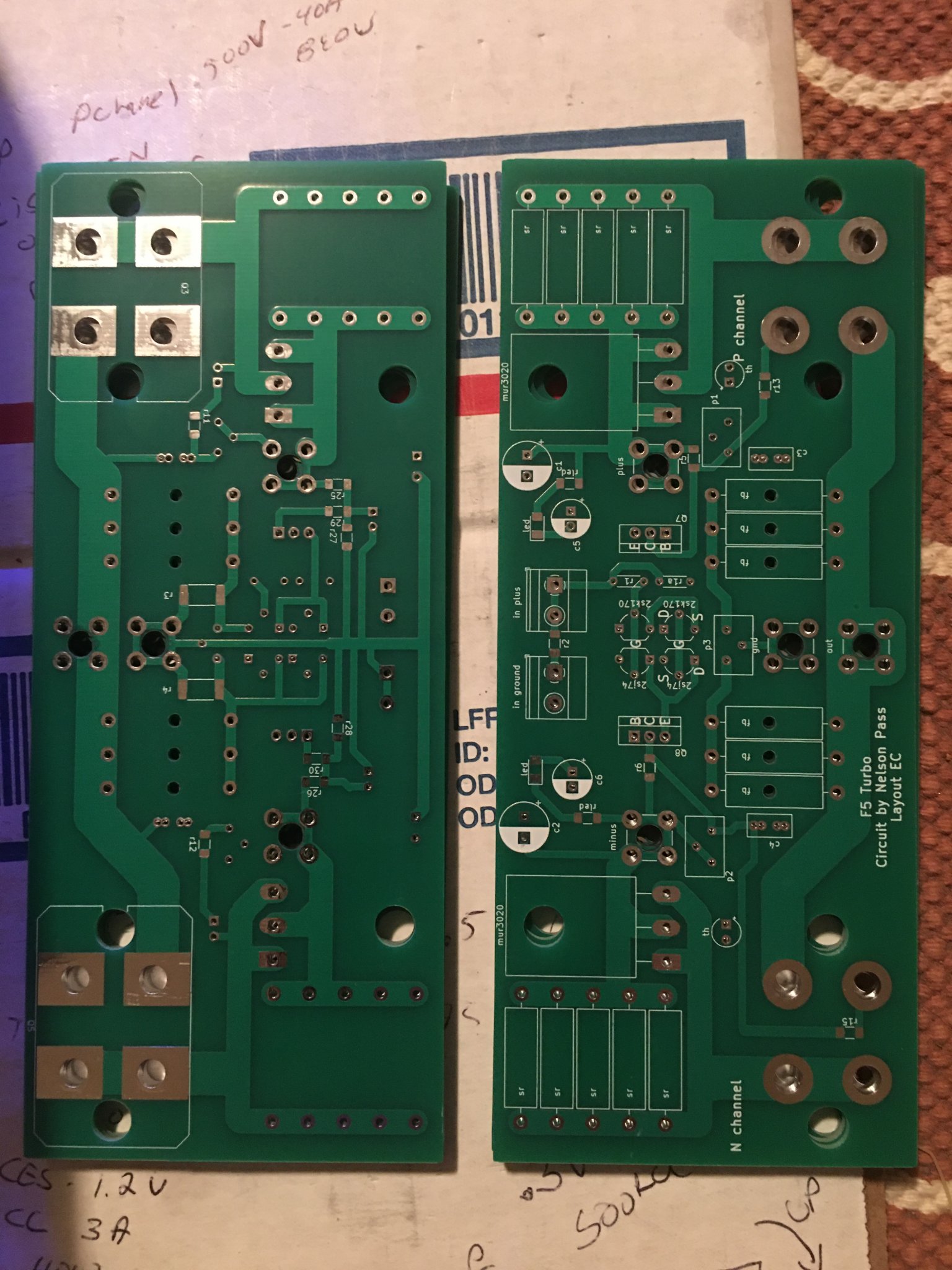

Can anyone give me the dimensions of the F5T boards? It's listed on the DIY audio website for the power supply boards but not the output boards.
I'd really like to lay all this out in AutoCad before making the jump

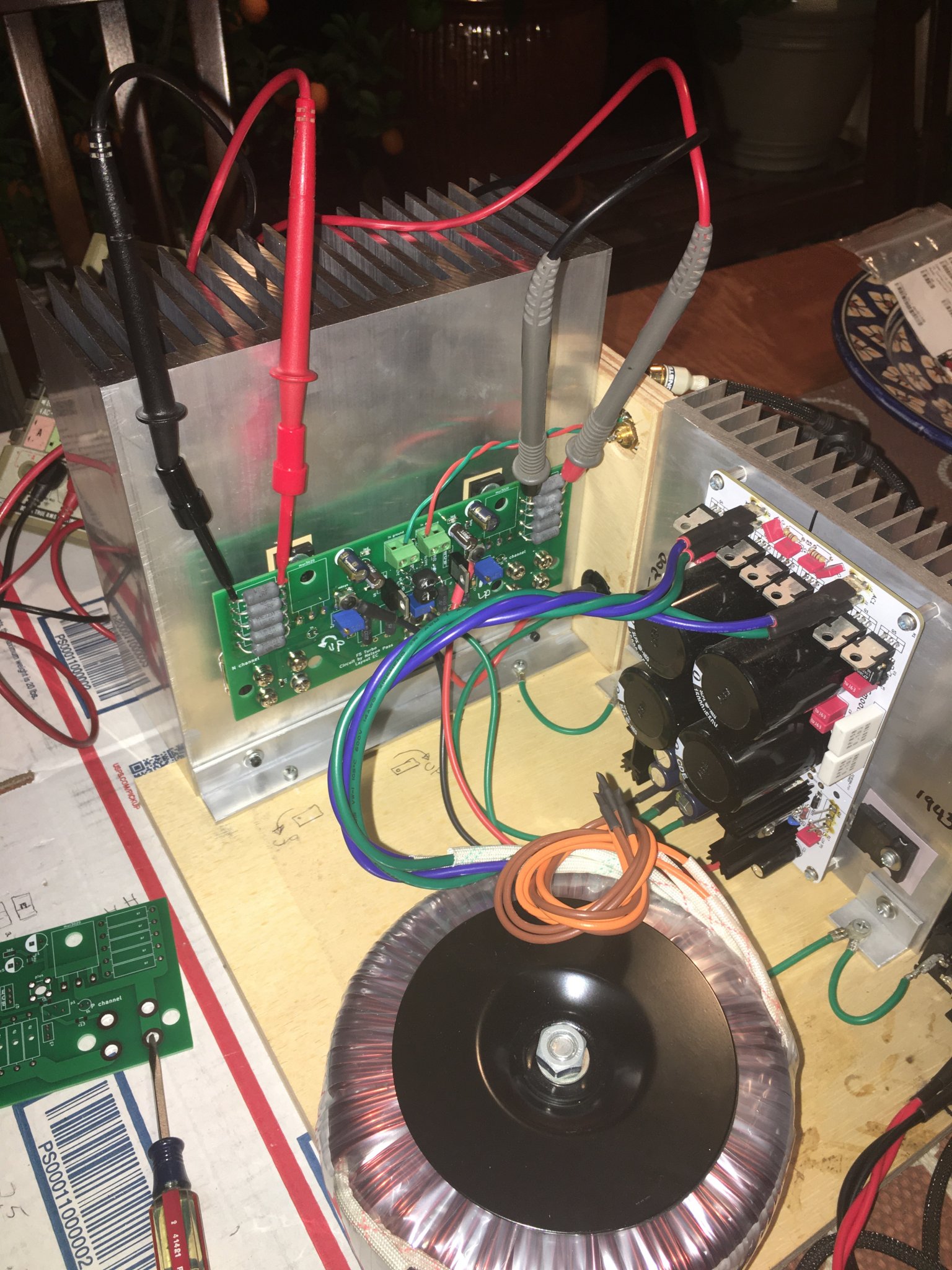

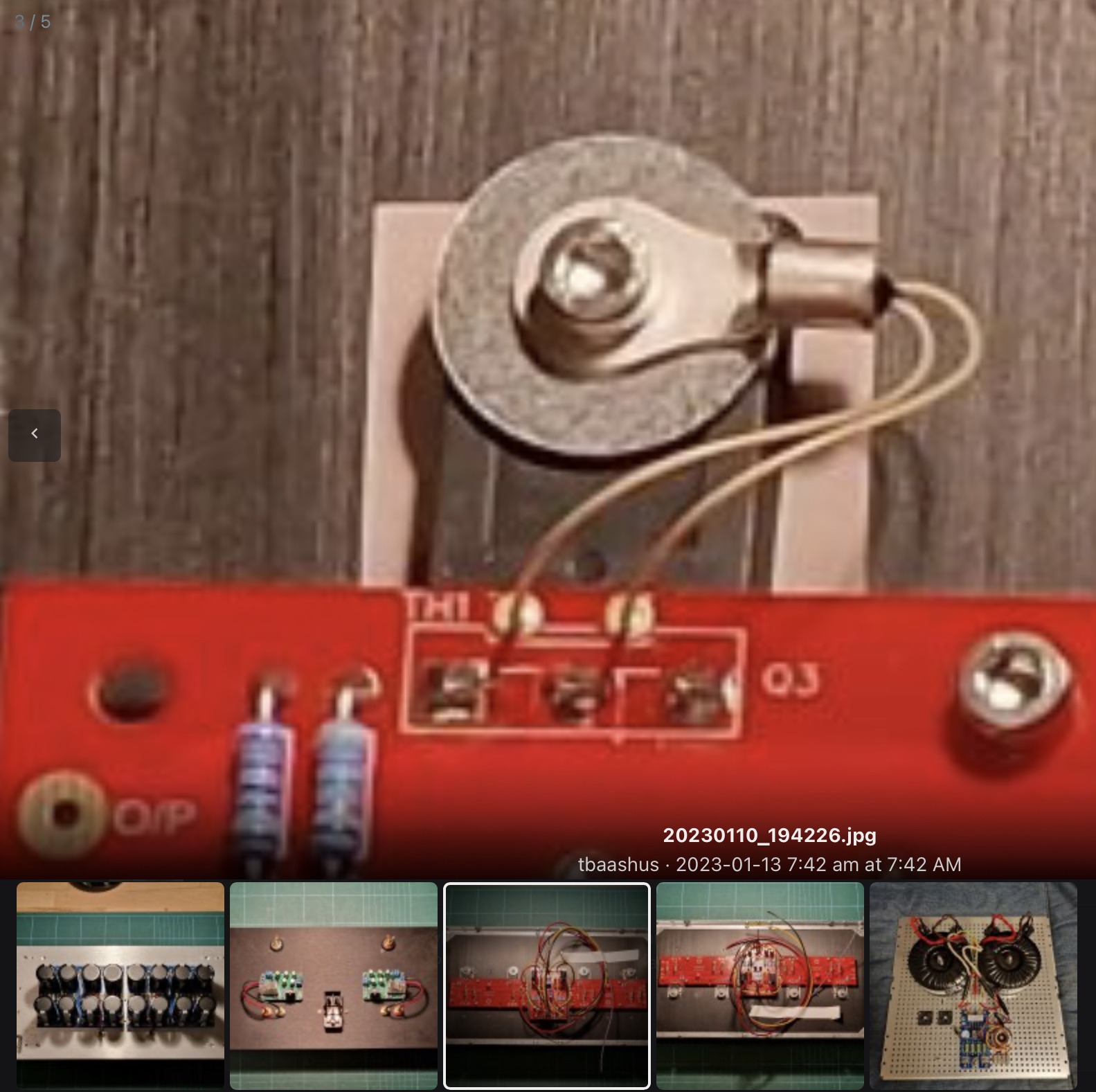

Well I finally finished my F5 Turbo after a flame up. I replaced the four fried mosfets then rebiased the amplifier. Everything is mostly fine, aka it arrives at bias via normal means, no giant leaps in bias, no crazy voltage or heat.
However I have one issue that seems to be a major issue, the bias is constantly drifting upwards. It's very slow but noticeable and can't be left unattended due to this.
Has anyone seen this build drift badly? Is there a solution?
1. Yes. If your heatsink is too large for the bias you set, this will happen. Because of the way large heatsinks work with multiple devices, you get a temperature gradient between devices and since you are only sensing a single device, the other can begin to run away.
2. Yes. Requires modification of the schematic beyond the scope of the discussion, and the PCB is not suitable for the required changes. See the original F5 article for the thermistor connection. Use a small value cap + series resistor to damp the thermistor action at HF in parallel with the Th+R combination. Touch the thermistor to the heatsink instead of the MOSFET.
This is not an approved modification, but almost guarantees impossibility of bias creep. The penalty is longer warm-up time because of thermal latency, and more fiddly bias adjustment.
Thank you so much. I will look into this modification. I can see the heatsink issue too, as it is a diyaudio store 5u case.
I can see how the thermistor mod isn't great for the pcb.
