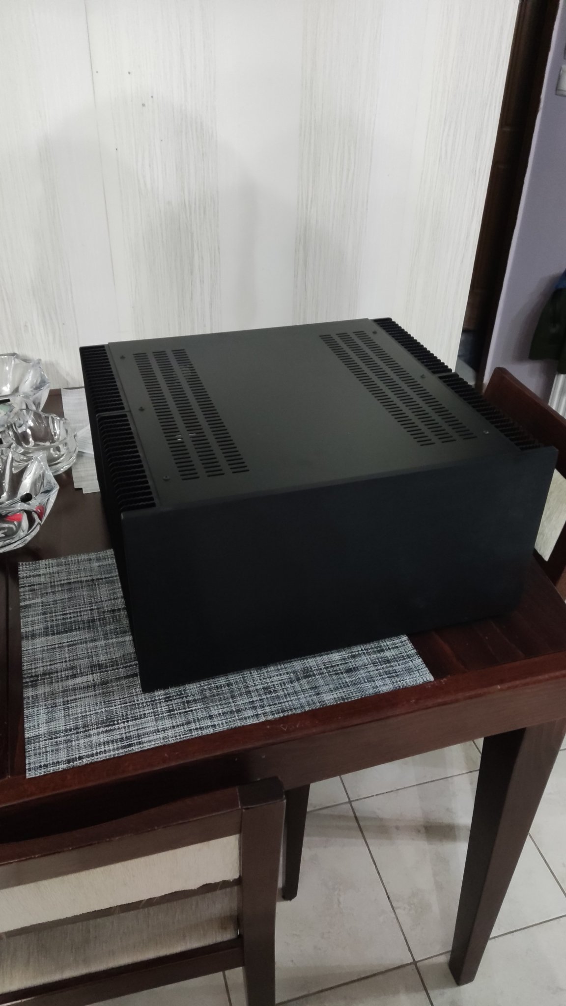

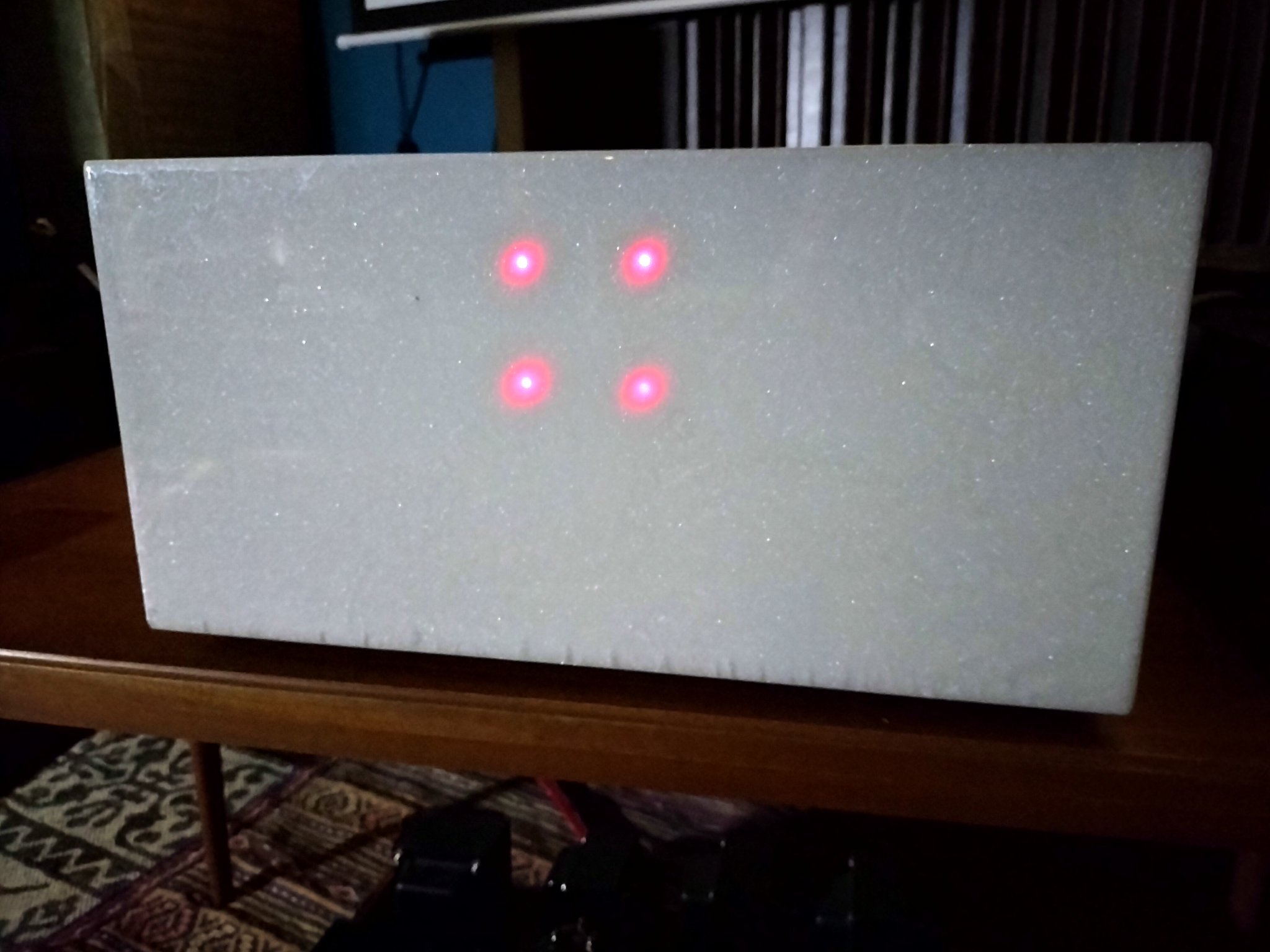

I took another look at my work and realised my mistake, too embarrassing to relate here. Amp now up and running wtih both sides at 55degrees C
I must say this is a lovely amplifier and much nicer than my old F5 which I never really got on with ended up preferring the F6 or M2X but this amp has real synergy with my Dynaudios. Thanks for your direction. Phot of the amp posted below. I ran white pearl resin over the front panel with narrow hot glue filled holes in the aluminium for the LEDs. You can't see them when they are off.and they are diffuse when lit, the white centres on the photo are red in real life. Cheers

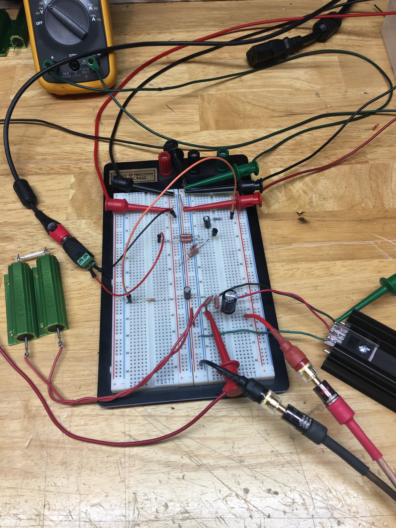

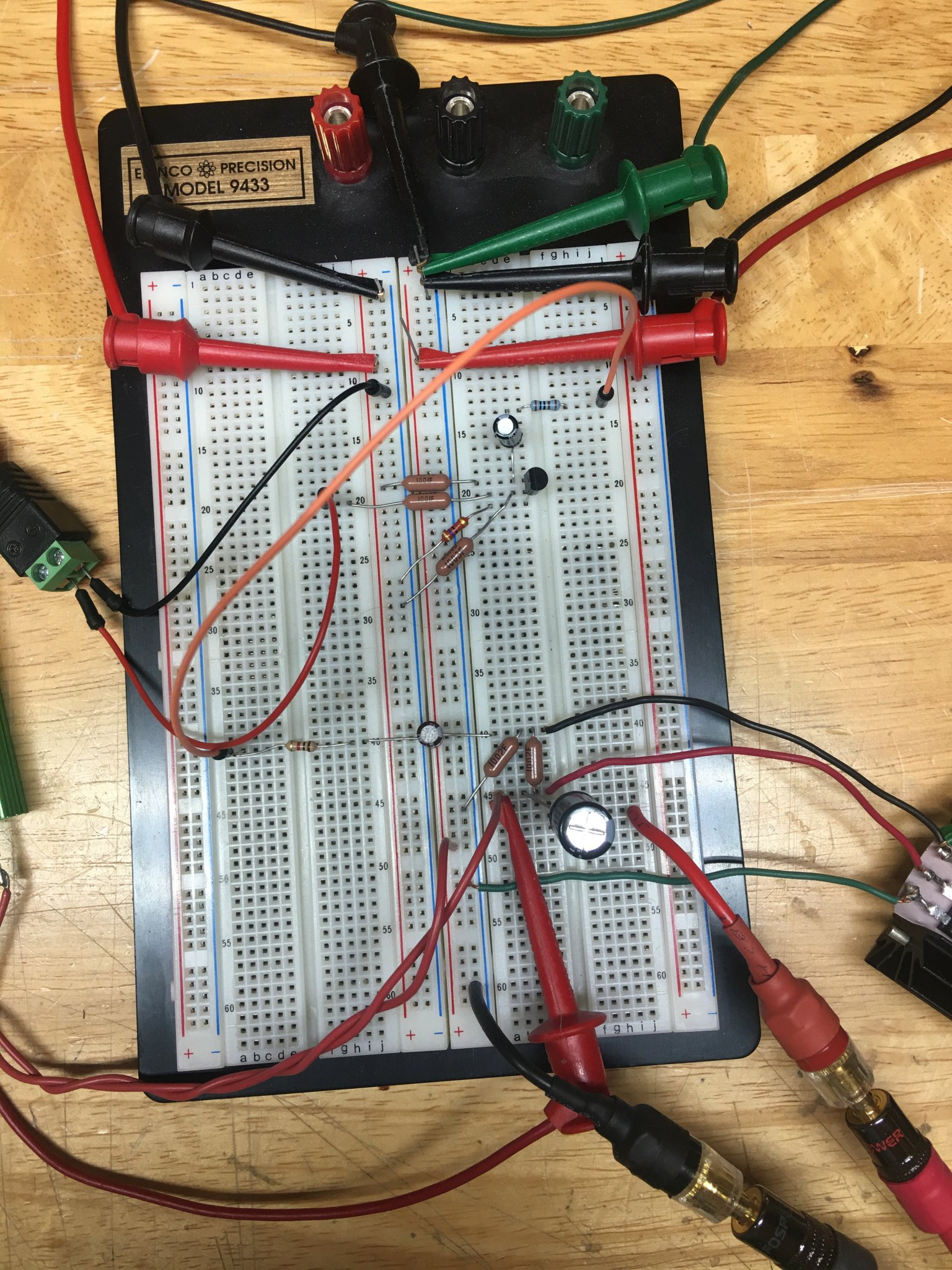

So I'm reading the F5 Turbo article in preparation to build an F5T V2. This led me back to the original F5 article where I stopped at Figure 3...it says "You can build both of these circuits and they will work". Attached are working examples of the preamplifier and amplifier circuits I built on a breadboard. You wouldn't believe me if I told you how long I spent building and troubleshooting these two. Maybe you would if I told you I grabbed an IRFP9240 out of the drawer instead of an IRFP150. 😡
Anyway, It was fun and a good learning experience! Not quite to the Turbo part though.

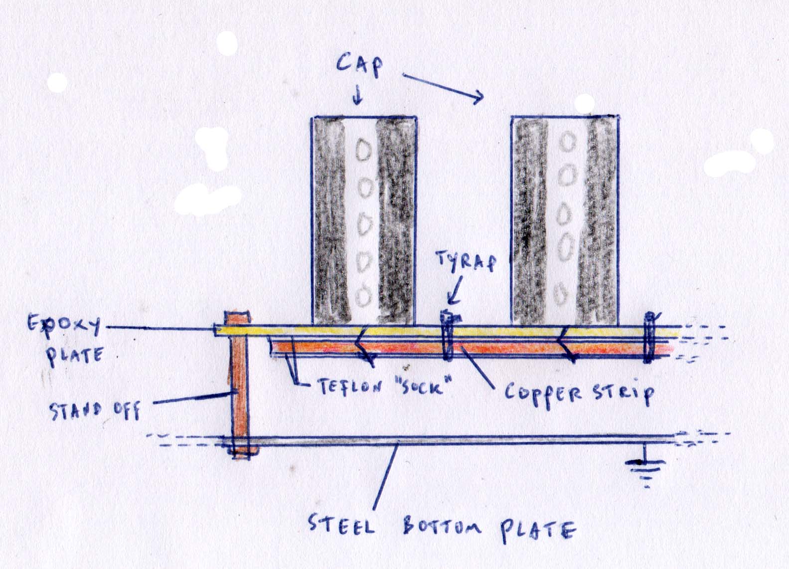

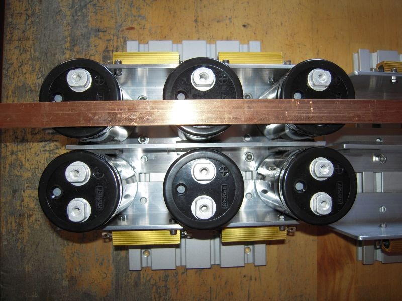

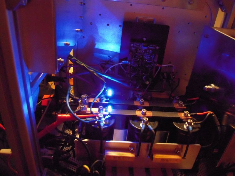

I'm rather a novice when it comes to electronics, especially PSU's. I decided to use 8 capacitors of 10,000 uF per rail for my F5 Turbo build, but thus can't use the diyAudio Store PCB's. Now I'm thinking of making something myself, using the diyAudio PCB as a templete, and E-Cu strips 1mm thick and 5 and 20mm wide, connected to eachother with thick copper wire. Is this a good idea or a very stupid one? E.g. would the impedence be to low?
Hello stereonutty,
sure you can make a symmetrical PSU with big fat copper bars and big caps on your own.
I also did it for my IXYS-hockeypuck-monoblocks. And it works nice!
But you should know what you do... 🤔 Such a PSU doesn't accept mistakes.
For example a M5-screw falling inbetween a + and a - terminal of big caps shortening them...
bigbadaboom! :flame: :hot:
Building the PSU with the PSU-boards from the diyAudio store is easier. My opinion.
And at first start up - please use a dimbulbtester. Especially if you are not that experienced.
Safety first! You can't see, you can't hear those electrons flowing. And better not to smell the result
of being in a hurry...
Cheers
Dirk 😉

Safety first, absolutely! And check, check, check and check again. Point is that my description of my idea was not complete. First I have caps of the snap in type, and my idea is sort of a upside down version of the type of PSU you made (that looks beautiful by the way). See my sketch. The copper strips I plan to cover with teflon tubing with cut outs for the solder points. The epoxy plate is the type of perforated bare (no copper layer) used for loudspeaker crossovers. Now I wonder if capacitive effects between the copper strips and the steel bottom plate of the casing will cause problems?
