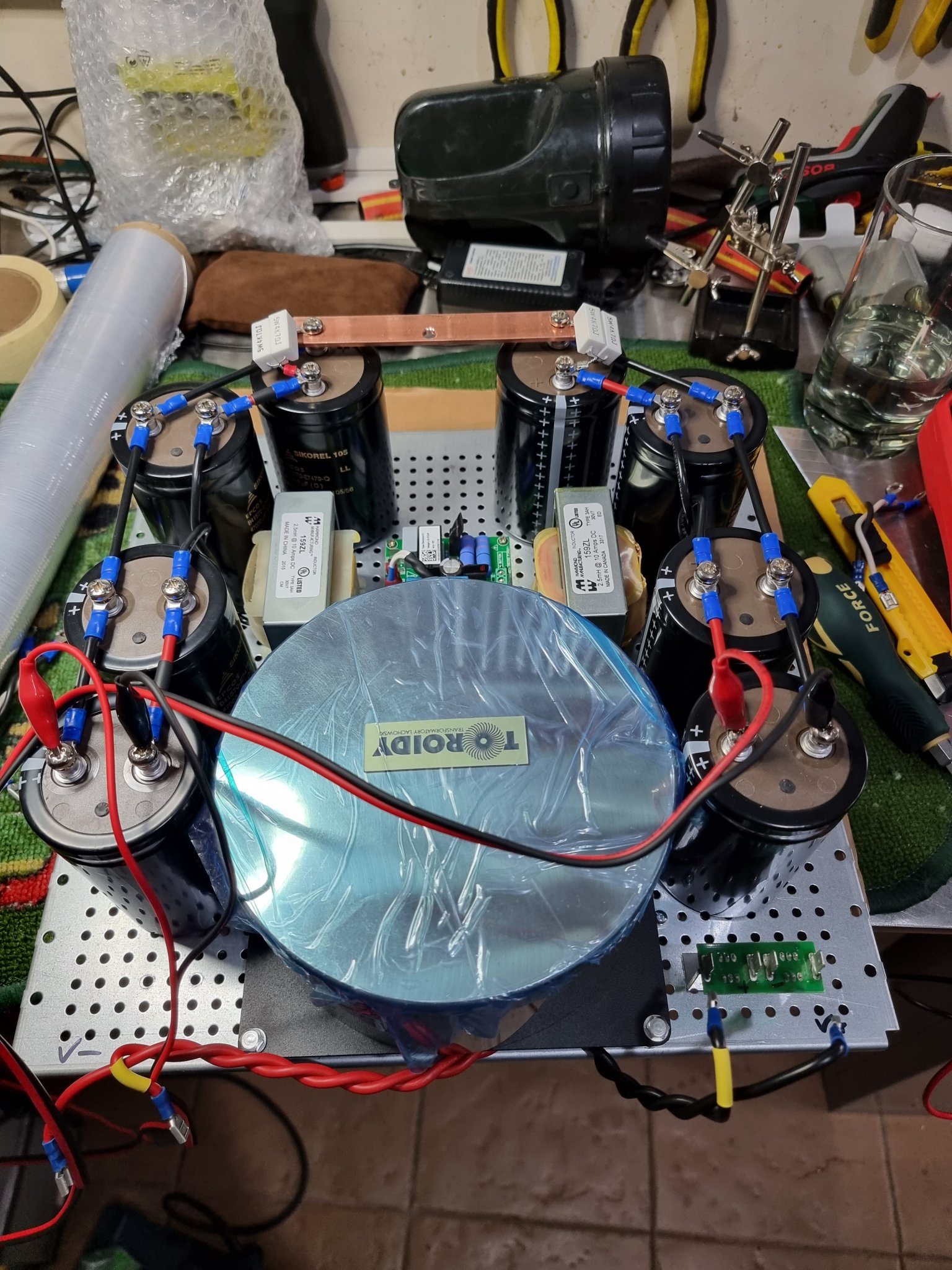

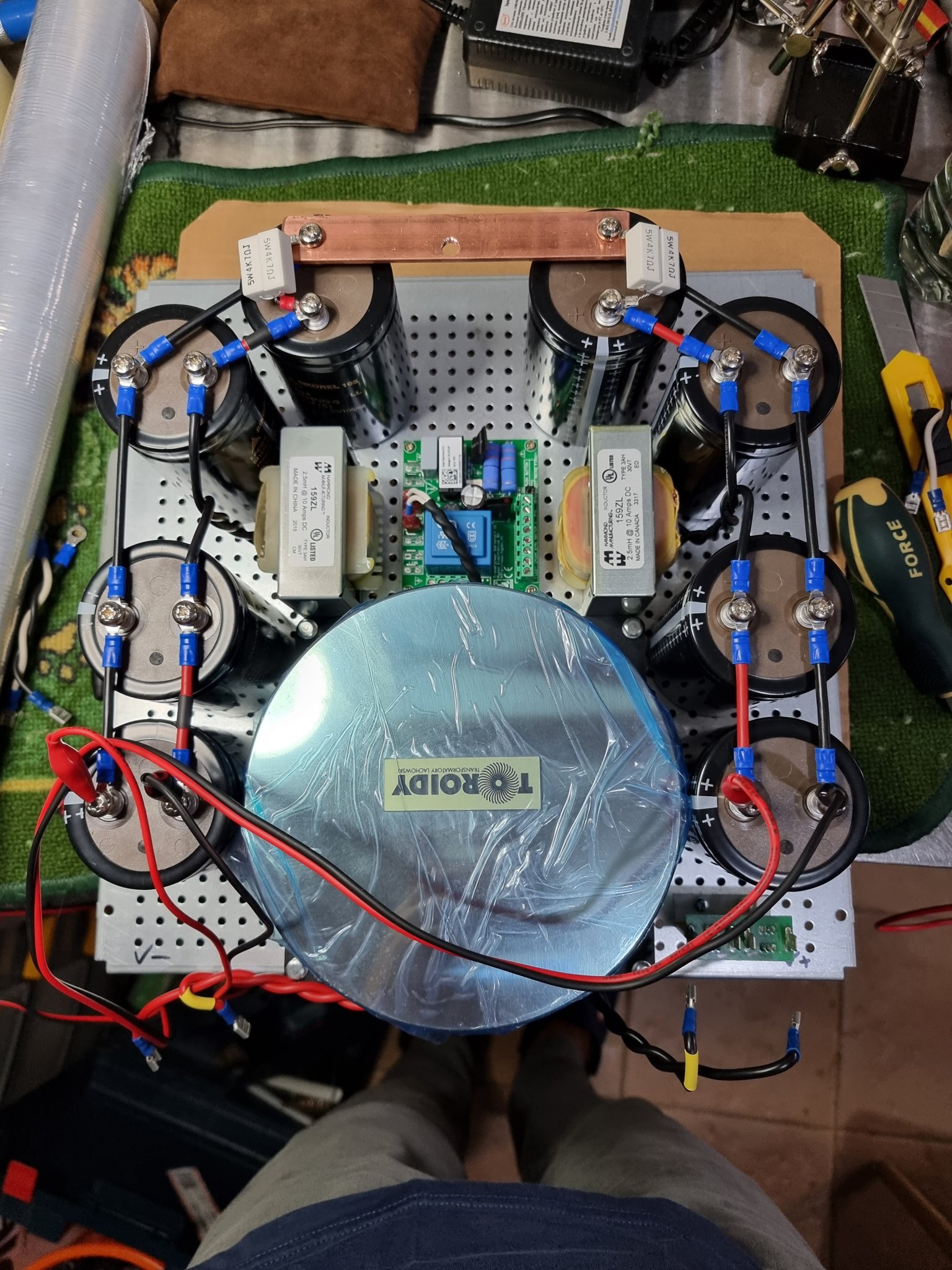

Hello to the DIYers!
I am somewhere closer to the final stage to complete the F5v3 balanced monoblocks.
I've pre-biased ams with a lab PS, then assembled the amp in a chassis and started it with a variac: after reaching 25% of the nominal voltage my bridge rectifier blew off: traces on the PCB exploded.
My PS is: 800VA 2*27V trafo, 8*47000 uF 40V Sikorel caps, pair of 159ZL 10A 2.5mH inductors.

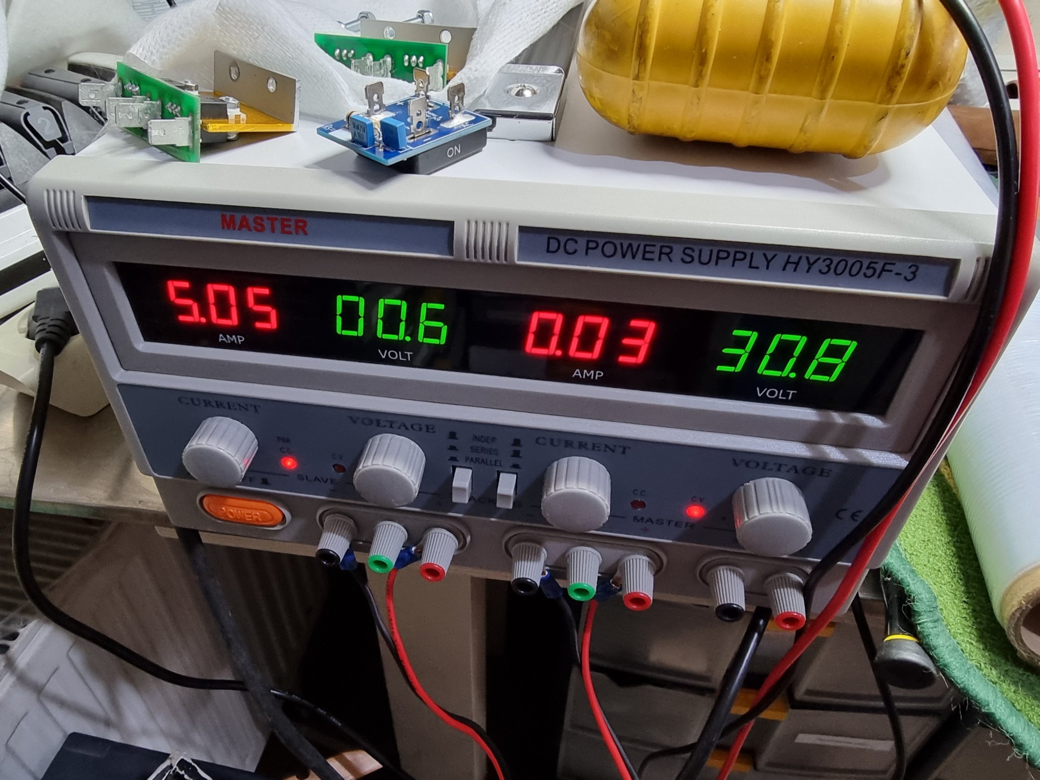

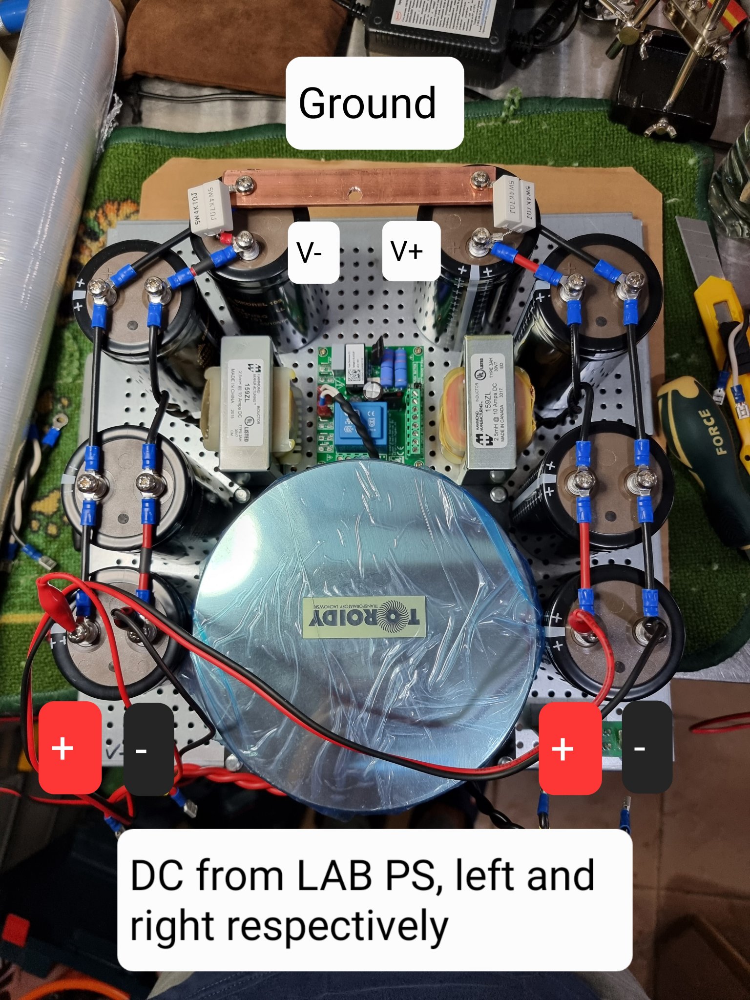

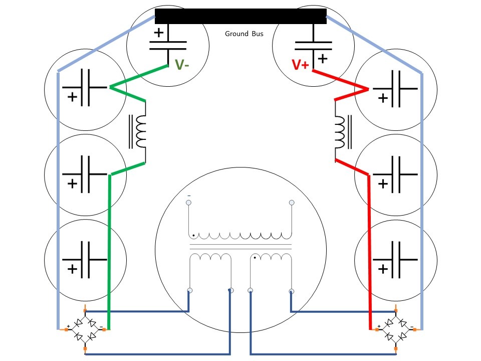

I decided to disassemble the entire amp and check the PS separately:
1. All the 8 caps are functioning properly, RLC meter shows correct capacitance, after applying 30VDC from the Lab PS all the caps charge well and discharge with bleeder.
2. Next I disconnected rectifiers and applied Lab PS to the positive and negative rails separately, without attaching the ground bus between rails: two separate rails were functioning OK.
3. After I installed the ground Bus between the rails and V+ rail charged properly while V- rail behaved like a short: 0V and max current of the lab PS (left channel on the picture).
4. Next I checked the other power supply (for the second monoblock) in the very same fashion and got the same result: positive rail is OK, negative behaves like a short.
I spent the entire night on it I can't find anything wrong in the wiring or individual components, thus asking for some community opinion on what could go wrong.
I have a lab PS, Variac and high quality multimeter with RLC to check any of the assumptions.
Thanks in advance!

also, beware: do not, ever, prebias using a lab PSU. Never. Too much a risk of errors (current limiters can kick in, you risk turning the pots way too high).
I suggest you start from scratch. You seem to have started with the end productf biasing up. This comes last.
connect IEC to tranny, power up with variac. All good? Connect to rectifiers x 2 (I see only one, maybe dual? Looks very small for that purpose).
power up and test rectifiers with variac.
connect to caps. Redo power up procedure.
all good?
then connect one channel of the amp, at ZERO bias (nulled pots, whatever).
power up using variac.
all good?
try to bias one chan to 80% of target.
all good?
connect other chan, repeat.
regards,
Andy
Hi Andy!
I can't get the power supply working, not the amplifier.
I deliberately disconnected the rectifiers before connecting the new ones to check that the rest of the circuit is OK, looks like it is not.
Tranny is OK, rectifiers (new ones) are OK, separate rails connected are OK, once I connect the ground Bus between caps I get a "short" behaviour on the V-.
