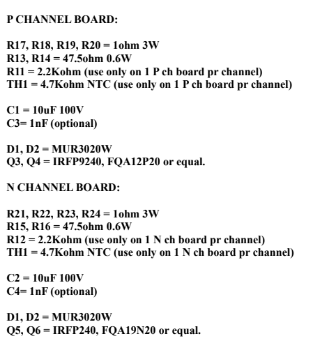

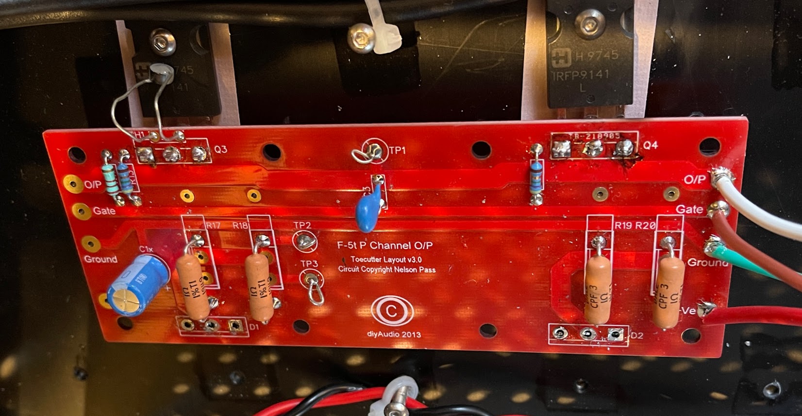

I've removed the MUR3020W diodes: D1,D2,D3,D4, each both sides, 8 total. In my case they are SDUR60P60WT. They look(ed) important.
@Dennis Hui 26volt rails

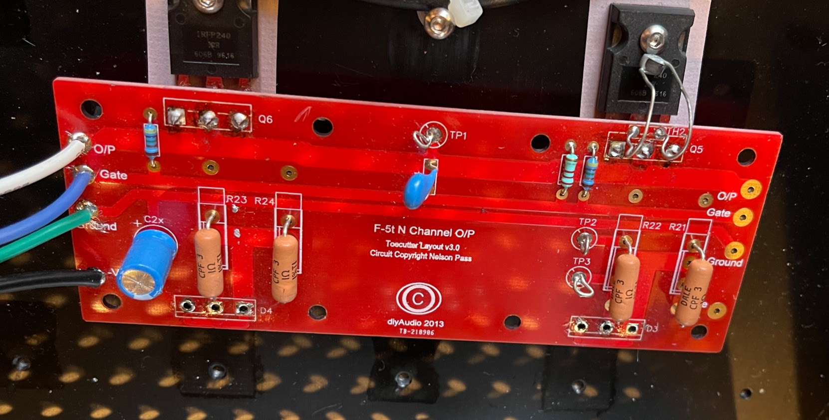

I ended up replacing all IRFP9240 (x2) P-channel, and IRFP240 (x2) N-channel MOSFETs on both sides, 8 total. Of the 8, 3 measured incorrectly, and I think were fried. I did not put an 8amp fuse in and set them on fire this time around.

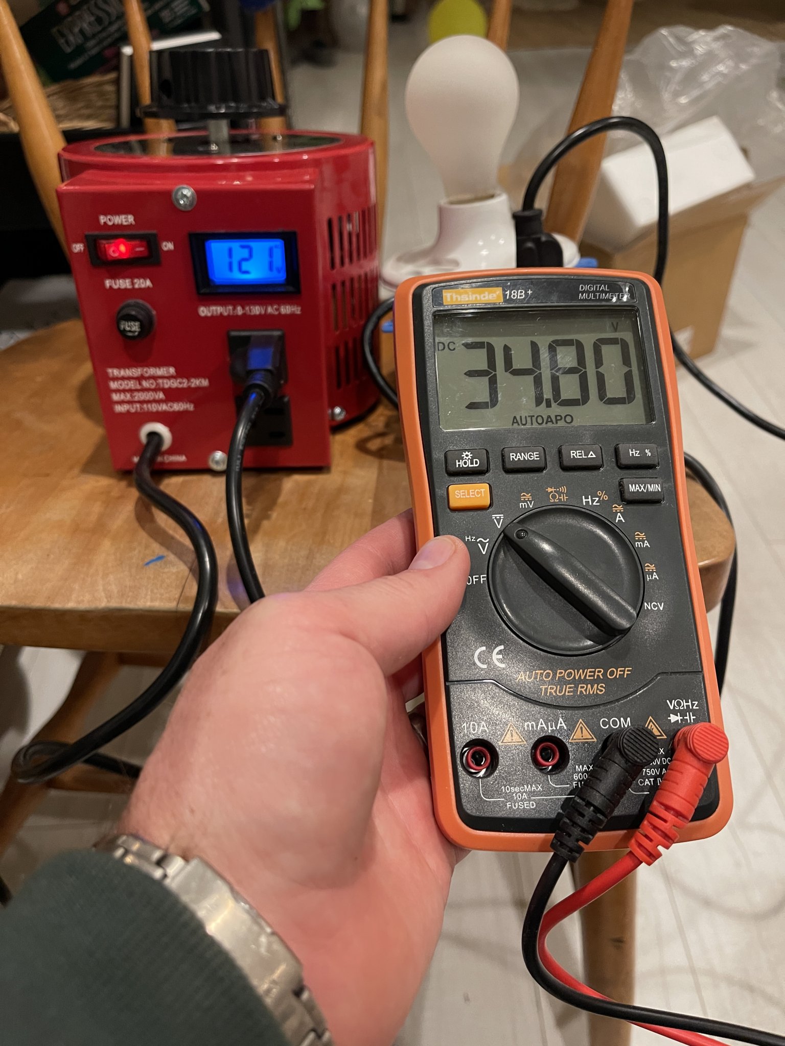

I discovered it was impossible to measure the MOSFETs in place; they had to be removed from the board to give reasonable measurements using digital multimeter in diode mode using these instructions.
Just wanted to make double sure I understood you guys right!
Side note: I'd tried to hunt down a hum earlier. I tried increasing the mains wires from 16awg to 12awg, and removed the green fluorescent AC switch from that line. Maybe that will make a difference.
I will slowly bring back up to 120v with dim-bulb and variac, and re-bias. Fingers crossed!

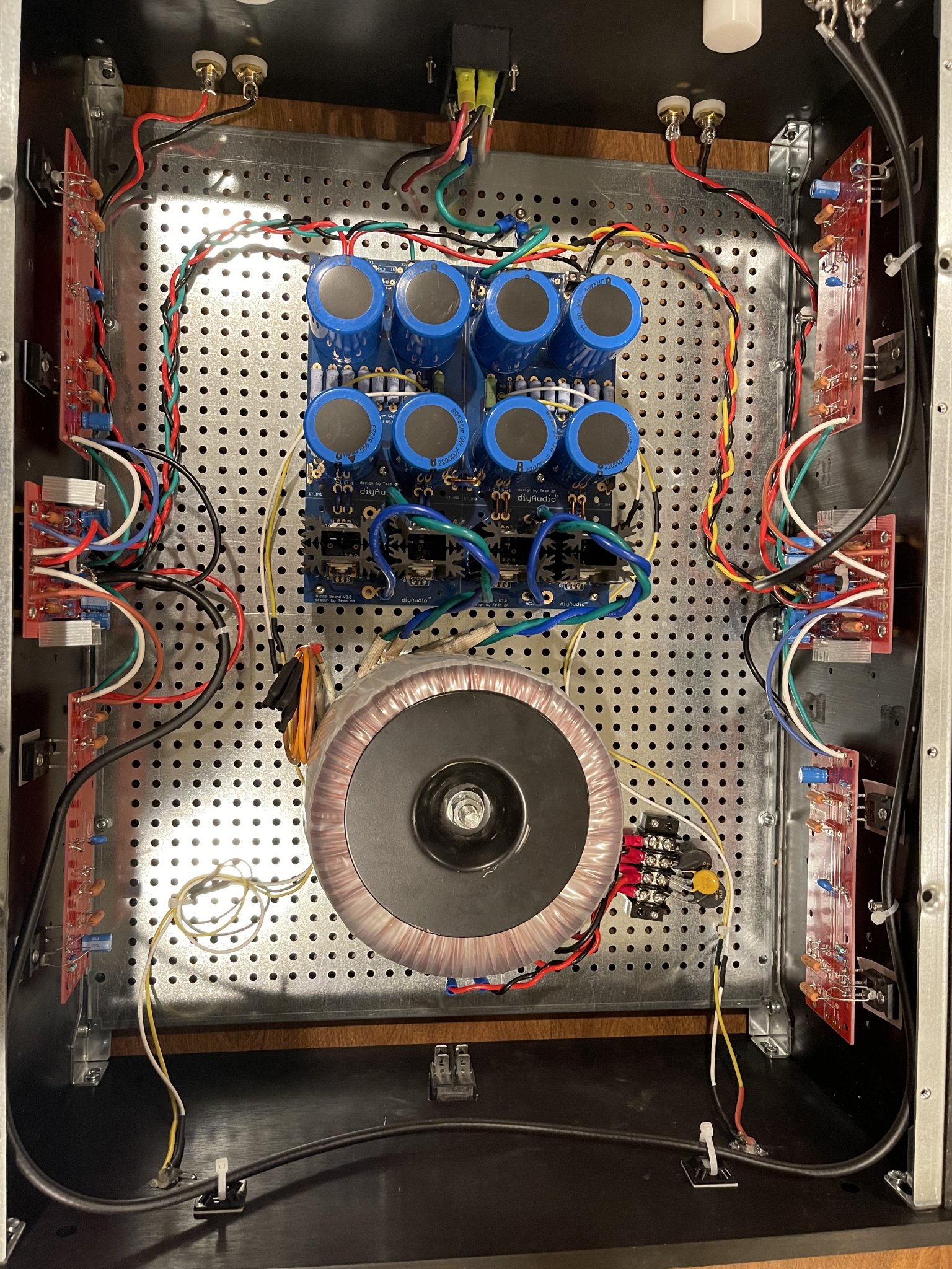

I had some washers under there before, but these little MOSFETs seem plenty strong for just this screw.

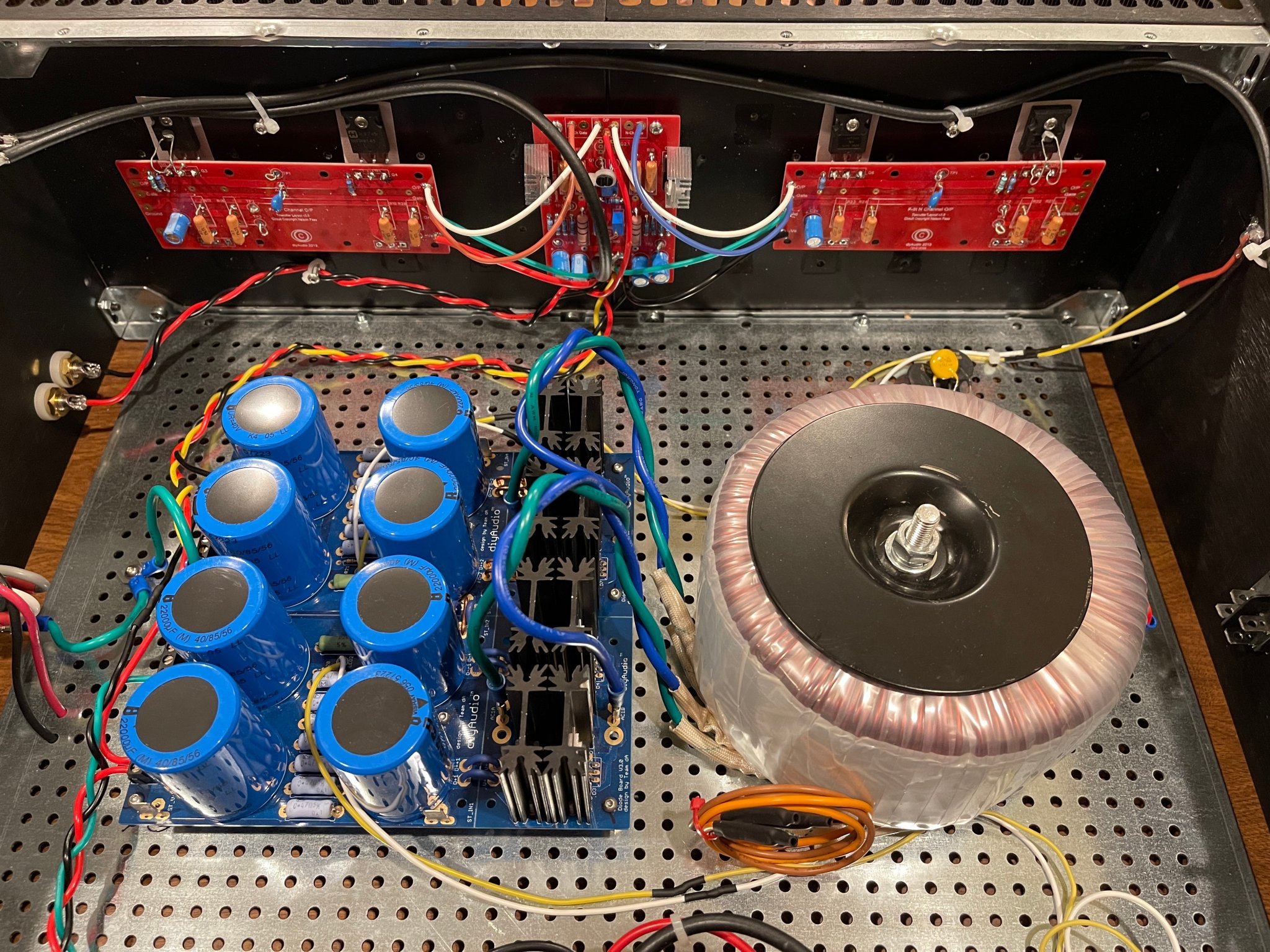

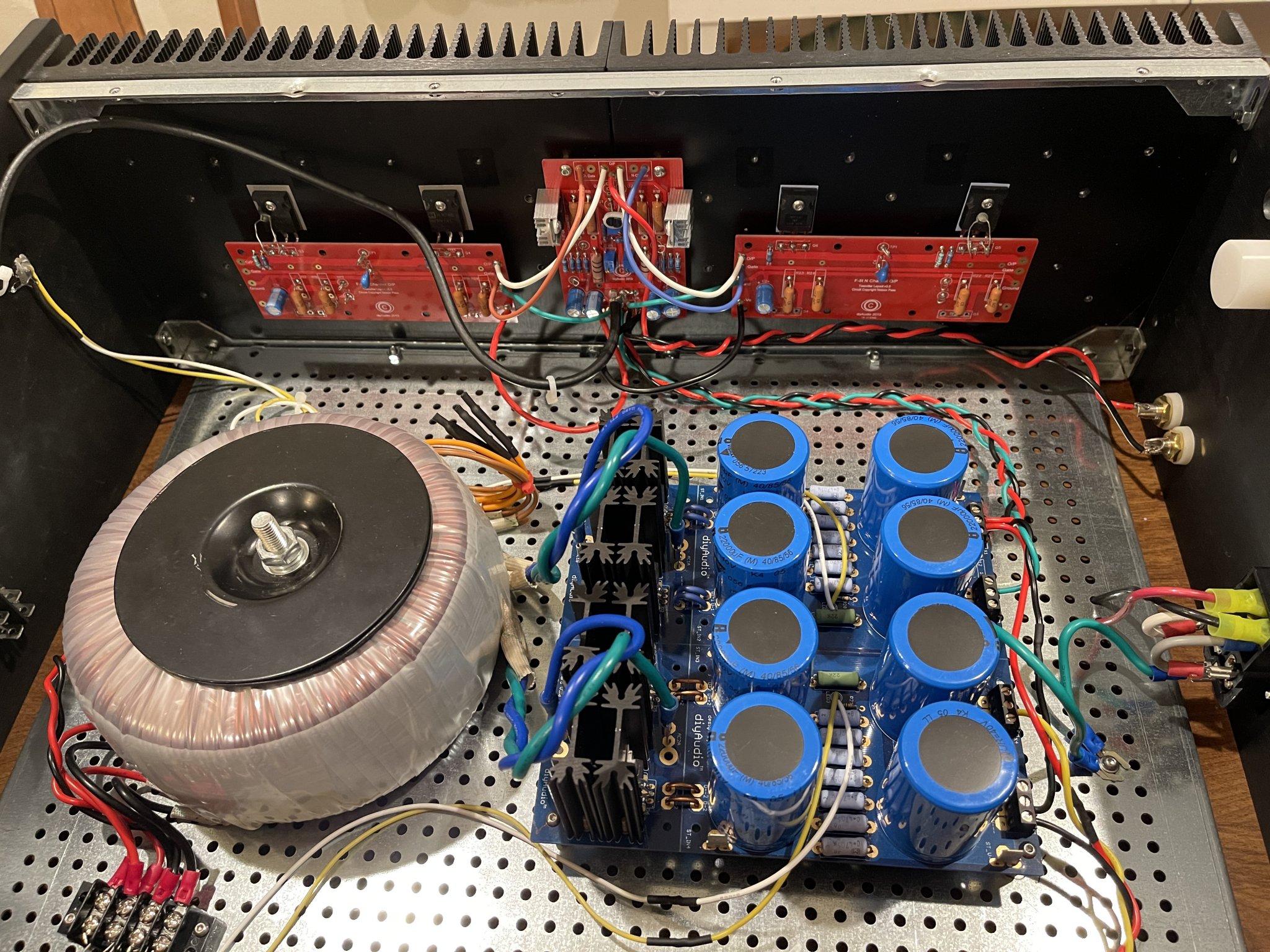

Here are some big pics of the build as it is at the moment.

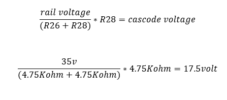

Above I said I was pushing 26 volt rails, nope! It's 35 volts. Not even a close guess. Now this has me going back to re-examine my cascode formula to make sure R26, and R28 are correct. Double checked, R26 and R28 are both 4.7kOhm.
So that works out to 17.5volts cascode voltage. I'll attach the big pics.

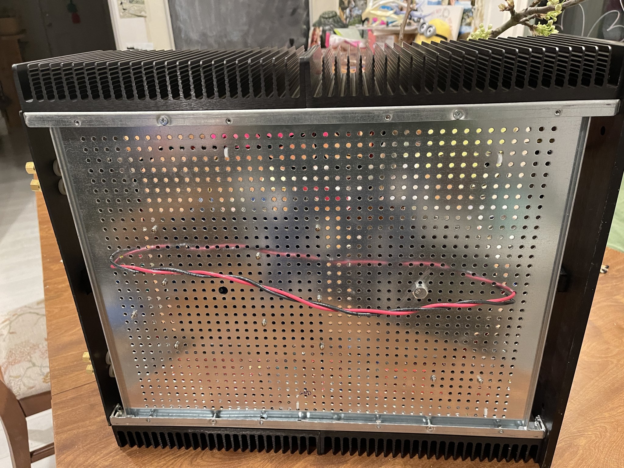

@Mdrewk
Do you have anyway to measure HS temps after an hour of running. They look on the small side to me. Also is it setting under that tight shelf in earlier pic? It needs some open air to breathe and cool properly. NP advice on temps by holding hands on HS are very close to accurate. If 60C or above you will not be able to hold your hands on for 10sec.
