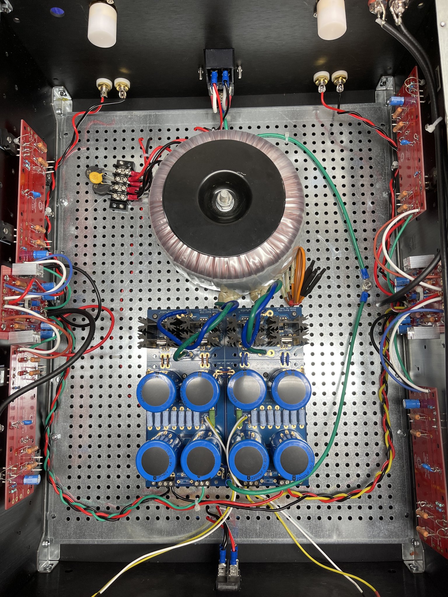

Hi all,

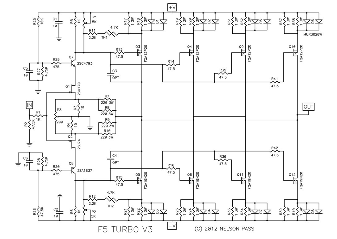

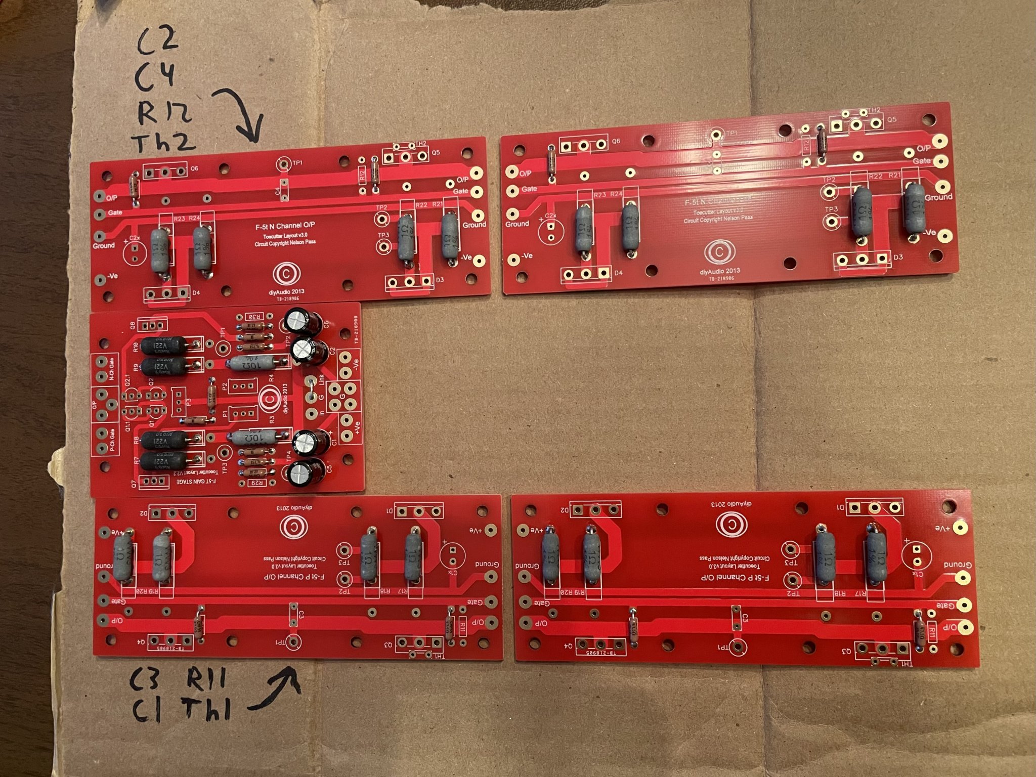

Quick question about pcb stuffing for V3 monoblocks. Following the circuit diagram C2, C4, R12 and TH2 (and P-channel corresponding parts) should only be installed to one of the output boards on each side, correct? Only reason that I ask is that I have seen monoblocks with C2/C4 installed on all output boards. I just assume the change in capacitance is insignificant.
See picture - from my understanding the second (right) output board on each side is complete (minus diodes/fets of course)
Cheers & enjoy the weekend!

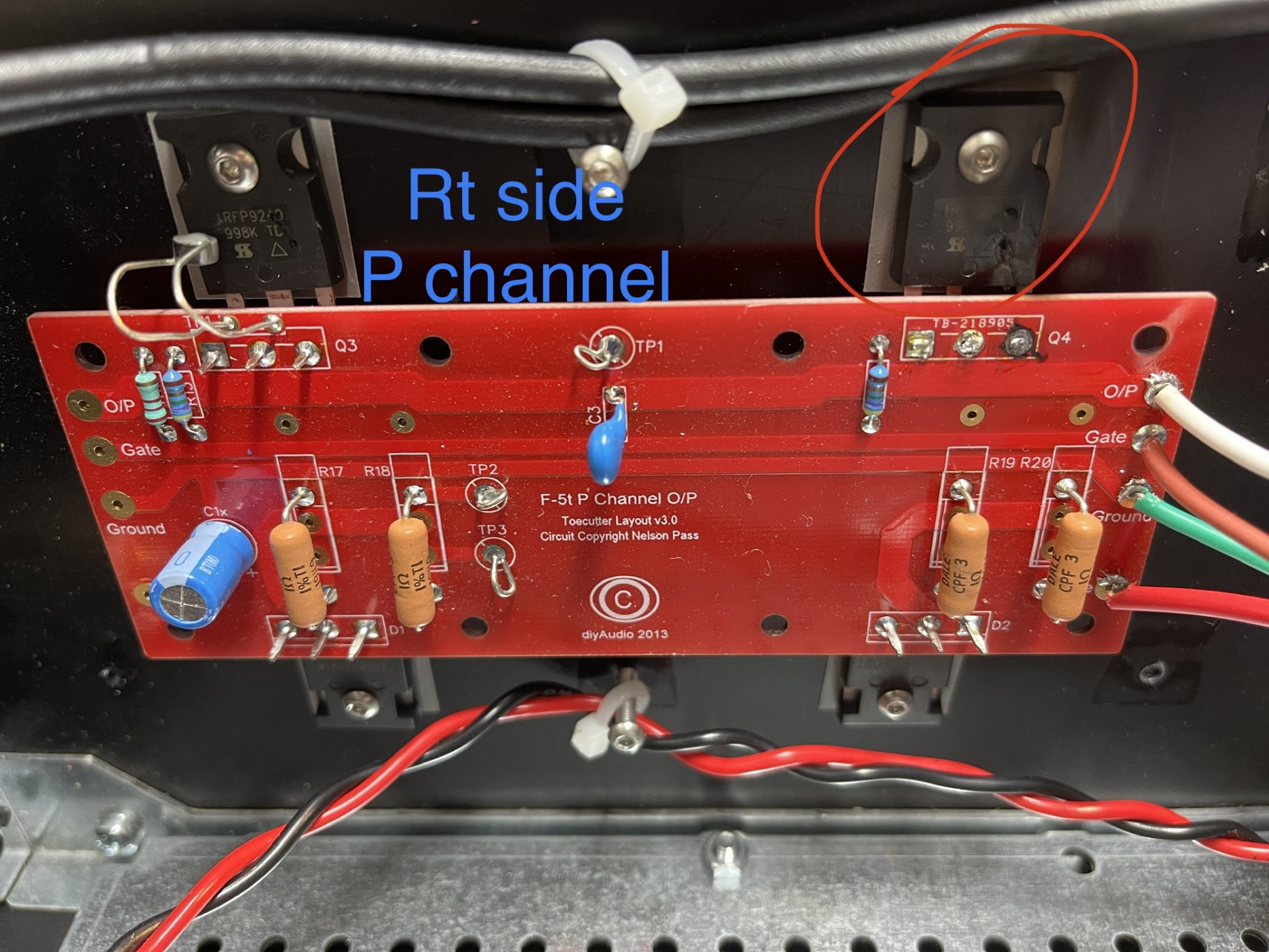

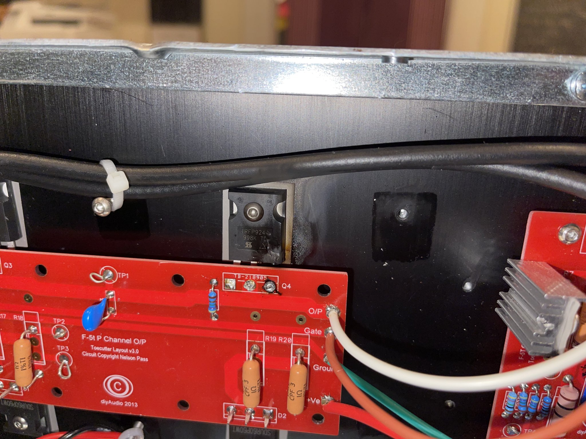

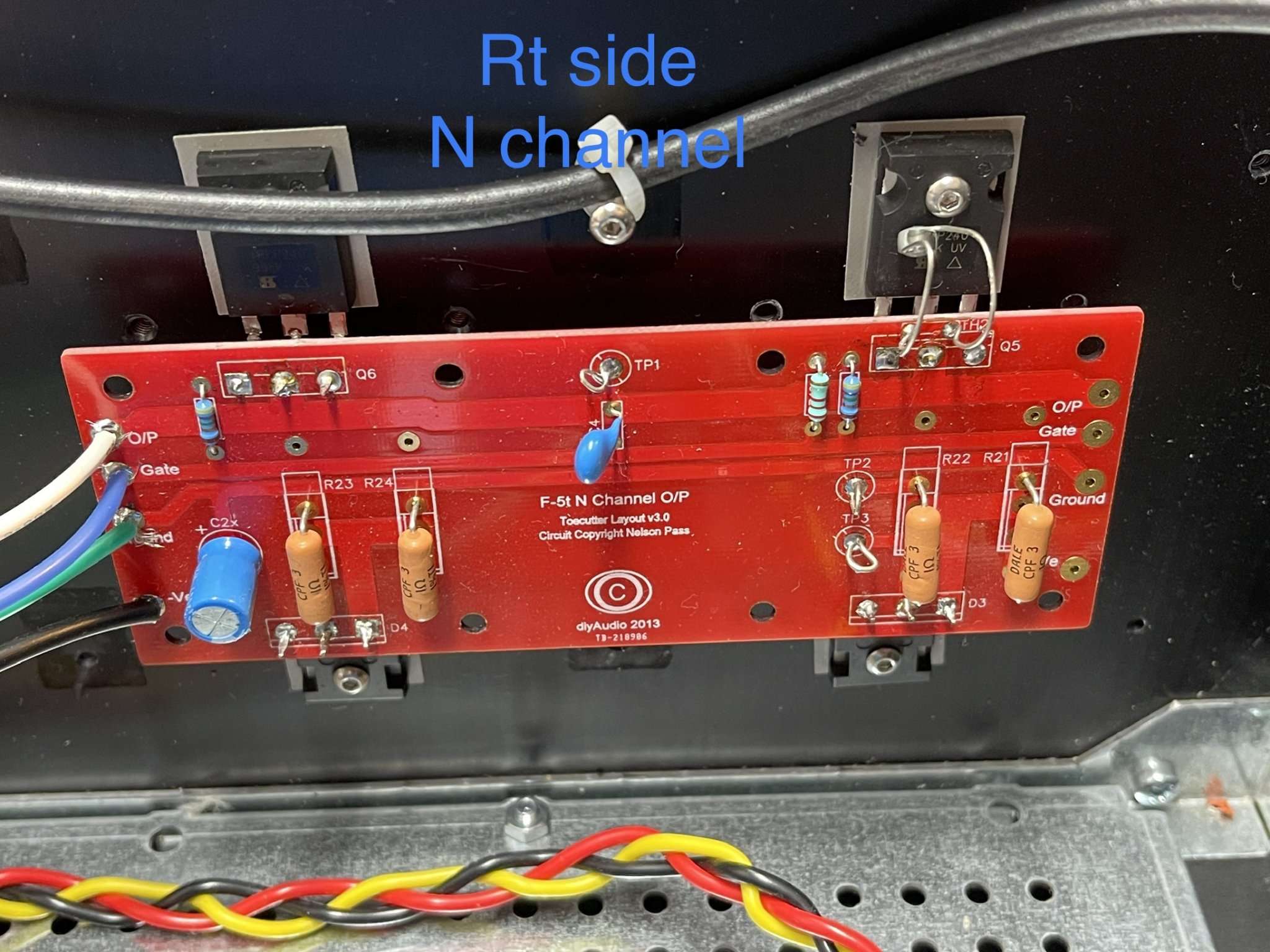

I managed to smoke and catch fire to one of the MOSFET IRFP 9240 shortly after New Years.
Too late, I noticed one of the speaker wires had come out of the binding post and touched the chassis. Not sure if that led to this failure.
I had cranked the amp up past where it should have been. It cut out, I immediately powered it off and swapped to a different amp (New Years eve in full swing!) yesterday I put in another fuse, it blew. I put in a larger fuse, and was greeted with smoke and fire out of one of the MOSFET.
Certainly that will have to be replaced. Anything else I should do here? Sim bulb tester, variac, go slow post results?

You let the smoke out. it’s super difficult getting it back in, so replacing the obvious stuff is in order, as you mention.. 🙂
Source resistor definitely gone unless you used the diode, in which case it'll be OK. Gate resistor and JFET on opposite side from the MOSFET need to be checked, ideally you need an entirely new half output stage. Good luck!

From what I can see you have the diodes in, so the source resistors are OK. You should replace the entire output stage, and use a brake resistor on the power supply rails (10 ohm, 1/2 watt), back the bias down to zero before powering up, and start moving the trimmers for a bias of about 100ma (50mV across the resistors). If all goes OK it means you can remove the brakes and bias it up properly.
If you have smoke from the brake resistors or unusual offset, it means the JFETs will need to be replaced.
I would also remove the diodes permanently. As has been mentioned, stability with the diodes is not guaranteed in all conditions, and temperature can have a funny impact on when the diodes conduct.

remove diodes Which diodes are you referring to? From the schematic, it looks like D1-4 are the MUR3020 and the only diodes on the board - though the Mouser page calls them rectifiers.

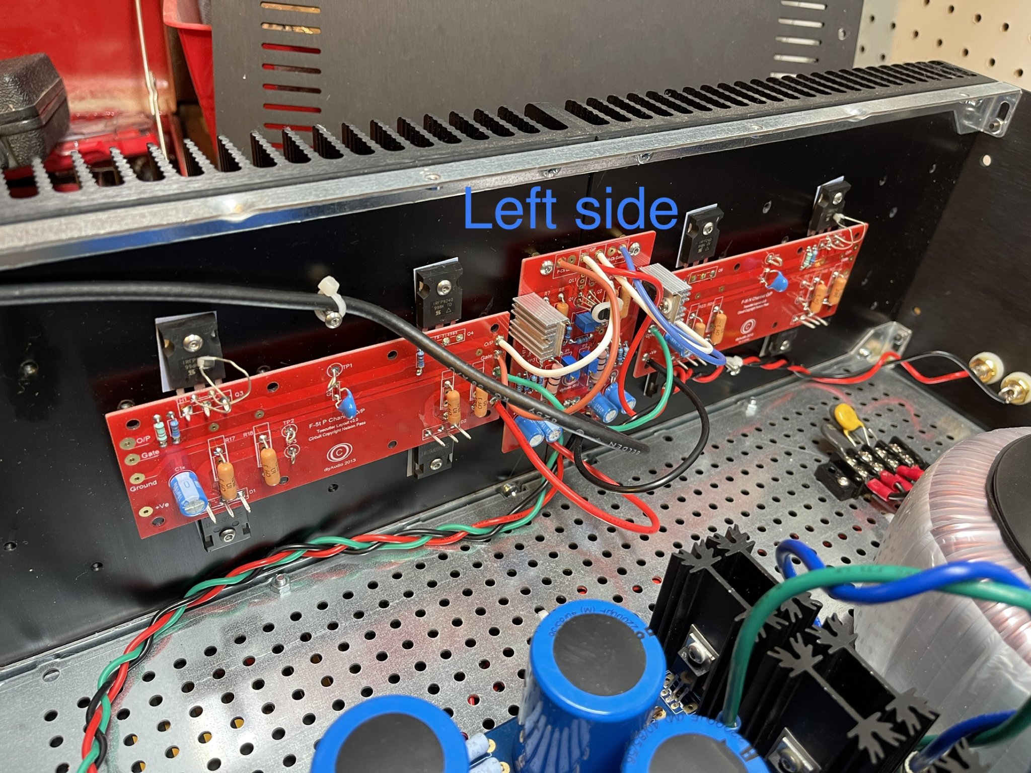

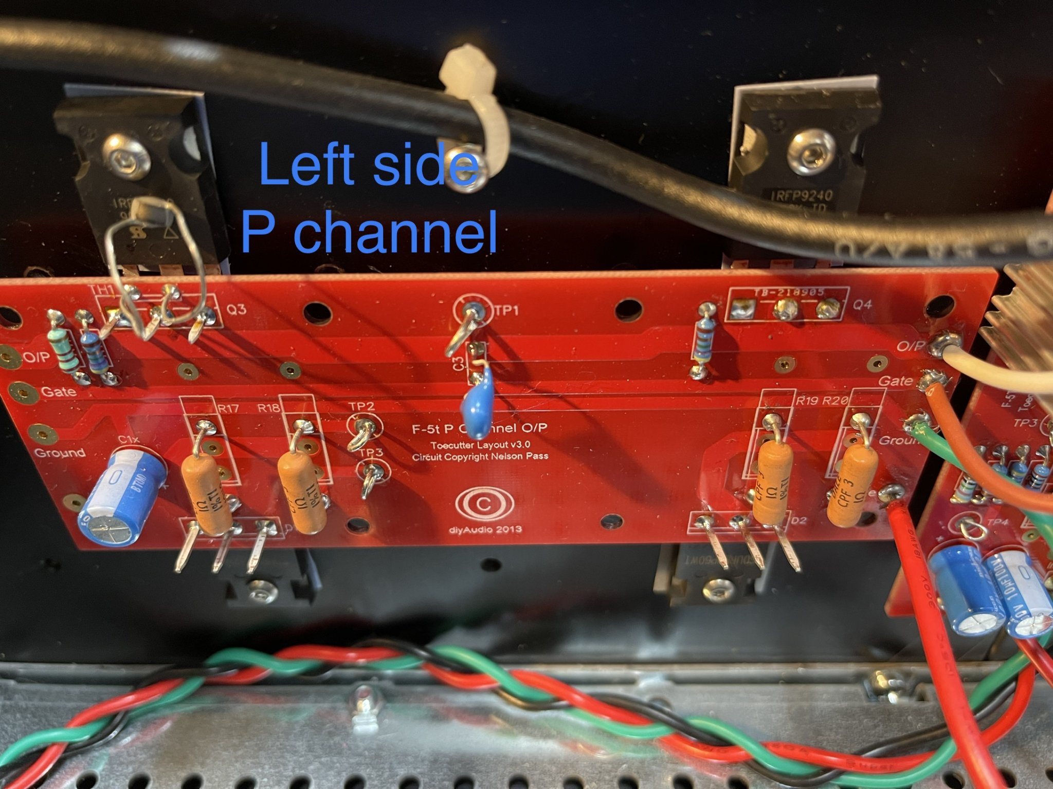

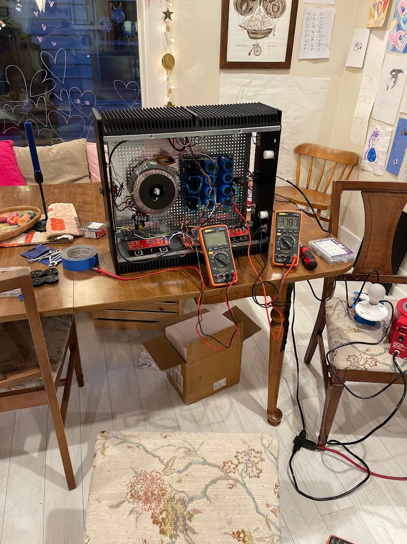

Got the stuff I'm going to start replacing things in the next day. I have a Variac, dim-bulb tester, and three digital multimeters for a slow power up, and the re-bias procedure.

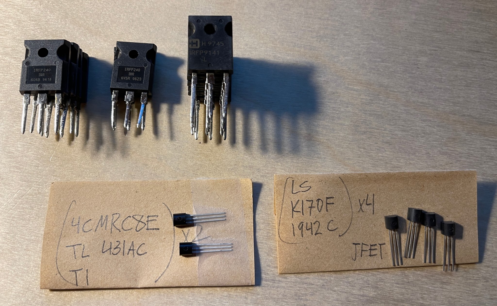

I will replace "Right side P Channel" Q3, Q4 = IRFP9240 with Harris IRFP9141
I got parts from the F4 Transistor Kit. From that page "The current batch of kits includes Harris IRFP9141 instead of the International Rectifier version. These have better distortion characteristics and are a sonic upgrade, but it should be noted they are rated for 100V."

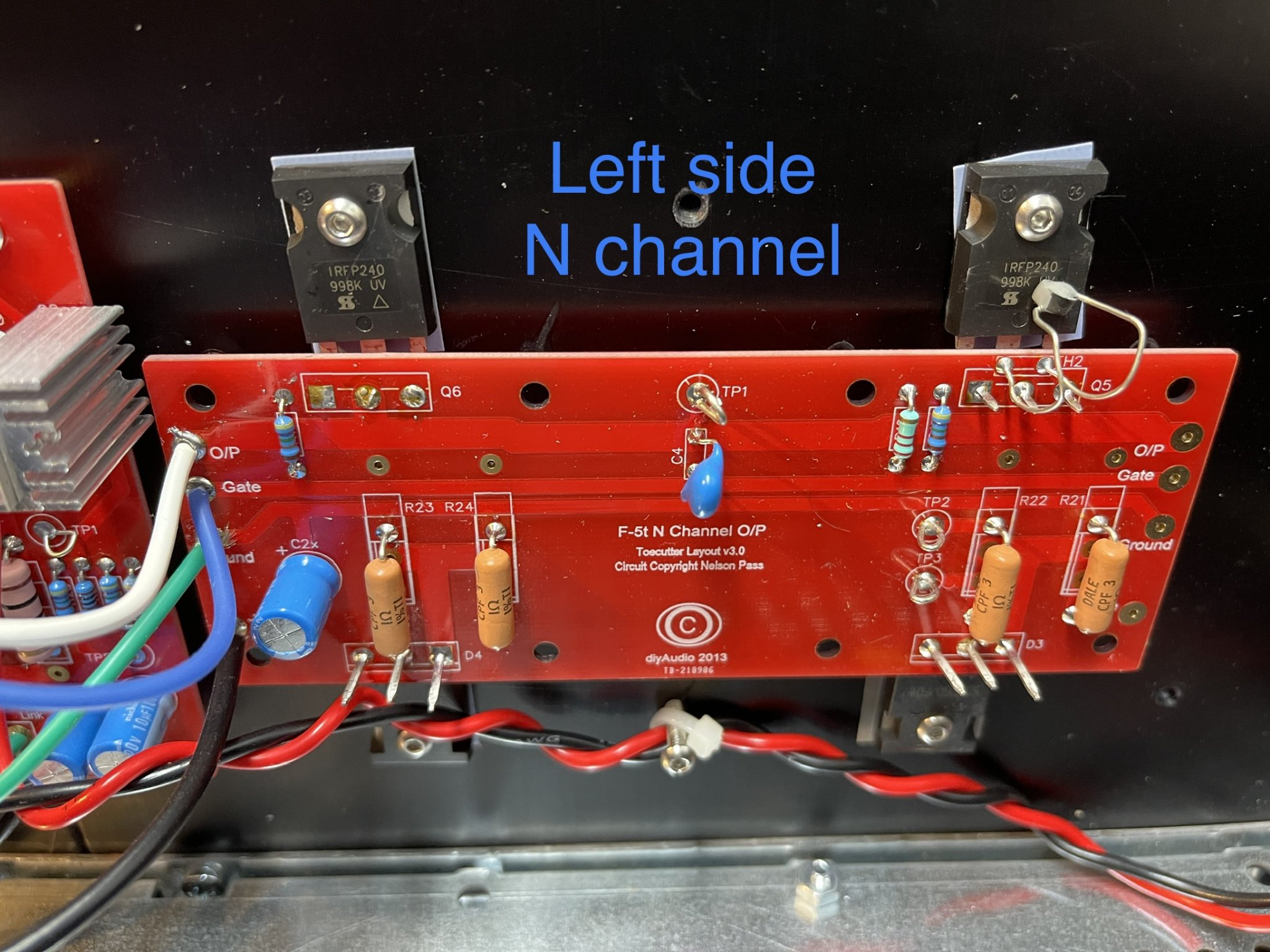

I will replace "Right side N Channel" Q5, Q6 = IRFP240, with IRFP240 from same F4 Transistor Kit above
Should I replace Q3, Q4, Q5, and Q6 on the Left Side of the amp as well?
I'm planning on checking other components vs the other side of the amp to see if there are any differences that would trigger replacing that too.

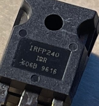

From the MOSFETs I got in the kit, four of the the IRFP240 are identical, and two are slightly different. All six say "IRFP240" and have the I<symbol>R, but the third line differs. Four say "606B 9616" and two say "6V5R 9623". Perhaps that's not important?
I'm planning on swapping the PSU and transformer front to back so it looks more like all the others around here! I had some hum previously that would be great if it was gone.

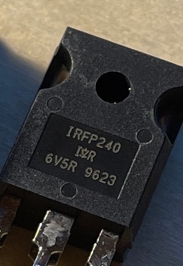

Hello Mrdrewk,
what you read on the MosFets (606B 9616) is a production code / date. So your IRFP240 are from two different batches.
Don't worry - the diyAudio-shop matches them really well.

I'm super happy to report that I replaced the MOSFETs as I described above, and it all worked swimmingly. I revisited the biasing procedure that 6L6 posted via chuckd and it powered up nicely. The Harris MOSFETs were a little more finicky than the other side with the original ones I'd used:
original: 0.352V, 0.352V, 0.002V offset
Harris: 0.357V, 0.333V, 0.000V offset
But the procedure said anything less than 50mV with 0 offset, good to go, so: good to go!
Super happy. Here's last nights session in all it's glory.
