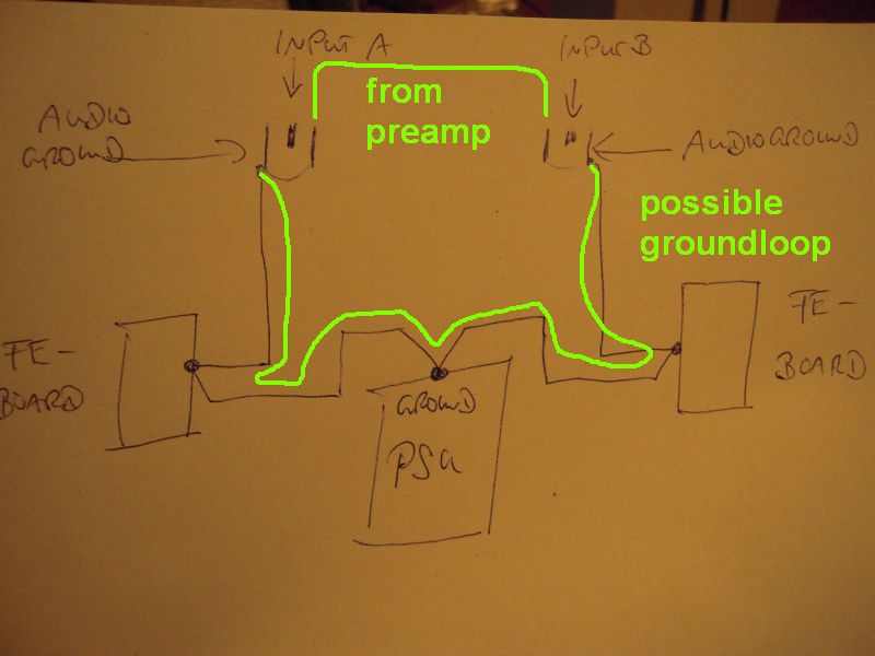

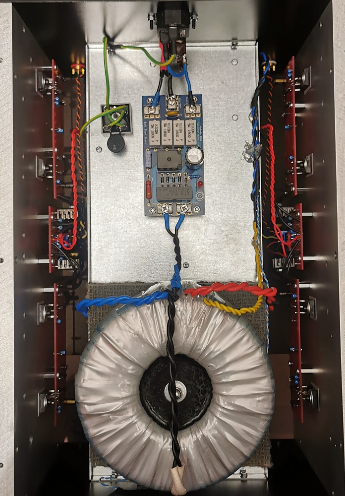

Hi, i have hum problem with my F5T. It's not very loud, but it can be noticed from listening position.
For now i tried to lift the safety ground but with no improvement. If i short the input it is almost dead quiet.
Any idea where to start?

Hello a007udio,
do you have the possibility to change your preamp or the source?
Only to be sure, that the hum isn't induced by a stage before the F5T.🙄
Your F5T-build looks very good!
The AC-lines are well twisted but running directly over the toroid. This
could be a scenario that you get problems/ hum there?
I assume it is 50 Hz-hum?

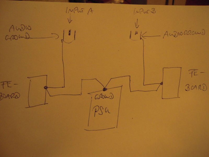

Possible groundloop over the RCA - input A - to the frontendboards - to RCA-input B? I think about that, because if you short the inputs it is dead quiet?
Only some thoughts....
Cheers
Dirk 😀

Hi Dirk, yes i tried to change the source but it makes no difference.
Today i tried to short just left channel and there was no hum on the right with music playing. It is also ok if i short right channel and play on left.

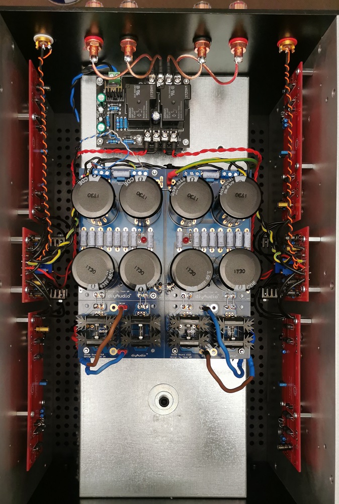

Let’s try a starground.
Connect all your grounds here.
Both channels PSU GND to the amplifier PCBs.
Both RCA grounds. (Yes, really.)
Both speaker black. (In the time being, you’ll have to bypass the speaker protection, attach the speaker output directly from amplifier boards to the binding posts). EDIT: looking more at your boards, I don’t think you have to disable the speaker protection… just attach the protection input blacks to the PSU as directed.
Keep the safety earth where it is.
Wow, for now i connect only both PSU GND together and left channel is quiet now. i still have some hum in the right channel but it is much better.
Before there was some quiet mechanical noise from PSU board which now is gone 🙂
Thank you.
Thank you.
