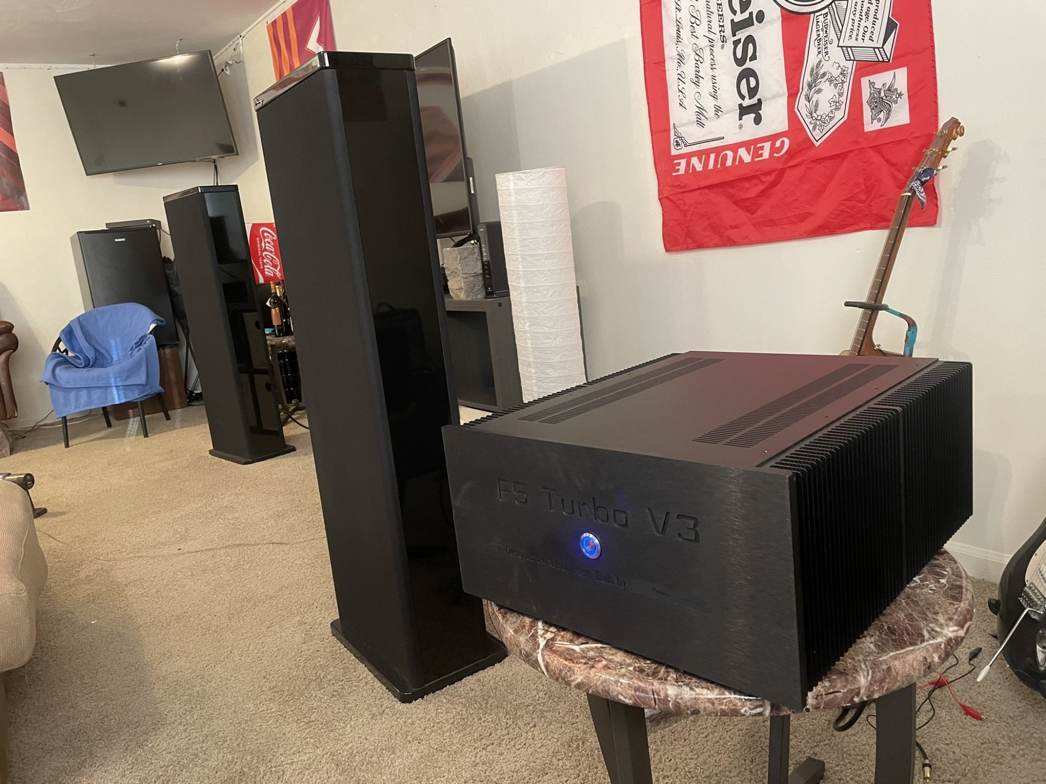

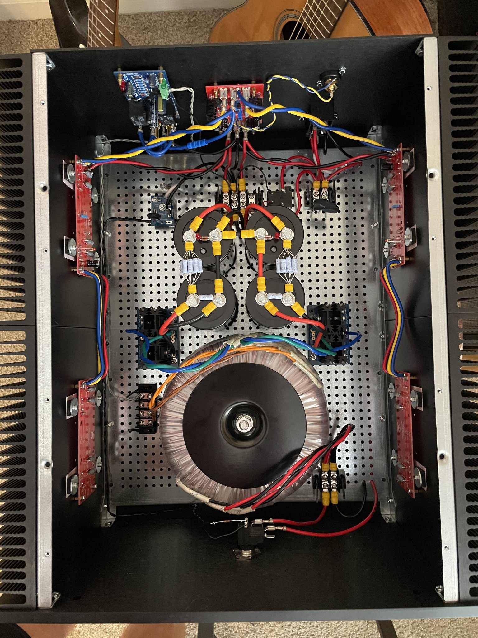

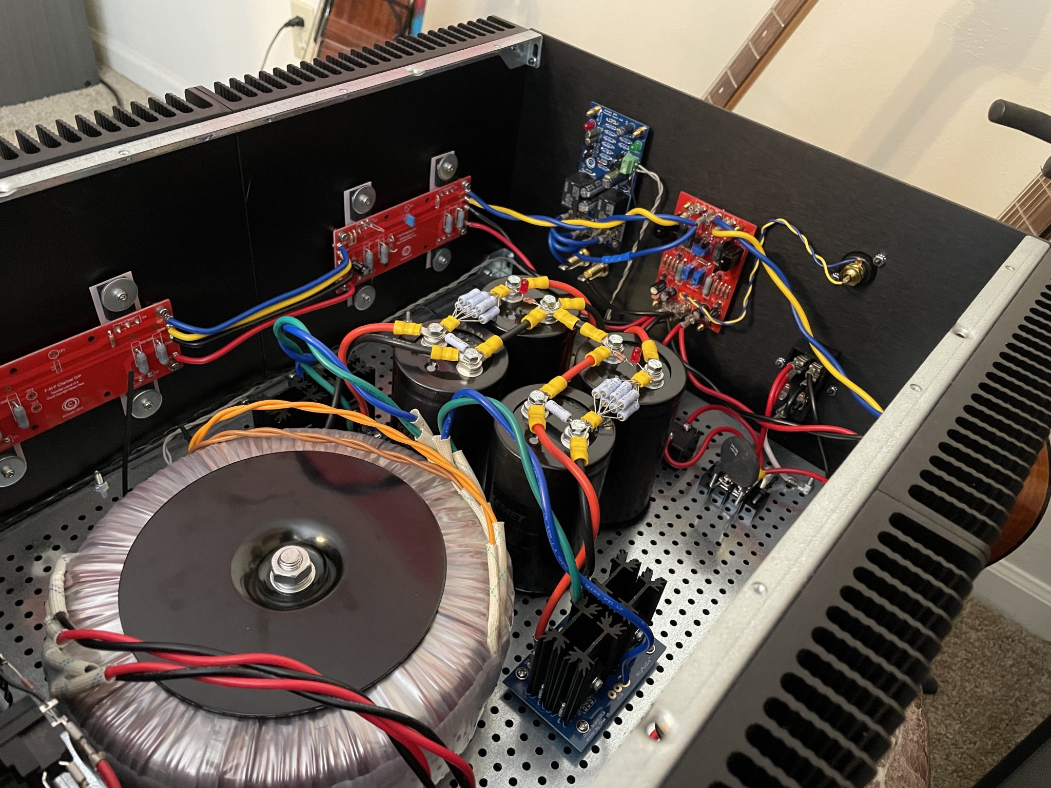

It plays music! Thanks to Nelson Pass for offering the design and everyone that’s helped answer questions along the way. Now to build the second one…
