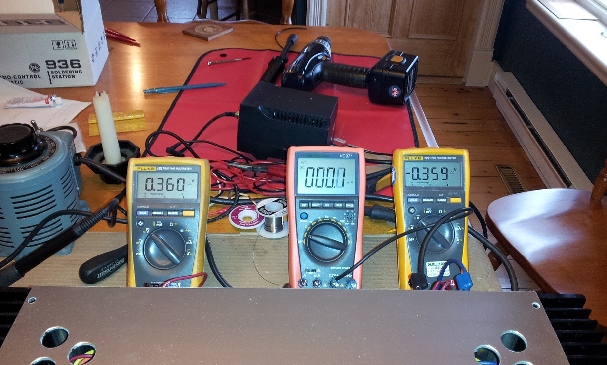

Finally had time to finish my V2 today. I went from CLC to CRC without trying CLC. It is not the good time to mess with experiences with my first amp project, I went with a known path for the PSU. I also cascoded the jfets.
I'm trying to bias tonight. Everything looks good, no smoke, the heatsinks are warm. My issue is that I can't get the bias over 275 mV. I maxed out P1... Is it because I could have low Idss jfets? I don't know their value. Does the remedy is to increase the value of source resistors of jfets? If yes, which value? I have 1 kohm right now. I would like to go at least with a 350 mV bias.

hehehe 🙂 2.2k resistors did the job. I still have room to bias higher. Heatsink are only at 40°C and mosfets at 50°C

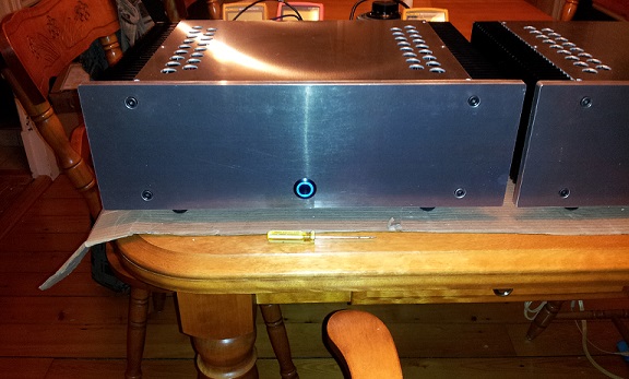

I used the following switch in conjonction with the soft start circuit from DIY Audio store. You need a 24V switch. This was a direct fit. I wired the LED of the switch directly on the spot for the LED on the soft start circuit.

Thanks, Walter, that's what I needed to know. I don't think there's a published schematic on this circuit yet. Once I can see it it should help me understand the connection(s). The 24v part spec was something I didn't know so thanks for that.
Your build looks great, dig that switch.

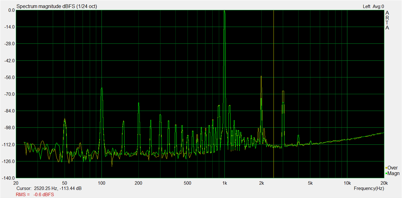

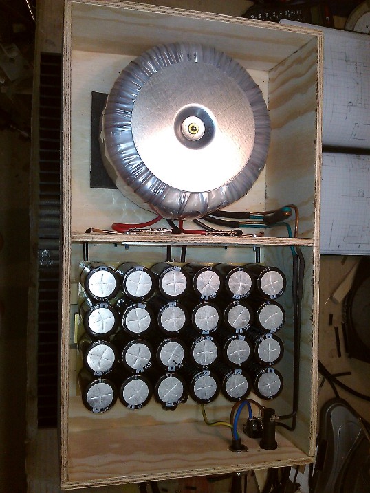

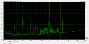

F5V3 Turbo Monoblock is working
Many thanks to this forum and Nelson Pass.
I have done some measurement:
5,3Vrms in 4,1 ohm at 2,6A bias
orange: P3 optimised to minimum D4
green: P3 optimised to minimum D2
I am concerned about the PSU-Noise 50Hz, 100Hz and its harmonics.
On real speakers the PSU noise measured with my one ears is same as with my aleph X. BUT the aleph X has additional HF-noise. Both is not audible at the listing sosition, only about 10cm ears to speaker.
Trafo is 800VA 2x35V; 60mF-180mOhm-60mF; Rail is 46V at 2,16A bias
Any comments regarding the PSU-noise?

.........Any comments regarding the PSU-noise?
What does it measure?
Use a DMM to check the output DC offset using the 199.9mVdc and the output AC noise, using the 199.9mVac.
>1.0mVac = terrible.
<0.1mVac = very good.
Excellent is below the resolution of a 199.9mVac DVM.
What is unusual is the higher even harmonics of the mains frequency.
Usually 3rd dominates and the other odd are just higher than the adjacent even.
I wonder if this points to a particular wiring error?
Yesterday, I reached a bias of 0.450 V across the two 1 ohm resistors so 0.9A/device. I still have room to go higher but I need to get 5A fuses before. I have now 4A fuses installed and I'm near the limit of them. I will start testing with speakers and music with the actual bias.
