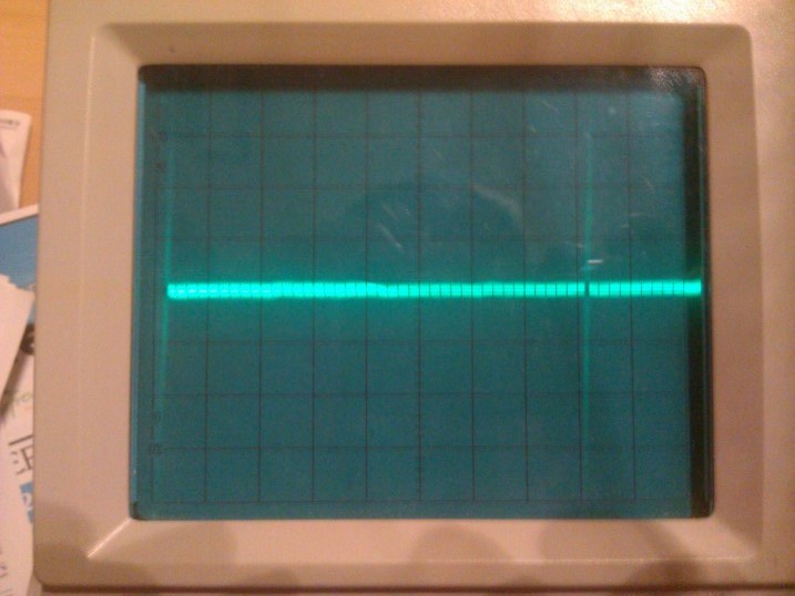

Input shortened, 1h warmup, 2A Bias, DC offset readjusted to <5mV.
DC Offset is dancing from +5mV to -5mV on DMM.
0,1V/Div;5ms/Div
10mV/Div;5ms/Div
Immediatly after PSU switch off
10mV/Div;5ms/Div

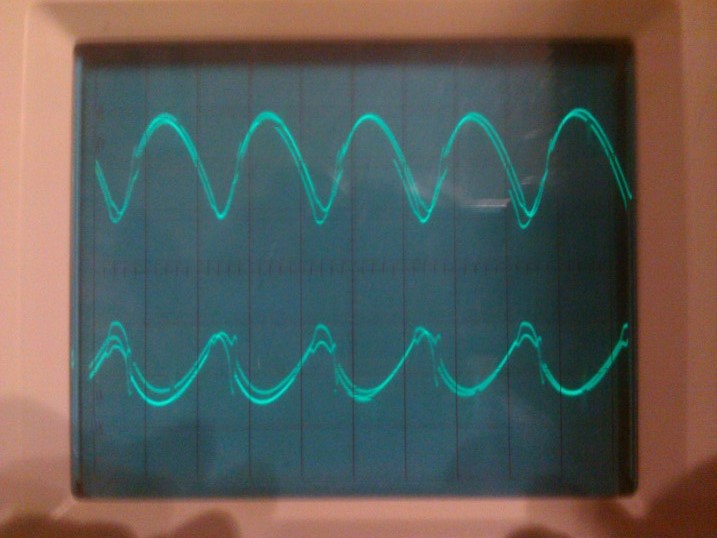

Upper trace positive rail to GND
Lower trace negative rail to GND
20mV/Div;5ms/Div
The traces are dancing, thats why you see parallel traces on the last pic.

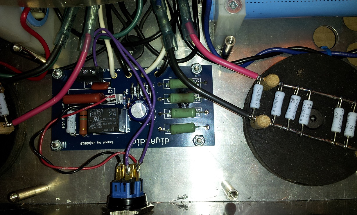

I got a problem tonight with one of the sofstart circuit. I smoked a resistor. 😀 I think the culprit is the relay. It did not click when I powered the amplifier so all the power was passing through the resistors bank for all the time it was on until the smoke came out.
The good news is I biased at 1.0A per mosfet and played music on a test rig. Everything is fine. Both monoblock are silent on powering up and powering down. No ground loop either.
Just a thought... Check the value of C9. The relay will not operate if the value is too low. Specifically, I used 1uF (120v) vice the .33uF (for 220v) for C9. If the relay does not operate you will always have current passing through the parallel resistors and they will get pretty hot. If that were the case you would also never get the full rail voltage your toroidal is capable of so once fixed your bias voltage would be more than previously measured.
I'm also using 1uF for C9. I knew the relay was not always working. It never operated with AC line below 120V. It operated when I biased but did not hear it when I tested the amp with music. But thanks, I will check the value of C9 when I will do the repair to be sure.
You need to check the operation of your transformer and any or all control gear BEFORE you connect the PSU.Just a thought... Check the value of C9. The relay will not operate if the value is too low. Specifically, I used 1uF (120v) vice the .33uF (for 220v) for C9. If the relay does not operate you will always have current passing through the parallel resistors and they will get pretty hot. If that were the case you would also never get the full rail voltage your toroidal is capable of so once fixed your bias voltage would be more than previously measured.
Then you need to check the operation of the transformer and control gear and PSU BEFORE you connect a load.

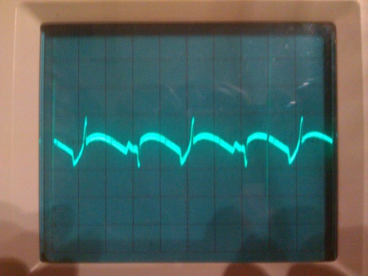

PSU ripple
There was a bad soldering on a bridge diode.
Now the ripple noise on the amp output is more Sinus like, but still about 3.5mVac.
Ripple on rails is 20mVac, and the switching noise of the diodes is still visible on the scope.

>1.0mVac = terrible.
<0.1mVac = very good.

it still looks like you have a wiring errorThere was a bad soldering on a bridge diode.
looks like you need to add a snubber (R+C) across the bridge rectifier.and the switching noise of the diodes is still visible on the scope.
