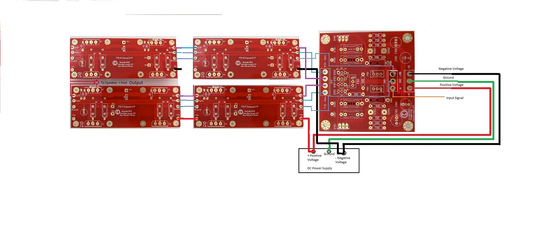

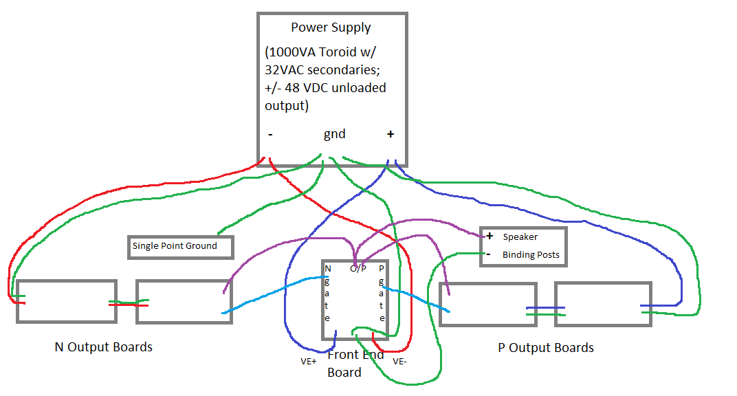

So signal comes into the front end board, (don't forget the "link", G to Link that is???), goes out through the "gate"conns, to the P channel/N channel boards respectively, in daisy chain, then comes back to the front end board and then to speaker binding posts? Should there be a purple line for the O/P joining the two P-channel and N-channels in your drawing?
Use the extra PCB for some kind of preamp...
The Output boards just daisy-chain together, the connections are clearly marked.
That's the Cyan lines - because the O/P is different from the N gates and P gates.
Agree - there should be cyan lines between the two output boards, so the second set of output fets.
Cyan is for gates...so on either side say the P-channel for example, the two p-channel boards are connected +Ve to +Ve, ground to ground and gate to gate but NOT O/P to O/P---no purple lines between two identical boards...?

petefrontiers: yes, this is what I "figured" it would be, but my "figuring" has been amiss before.
In your picture the top row of boards would be N-channel (they look like they are all P-channel) and you have pictured one side (say the left side/channel) correct? Mirror this on the other side?

jdg123;3794361In your picture the top row of boards would be N-channel (they look like they are all P-channel) and you have pictured one side (say the left side/channel) correct? Mirror this on the other side? [/QUOTE said:On the picture, it seems everything is ok. The N channels are on the top row and connected to the output N channel of the front end board. I guess yes, you do the samething (mirror) for the right channel.

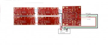

@ jdg123 Here is a diagram that I found even on this thread for what you want to do.

Lo_Tse, at the far left side of the picture petefronteres sent are thin red lines indicating the connection to the speaker terminal 🙂
I had to download the file and enlarge it a bunch on my computer to see everything (sorry petefronteres, about my false ID of the upper row
) but if you do the same: download and enlargement you'll see more detail 😛
I'm pretty sure the Ground next to the IN on the front end board is supposed to connect to the "link" and that either the "link" or the ground then can act at the ground for the incoming signal...but I like to have a confirmation on that just like you 😱 I have made too many mistakes based on assumption
I had to download the file and enlarge it a bunch on my computer to see everything (sorry petefronteres, about my false ID of the upper row) but if you do the same: download and enlargement you'll see more detail 😛

Thanks! Yeah, I save the picture already. May need to use a magnifying glass to trace the links on the board 😛
