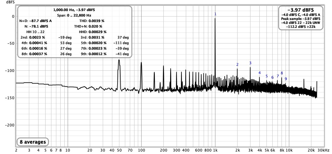

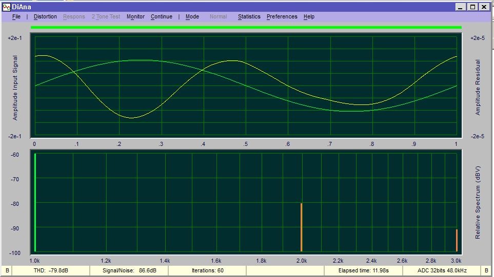

Today, despite wonderful weather I adjusted my revisited F5 with Toshibas SK and SJ first time with the P3 pot.
Wonderful I got H2 neg phase, H2 pos phase and H2 minimum compared to H3.
Astonishing how small the turn for P3 is to get the different H2 peaks! And there was no need for me to readjust the offset, because it changed only in a very small amount.

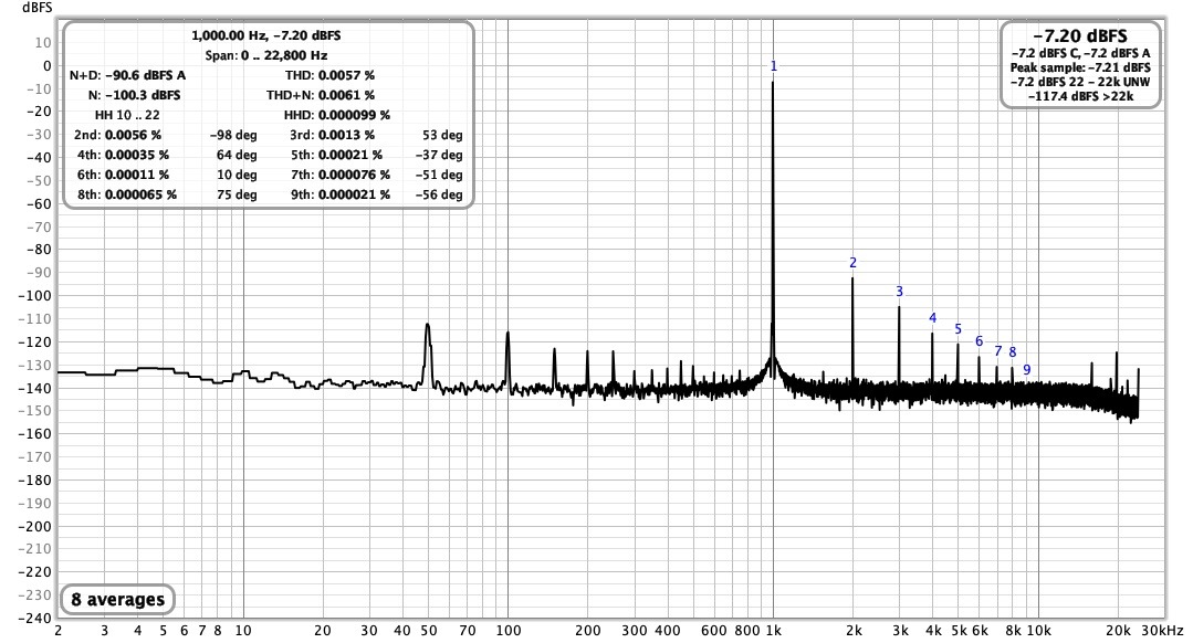

Here I tried to get the lowest distortion with low H2, not bad....
The sound with H3 dominant reminded me of the F1, these H3 amps talk a lot to the listener...

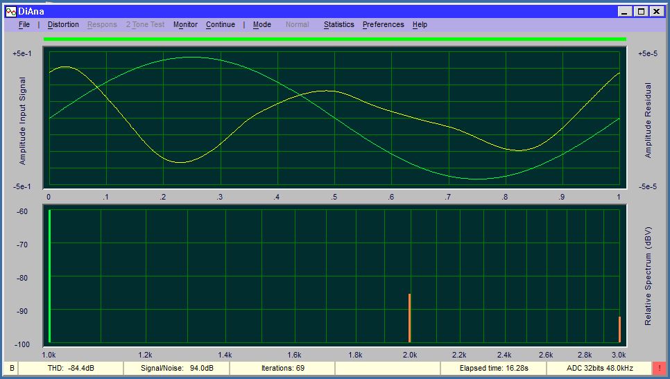

Then I tried to mimic the distortion and residual of the INT-25, means when I can believe the values stereophile showed, H2 10dB higher and neg phase.
Therefore a made a small J-Fet pre with 6dB, often shown here in different versions in front of the F5. The pre alone seems to have pos H2 phase and a nice order of harmonics.

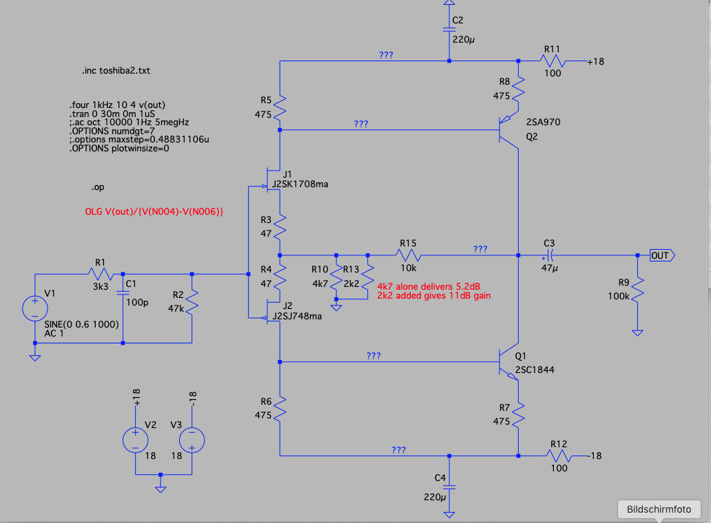

Hi, what source resistor values do you have in the output? (I have a //pair of 2SK176/2SJ56 without source resistors since several years, and while it is detailed it lost some charm. . .) so it is my once-in-a-while box now.
