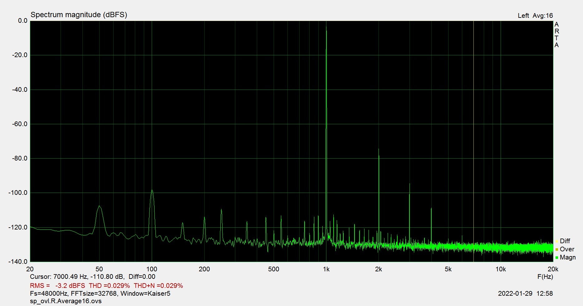

P3 in my F5 is exactly centered by resistance so the harmonics in both channels look almost equal.
The difference between H2 and H3 is equal 20 dB (-74 dB for H2 and -94 dB for H3).
Yesterday I rechecked the bias and offset after two months from the 1st take off and
there weren't any deviations (0.6 V bias and offset < 1 mV in both channels). Wow!

I don't say I want -74 dB H2. I have built my F5 and measured H2 at this level with P3 centered exactly by resistance.If you want -74dB H2, why choose a push-pull amp ?

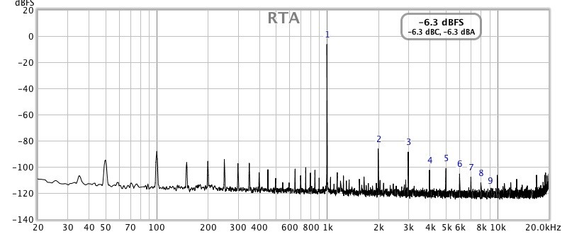

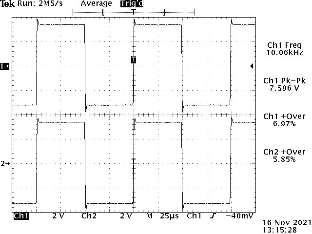

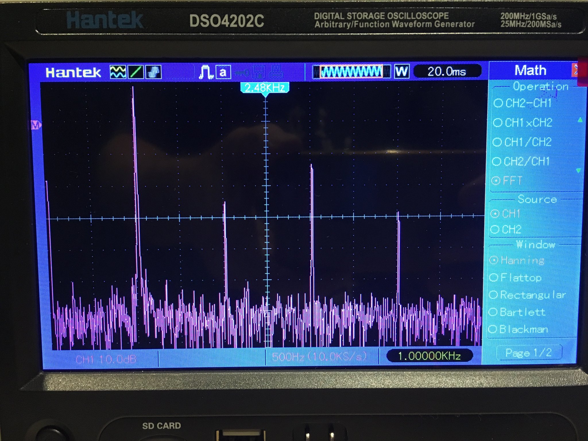

I was pressed for time, so with P3 now centred by resistance ran my F5 distortion check using an oscilloscope instead of REW.. bias 0.61V, sink temps ~48 degC, 8 ohm load. Have also attached the First Watt F5 distortion which my amp compares against nicely. Will retest using REW when I've the chance so we've continuity in test acquisition to compare against my earlier REW measurement when P3 was centred by turns.
Note: I had to increase the test wattage to ~2 watts before the scope would plot the harmonics. Not sure if it was a scope setting or the noise hid the harmonics at 1 watt. I've a new scope with coffee & waffle abilities plus bode & better probes coming so will put it through its paces once in hand & post its results
Comments welcomed
edit: just realised I should've also checked using square wave.. will include in the next round of tests & post up

for those wondering..
I had a good 3hr listening session last night with P3 centred by resistance, plot attached (using scope).
Compared to earlier when I had P3 centred by turns (REW plot attached) the bass is now a little leaner, instrument separation is better defined, brass instruments seem crisper and have more body / more complete plus the stage has better depth. It sounds very very nice but I think I'd prefer it more if I can land the distortion in the middle of where it was, and where it sits now. I finished off the session with some Lynyrd Skynyrd country rock, they haven't sounded this good in a long time.
So I think my target is H3 ~6dB > H2. I'm using ProAc Studio 125's which are a typical Xmas cherry sweat ProAc sound. Oh how I wished I still owned those ProAc Response 3.8's!

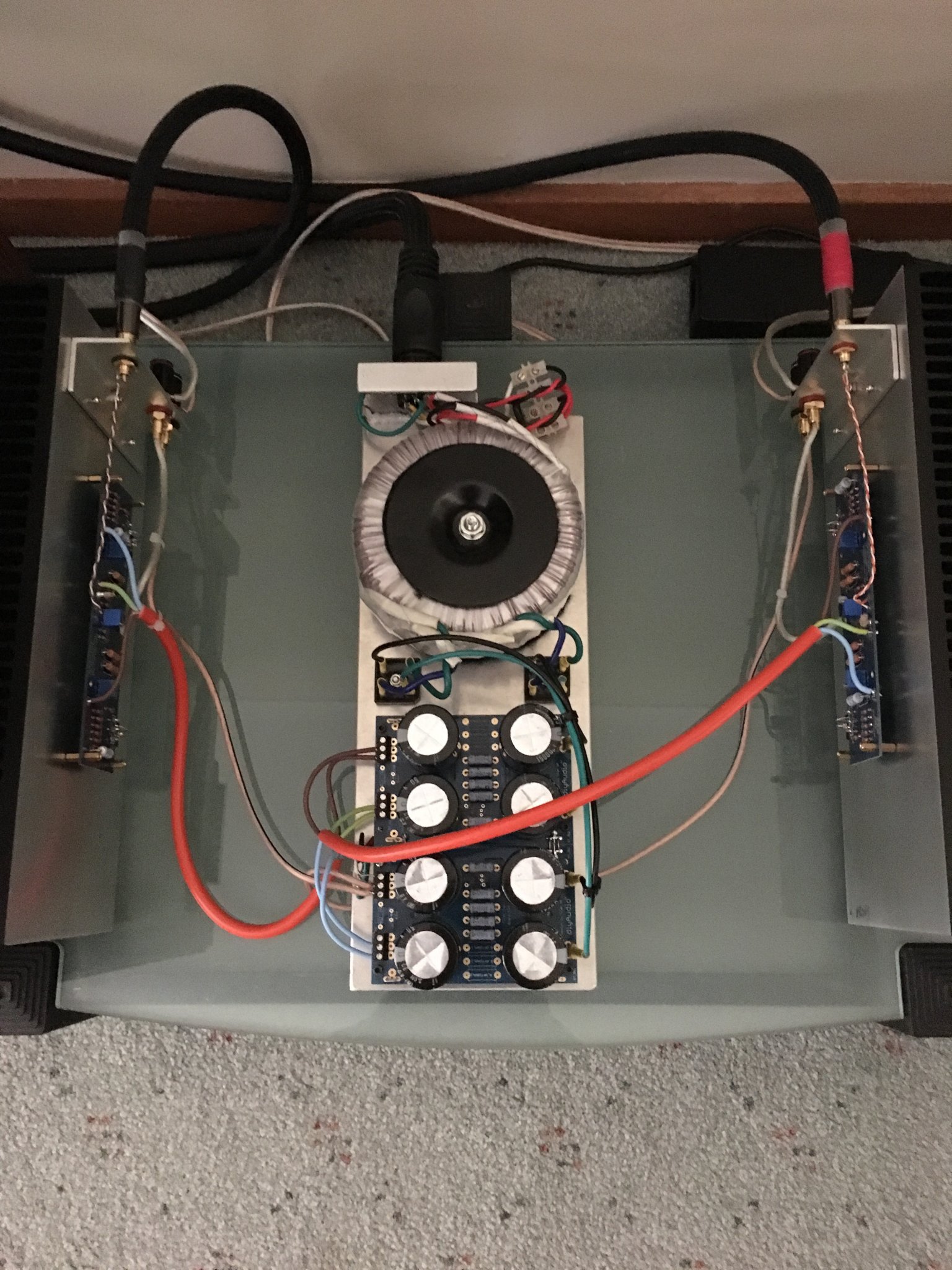

.. think Nelson maybe ahead in the dressage though, for now 😎
and please nobody comment on the PSU layout, I know I know!
Its going to be interesting what comes to the table once its cased and arranged correctly 😉

passive re-centre P3 with equal resistance across R3 & 4... then watch your bias next time you power up, you may have to adjust it
So far I haven't played much with THD so still some learning but will look into that for sure
Sorry I'm not familiar with your scope. Try searching for scope FFT demo and include your scope model and if not try scope brand !?!

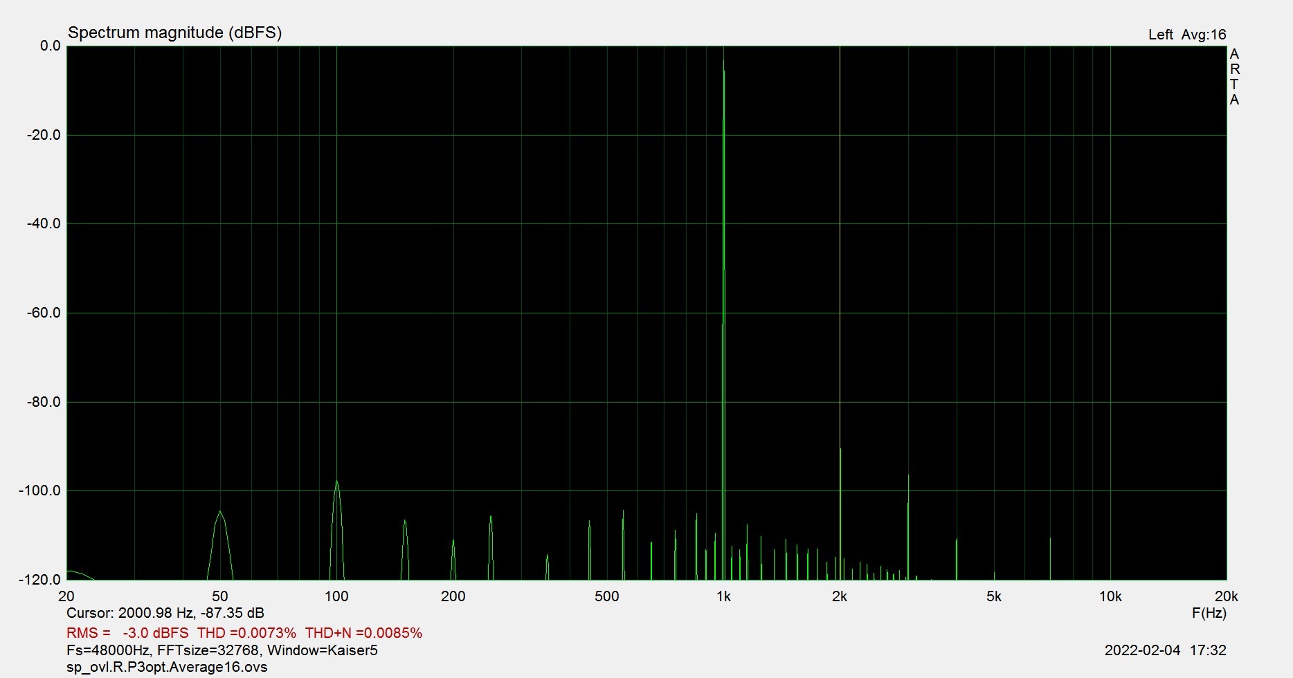

because I felt so motivated by you, my F5 come on the workshop table.
I tuned P3 to get minimum of H2. So H2 was decreasing from -74 dB to -87 dB.
H3 is still about -96 dB. THD + N is now 0.0085%, compared to 0.029% before.
This is the lowest distortion + noise that could be achieved, besides my sound card
itself shows 0.0011% THD + N.
P3 is a 12 turn trimpot and I needed to do one half turn only, convinced me that
it was nearly perfectly centered. The change is about 8R and is not big deal
having the parallel connection to 10R resistors.
Then I checked the spectrum once again with my old Tek TDS360.
The FFT output on this oscilloscope is pretty noisy and the frequency components
look a little bit different comparing with ARTA.
Why is this the case?
I leave this as an exercise for all reader of this thread. 😉
