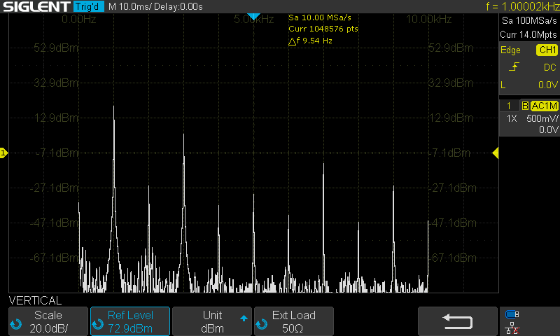

50 Hz and its multiples are not the problem. They aren't appearing in the soundcard loopback test.
They are really present in the F5 output signal. You can even hear them in loudspeaker with no input signal.
My question was: why do H2 and H3 look different on the oscilloscope and ARTA?

Resolution of a scope. That could be the real reason. Vertical there is max 80 dB in 10 dB steps on the scope.
According to ARTA H2 and H3 are below -80 dB, but the scope says -53.5 dB.
It is similar in your measurement (at #16532) - REW shows H2 > H3 both below -80 dB, but the scope says H2 < H3, level vertical?

yes resolution can at times be a problem on older gear. Have you tried X1 prong, also if possible raise the test power.
I put that down to my laptop's sound card and the voltage divider I used.. its probably a combination of them and the settings I used in REWIt is similar in your measurement (at #16532) - REW shows H2 > H3 both below -80 dB, but the scope says H2 < H3, level vertical?
How do you interpret this?🤔
I bought a new scope and it's results mirrored my old scope nicely, so I'm taking my scope results as being correct, besides I've more experience with scopes than REW. One thing I have done.. but not with REW and I should, is I've a little tank circuit I built and tuned using a VNA that I know is bang on the money. To be sure I'm setup correctly I use this to pilot test my scopes before testing gets underway.
Here's an example of a scope not quite setup correctly. This is on my new scope, note its showing ~25dB H3>2, I need to revisit it. I'm guessing my scope impedance setting was not correct.. that can make a difference in dB levels. Regardless though if you look at the results from a relative ratio perspective as apposed to actual dB levels, its bang on with my old scope. So personally I dont take much away from dB levels indicated, instead so long as H2->3 ratio's correlate I'm happy
I cannot see any valid sine. It looks more like heavy clipping or square wave, or so.
If test sine 1 kHz is at level about 30 dBm = 1000 mW = 1 W and H3 at about 0 dBm = 1 mW,
then it is definitely too much. I don't even want to think about THD value, regardless all other harmonics.
There is a worm in your test setup😉. Make a double check and try again.

I have a question relating to P3 adjustment and the measurement of this with a digital oscilloscope, do I need a differential scope probe to isolate the output terminals from earth? I tried this measurement a year or so ago and blew one of the power resistors and assume it was because I shorted one terminal to earth through the oscilloscope? I want to try this measurement again, but this time without damage.
The purpose of the gain trimmer (so called P3) is to allow you to adjust the relative closed loop gain of the top and the bottom halves of the F5 circuit.
In doing so, it allows you, with your particular combination of JFETs and MOSFETs, to balance the gain such as to maximise even harmonic distortion cancellation.
In particular, if you do not have matched devices between the two (stereo) channels, it allows you to compensate the difference to an extent.
A digital oscilloscope is primarily an equipment to allow visualisation of a signal in the time domain.
Very few of them have resolution much higher than 8 bit, not to speak of 16 bit or 24 bit.
They also do not have the required linearity to allow distortion measurements to much better than 0.1% (-60dB).
To be able to make proper use of P3, you need to be able to measure distortion to much better than -100dB.
And that means a low-distortion oscillator AND a distortion analyser (or sound card) to at least -110dB or better.

Patrick, I totally agree, oscilloscope is not suitable here. Nevertheless, Allan managed to create an exemplary spectrum for F5 (#16532) using oscilloscope and everyone cheered, me too
. How is it possible?🤔
Is it a spectrum of the F5, or spectrum of the scope ADC ?
Or a combination of both ?
