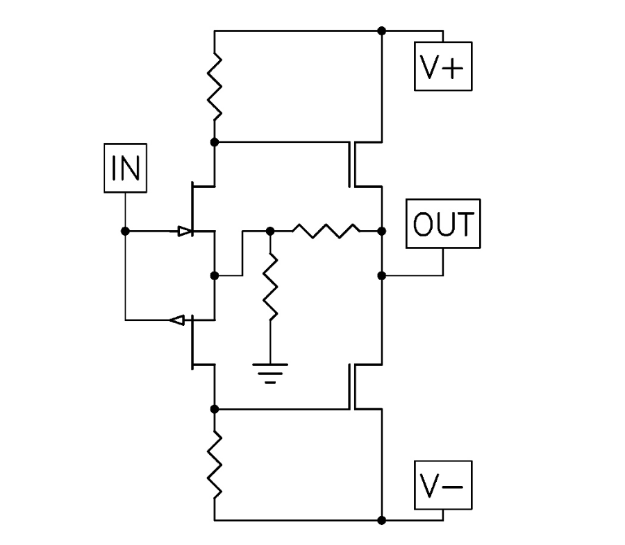

I had 0,47 @ one Toshiba 2SK176 and it was great; but I wanted more slam; so selected 2 quads of each - each with their own source resistor of 0,47. It did not image rigcht. The zero Rs is great in imaging. But 'softness in sound' is something else.
What I like very much is Nelsons new invention of a partial decoupling of the top source resistor in his single-Vb version, so both halves start to have a different amplification through less degeneration/more local feedback; and that influences the H2 amount and phase.
Here, with P3 in the F5 v2, the same is done. The amplification changes a bit through different local feedback.
In my original Le Monstre there is also a potmeter, it sets DC but also the local feedback of the input pair; I had 200/20 ohms! [Original selected pairs by the shop; the L'Audiophile design is with fixed Rd.]. So same effect in reducing the amplification in the two halves, top and bottom.

Agree that distortion in the input probably leads to H4 and higher. The trick is in setting both halves of the virtual long tailed pair at a slightly different position (instead of N-N device, now N-P device) - there can be a specific position.

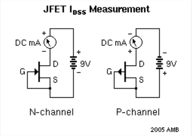

Amount and phase of H2 depend on a few factors:Is there a way to identify the right Idss for J74 and K170 to get the same H2 amount and phase
- gm of each jfet which is directly related to Idss and Vp
- jfet drain resistor
- gm of each mosfet
- Mosfet source resistor
- amount of global feedback
