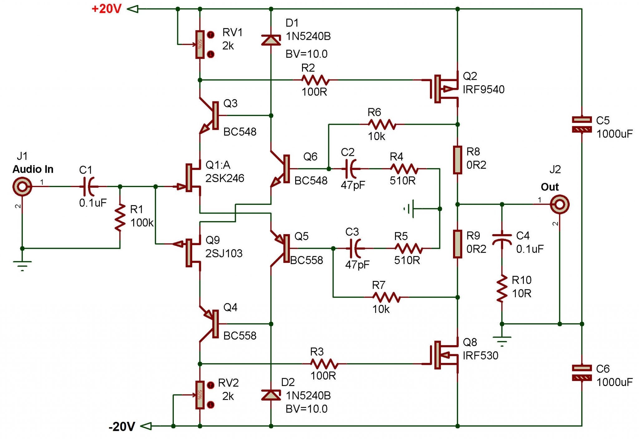

The 2sk246 2sj103's have worked very well in several amps Ive put together, an original (several) f5 circuits and an f5 turbo v2. They have had some uncalled for output mosfets, but overall, got them sounding good.
They biased fairly easily, very entertaining sound without much noticeable noise or annoyances.
I would not double them up personally,,,, although they might measure better, I think the transient interactions of doubling have more of an effect on the sound quality, versus having a minorly out of spec input stage.
Also, I have had the sk246 on an aca and that sounded great too. I think they are very good solid sounding jfets, I have enough for 5 more amplifiers and I intend on using the rest of them because they are worth it even though they arent the 170/74's.

The 2sk246 2sj103's have worked very well in several amps Ive put together ...
I do agree that people underrate them.
They can deliver great results if you design circuits round them, rather than just use them as K170/J74 substitutes.
For example, we have built a John-Curl Blowtorch-like circuit with the SMD version, namely K208/J106.
The NEXEN both measures and sounds great, to me.
And it turns out to be much lower noise than many would expect.
https://www.diyaudio.com/community/...orch-preamplifier-part-ii.146693/post-5270193

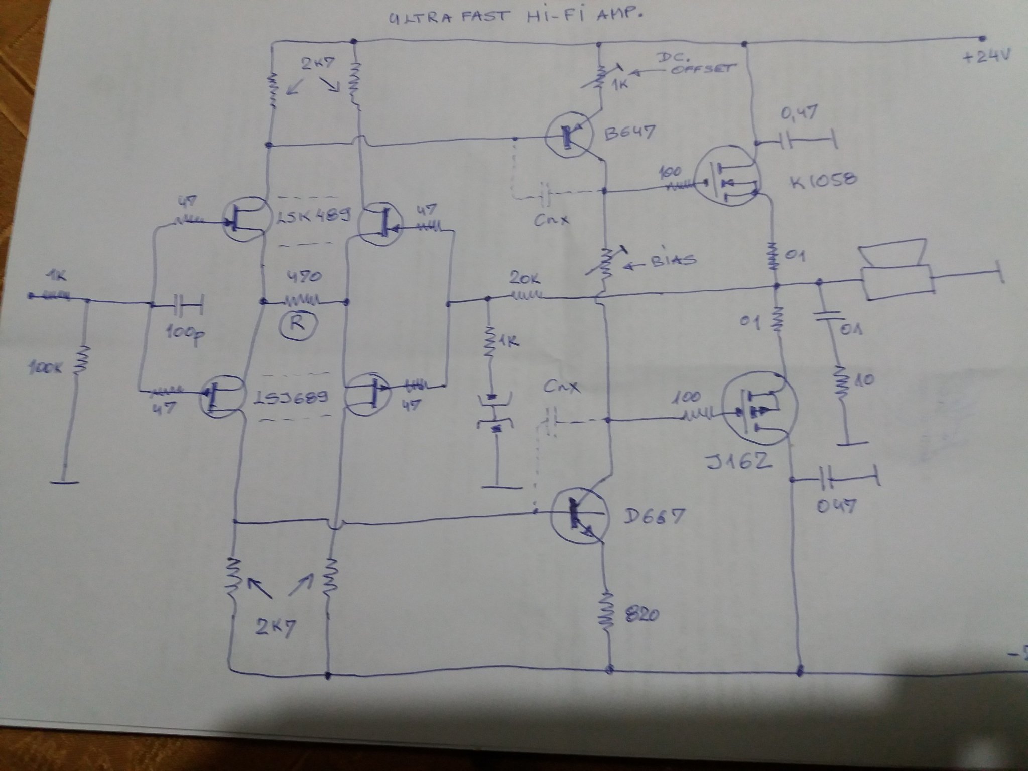

Some examples from well-known designers using K246/J103 :
http://jm.plantefeve.pagesperso-orange.fr/sche.html
http://www7b.biglobe.ne.jp/~konton/No-168 seisaku.html
https://www.diyaudio.com/community/threads/semisouth-goes-dodo-what-now.222098/post-7233757
http://la4.cocolog-nifty.com/blog/2010/10/fet3-f844.html
https://prosugo.web.fc2.com/yasuiamp.htm
https://plaza.rakuten.co.jp/shomarin/diary/200708110000/
https://forums.melaudia.net/attachment.php?aid=28755

Yeah, that design with leds makes no sense whatsoever...
When I have problems with imaging, where left and right phase shifts change transiently, thats when I Know its time to change parts. 246/103 pairs have reliably performed well on many occasions, which is why I would recommend them.

One more to add to the above list.
This one I find interesting.
http://www.zpag.net/Electroniques/Audio2/40w_audio_amplifier_01.html

I know that this will be off topic but I wish someone can answer my question here.
I have some troubles using 2SK246-j103 is a Vzaichenco project,Only, Distortion,Negative , Feedback Amplifier.ODNF.
In this project ,like the others that posted here,it isn't any clarification about 246-103 IDSS classification Y,GR or BL.
