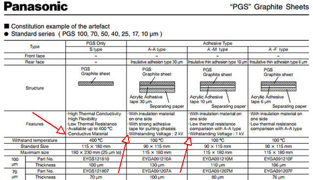

Yea, I saw that also. Looks like A-A type could be the minimum used, but not sure which orientation of the paper would be best. Though "Withstand 1K - 2K voltage" is impressive.

it has been confirmed that it works
maybe the added goo grease does the trick
but they also say just one little tiny 'something' jammed between device an heatsink, and it may all be over fast
other than that, I wonder if the very low insulation resistance could cause instability issues ?

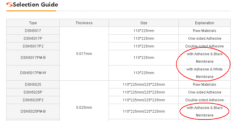

I suspect that membrane might be more compliant than mica as the product is stated to 'flexible' - not sure. I usually scrape the heatsink stock I get from HS-USA with an old fashioned single edge razor blade, comes out close to a mirror surface. Never used any of the pieces from the forum store so I don't know how smooth they are.
