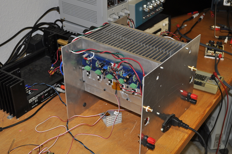

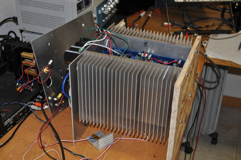

I verified my conjecture about the chimney effect of the heatsinks mounted fin-to-fin in my F4 amplifier. Each channel is biased to 1.36A with 22.6V rails for a total of about 125W total dissipation. I measured ambient and heatsink temperatures for two configurations: fin-to-fin and fins outward as shown in the photos. The temperatures shown were after more than one hour and were stable.
fin-to-fin fins-outward
ambient: 20.1C 20.1C
left channel: 42.3C 44.9C
right channel: 42.3C 44.9C
<sorry - I cannot figure out how to present a table with this "editor">
a 2.6 C degree drop down to T s-a of 22.2 C degrees is mighty impressive.
I note that the sinks are quite tall. This efficiency improvement may tend to be more effective for tall sinks and may become very effective with very tall sinks.
The speed of airflow is due to the difference in pressure at the top & bottom of the "chimney".
It's the "speed" of the airflow that reduces the thickness of the laminar layer attached to the fin surface.

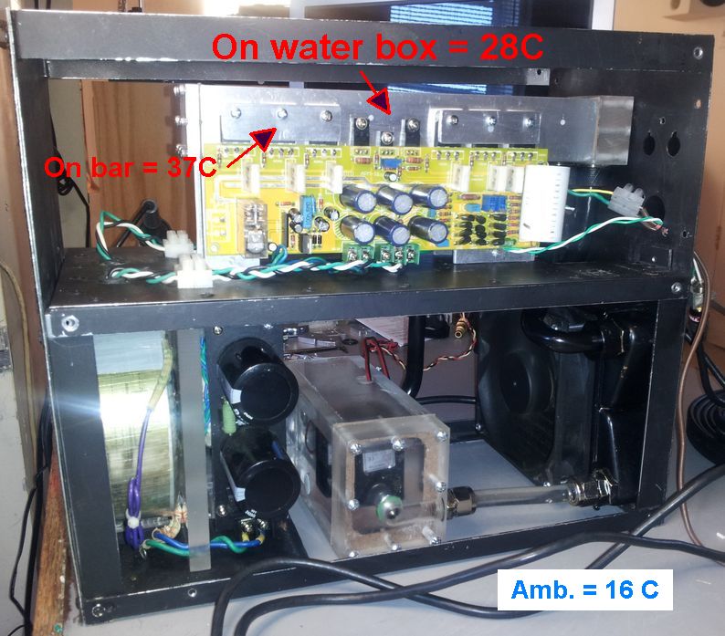

A new small footprint F5 on the way - first run.
Developments on a horizontal format liquid cooled chassis are progressing. This is a JFET-BJT Cascode input with 12 output transistors and the temps are very encouraging. This PCB is 230 mm long and the F5 is 170 with fewer devices. That suggests the F5 LC chassis will come in at ~ 9" deep x 7" wide x 8" high.
The heat transfer will be much better as this experimental build just uses ceramic pads with no compound. I'll post in the LC thread when the final F5 version is completed - should be a nice set in a very small package.
While I agree that 2.6ºC is a real and useful difference, I would suggest that the 'chimney effect' is not making ALL the difference here.
If we agree that the hottest place(s) on the HS is immediately next to the output transistor(s), then orienting that face (and the output devices themselves) outward and into the ambient air would cool the HS more than facing them inward where they are relatively more 'shielded' or 'enclosed' from ambient air.
With the fins outward, there is plenty of airflow for cooling the plastic sides of the output FETs, but the air to plastic thermal efficiency is extremely low. I haven't performed the experiment, but I predict that separating the outward fin heatsinks by an arbitrary distance would not make a measurable difference in the temperature.
The chimney effect is well documented. This paper compares heatsinks with "open" fin designed to closed extrusion designs which are similar to my fin-to-fin arrangement. http://www.crydom.com/en/Tech/Whitepapers/HS_WP_FA.pdf.
