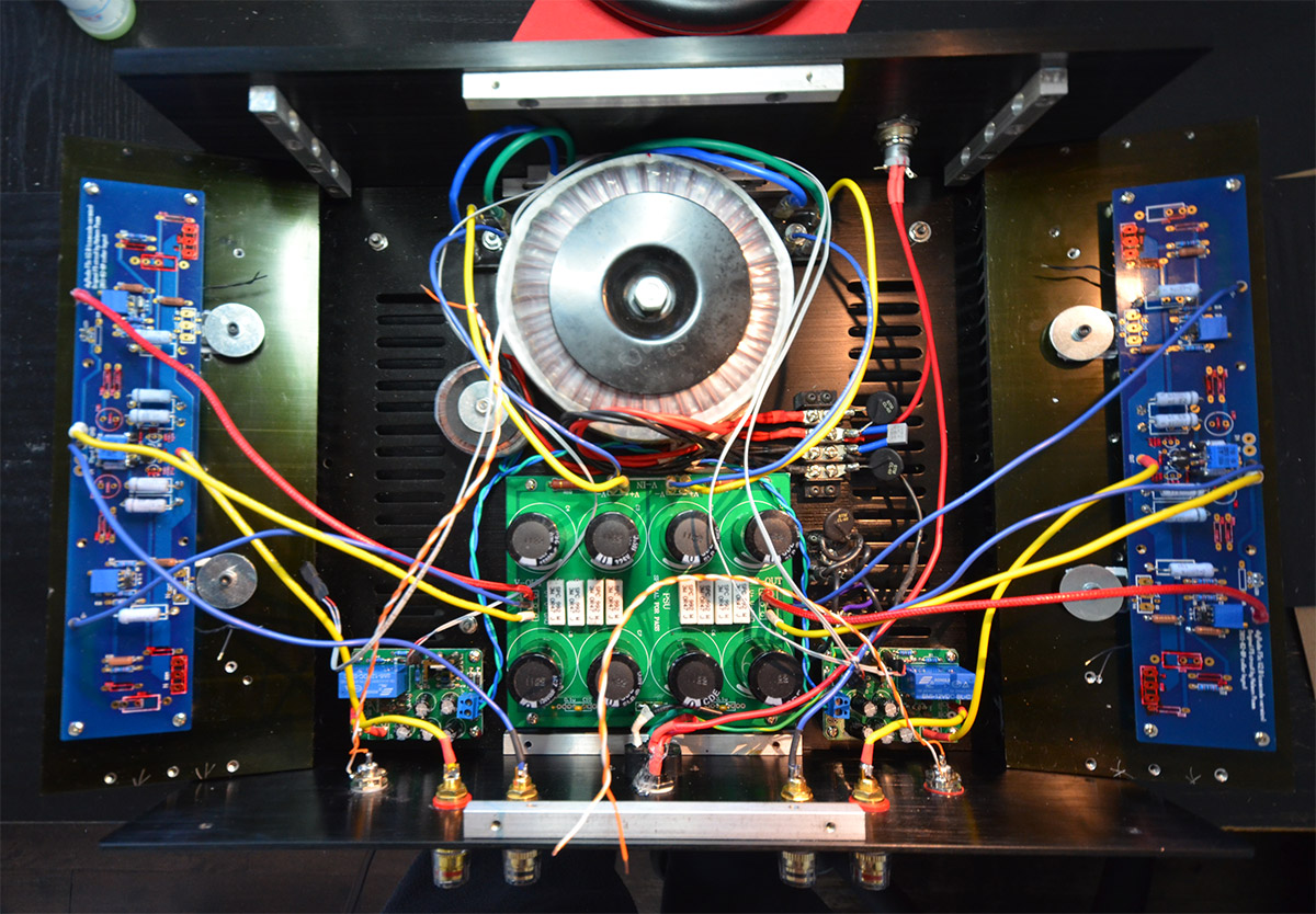

Temp measurements
I too wondered about the convection effect. Thanks for testing and sharing the results.
I noticed you have 3 temp probes setup: 1 taped to a heatsink on the workbench and 2 taped to each channel's heatsink. Are these K-type connected to a DMM or did you make your our with thermistors?
I verified my conjecture about the chimney effect of the heatsinks mounted fin-to-fin in my F4 amplifier. Each channel is biased to 1.36A with 22.6V rails for a total of about 125W total dissipation. I measured ambient and heatsink temperatures for two configurations: fin-to-fin and fins outward as shown in the photos. The temperatures shown were after more than one hour and were stable.
fin-to-fin fins-outward
ambient: 20.1C 20.1C
left channel: 42.3C 44.9C
right channel: 42.3C 44.9C
<sorry - I cannot figure out how to present a table with this "editor">
Did the wood come into play? If I read it correctly, when the wood was being used the temps were higher.

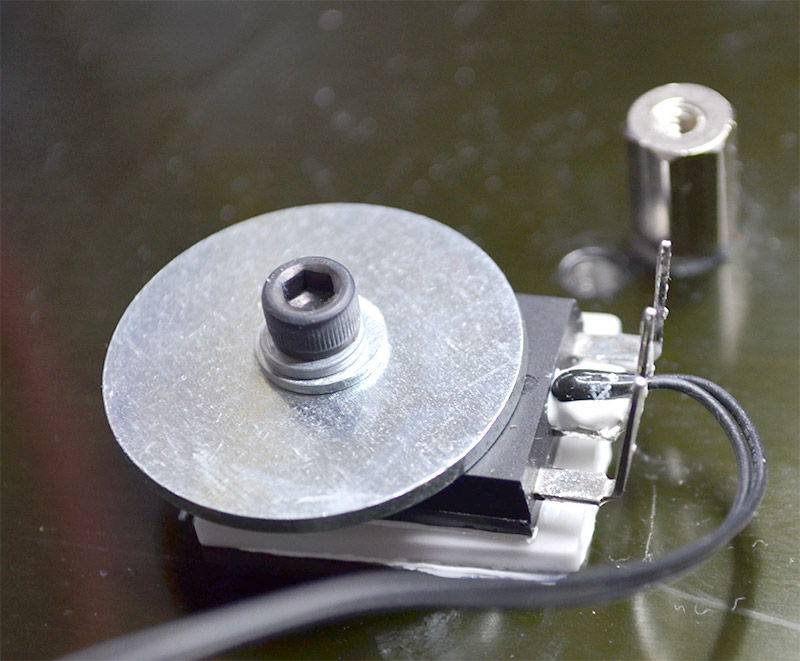

Thermistor - sperm like
Hello,
I have these thermistors that are black, a dot and 2 flexible leads. Because the leads are flexible I have glued the thermistor end to the center pin of the FET. However the leads look flimsy.
Should I worry about the leads and heat. I used Arctic White Epoxy Thermal Glue.
See image attached....
Thanks.

Nice work. I wouldn't worry about the leads too much, but you might want to twist them lightly.Hello,

I liked your idea of the washer to spread force. However, that will not accomplish placing the force where it is the most effective. The best place to put all the force is the geometric center of the package, where the mounting hole isn't (of course). As it is, the washer is only raising the screw head, it doesn't transfer the force to the package center.
I'd tap the sink on both sides of the package, and use a bar across the device to put force in the middle. In addition, I'd pre-bend the bar into a curve, and use it concave side up so that as you tighten the side screws, the bar will tend to flat. As an alternate, you could put a small bellville on the package cup side down, and the bar will apply force central to the package.(put a flat washer under the bellville so that the force is not limited to the package edges).
Uniformity in pressure is your friend.
jn
Good point. Less aluminum to dissipate heat, makes sense. So the fins facing each other didn't make much of a difference after all?

But I need to run it first as is with the washers. Besides, those pads are Alu Oxide so they don't take much pressure before they break. And the DIY store is 'moving' so nothing otherwise to use other than Mica which is boring. I'll have to see what kind of temperatures I get. The sinks are 0.30C/Watt so should be 'just right'.
