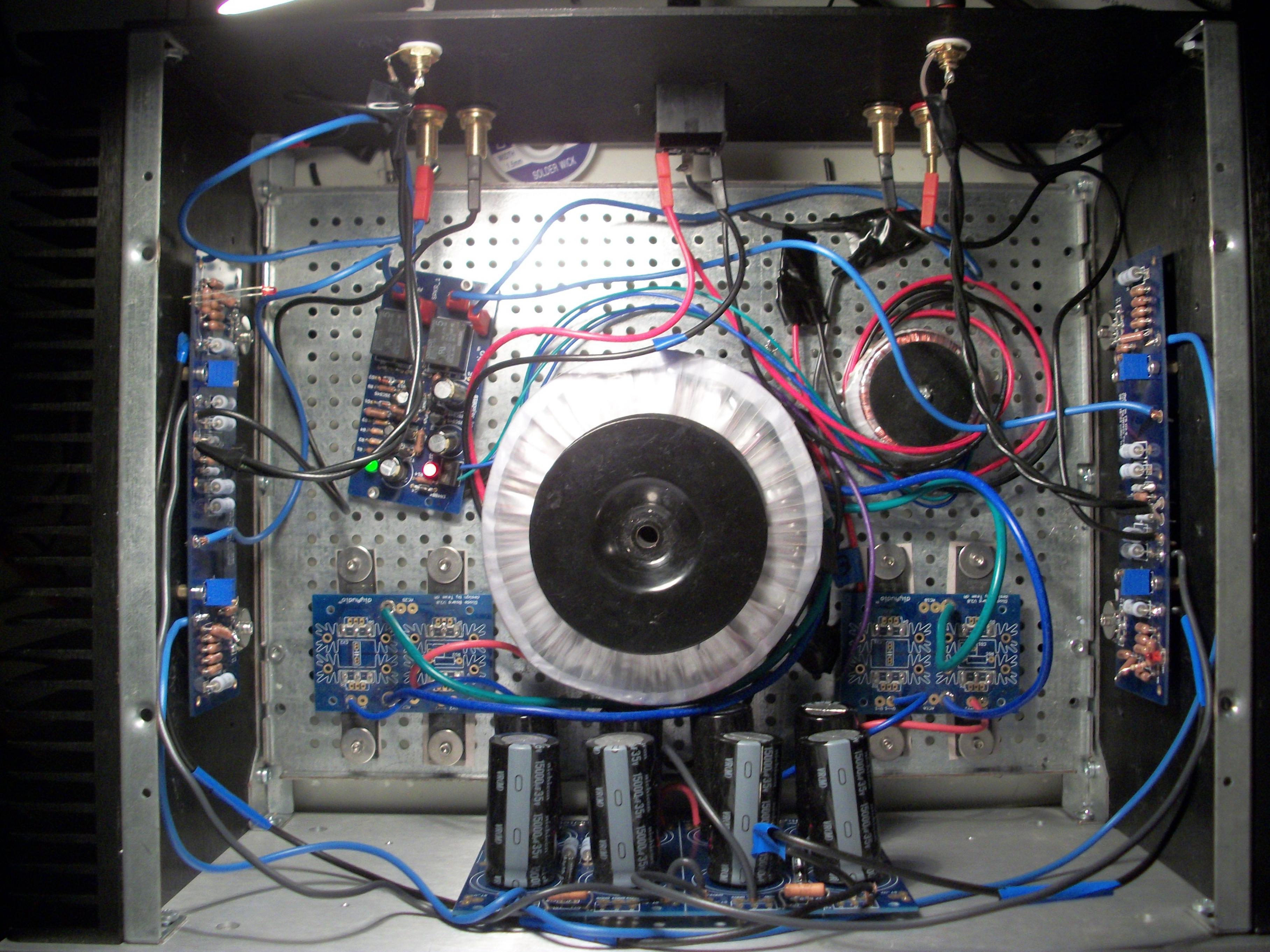

Hi guys, now it's the last step. Facing the hum. I can hear it clearly on both channel and when I connect the rca cable it becomes louder. The only way I found to limit it is connect with a wire the L rca gnd to power supplu gnd. But it is still there. Any suggestion?
