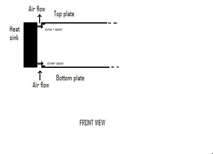

I use this arrangement to allow an air blade to circulate along the flat side of the heatsinks.
Top and bottom plates do not join completely the heatsinks (1 cm free)
That keeps the inside quite cold.
No need to drill holes but around the xformer.

I do something very similar, creating a chiminey effect, keeping air moving vertically (slowly) over the board. I have not had any offset drift due to this.
I still use holes in the top and bottom cover for additional airflow through the case.

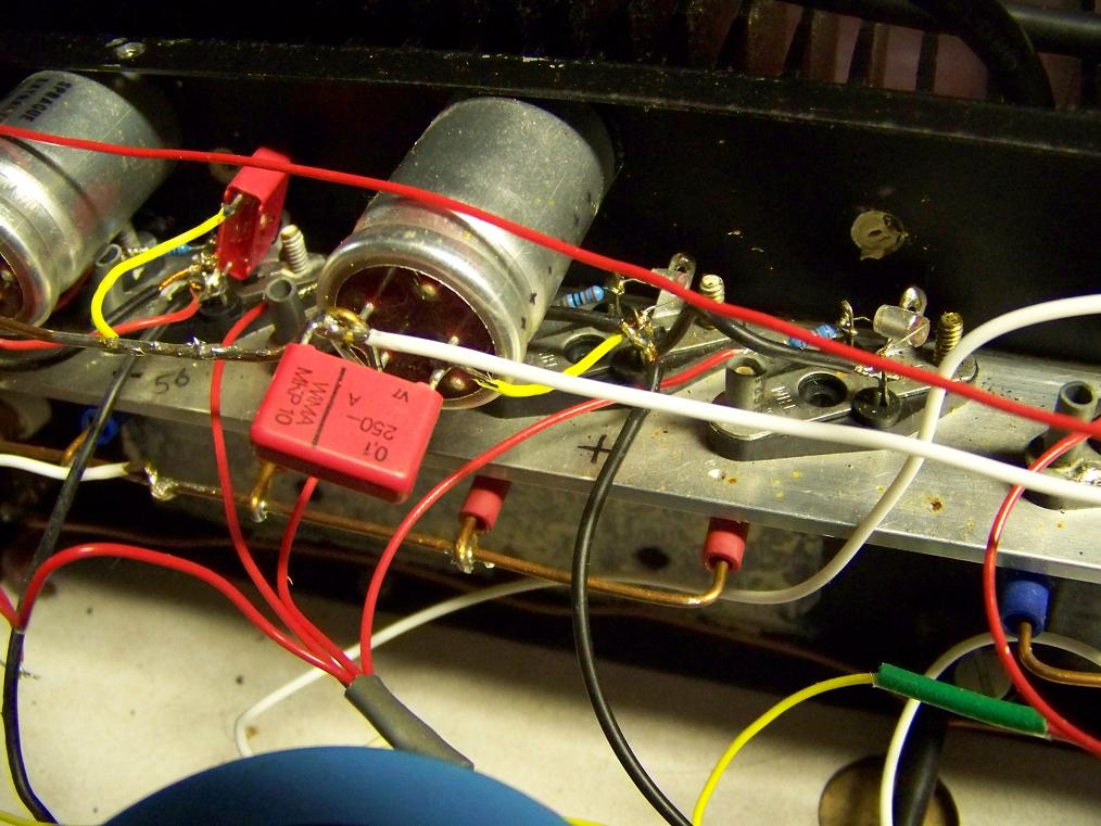

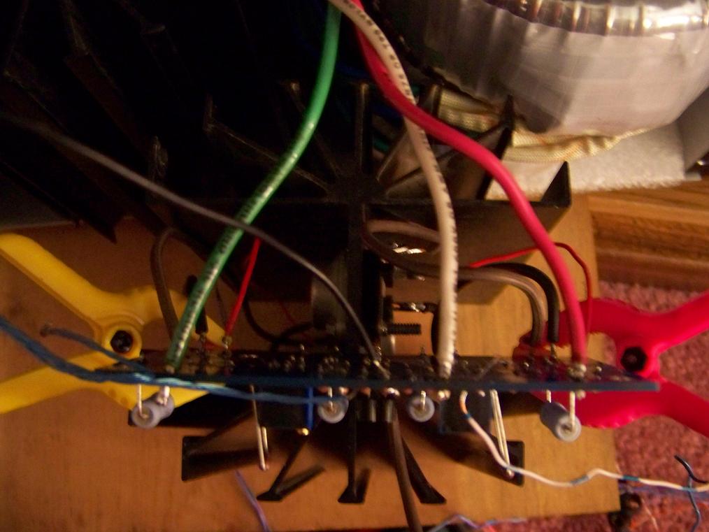

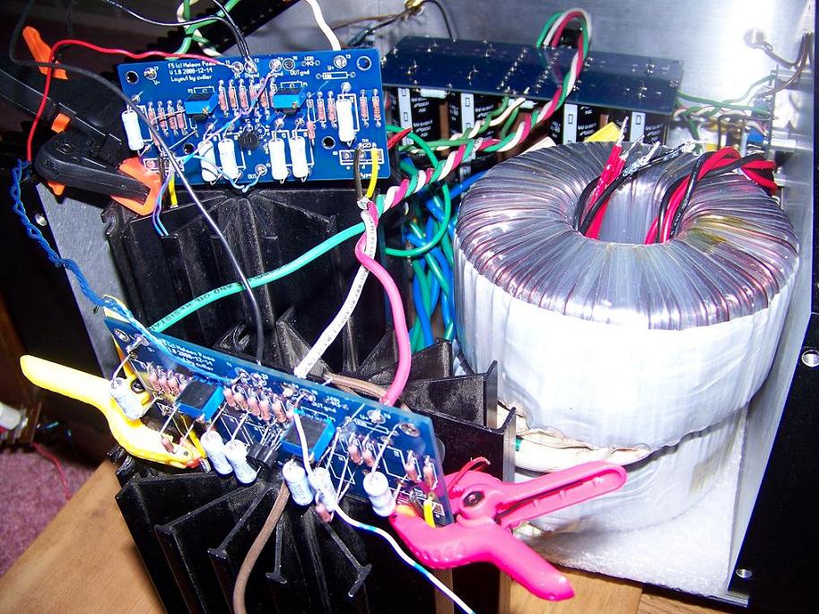

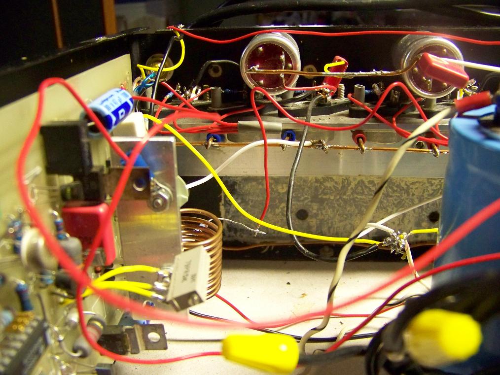

Pics of the guinea pigs.
The paddle wheel heatsinks are the 134/49 Hitachi Mosfets (Top left pic & bottom right pic).
The other is the DC100 next up for the test (top right pic bottom left pic).

I also like the neat internal layout of components and wires.
Maybe i ill put some kind of mesh on top instead of aluminum plate. I have somewhere stainless steel grill with around 5mmx5mm grid.

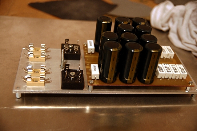

I hope that I succeed in something a little closer to the best samples which I saw here. Now i working on my PSU : it will look like this - today ill solder all wires (if ill get one of the missing capacitor).
Thank you for ideas.
o.
