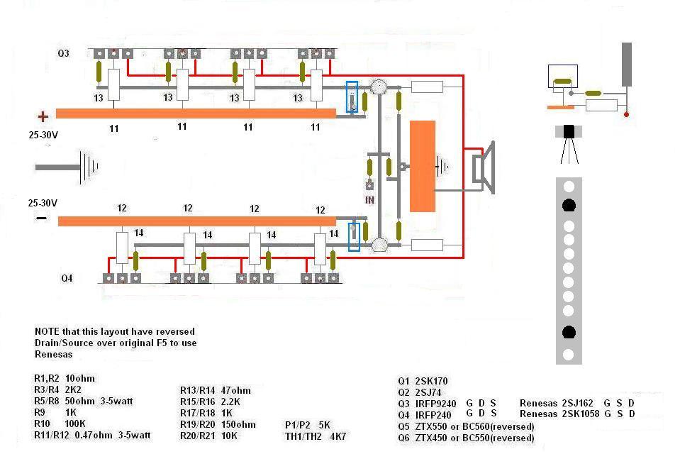

Im still in doubt about the rail voltage
But I will probably stick to 25V with raised bias
Regarding Jfets
Are you sure that an effective heatsink on each Jfet wont be just as effective
And with each leg connected to solid wire
It should be able to deal with the worst temperature variations
I suppose the constant temperature variations is the problem
If temperature is more stable, DC variations should be less, even if both Jfet are not thermally connected
Just speculation
Anyway, it will be hardwired all through, and "layout" is just an overwiev, and things may change a bit once I start soldering

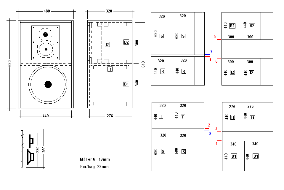

Also useful fore making speaker cutting plans
Just bought a used lazer printer cheap
Black and white, but ok fore simple schematics etc

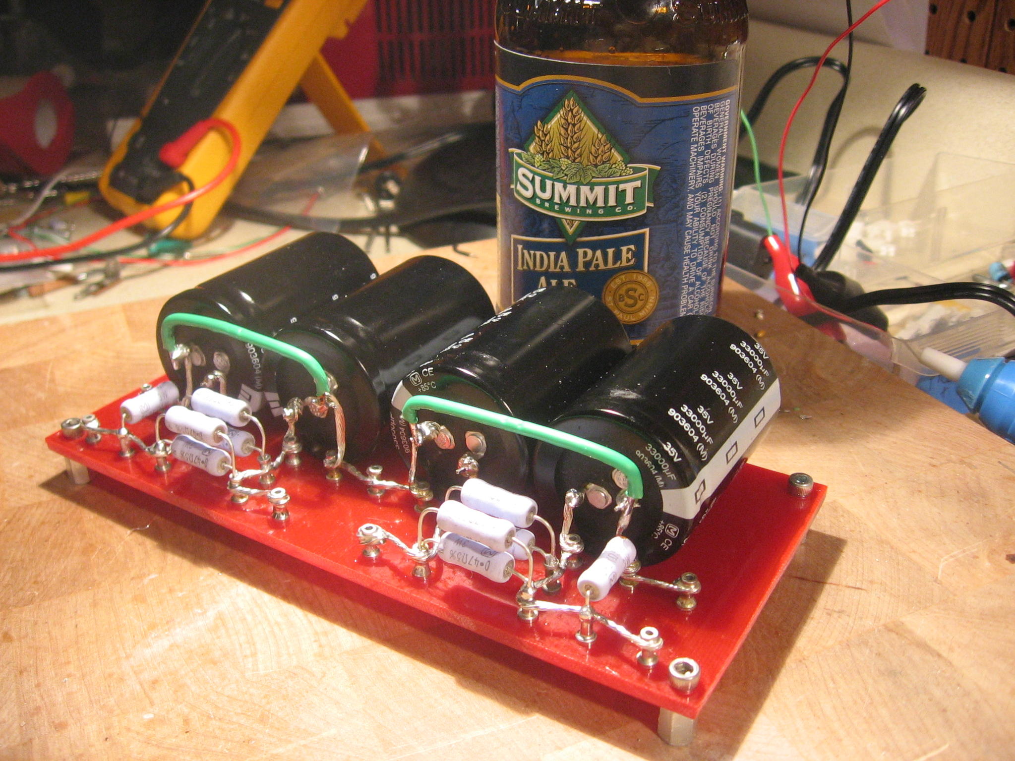

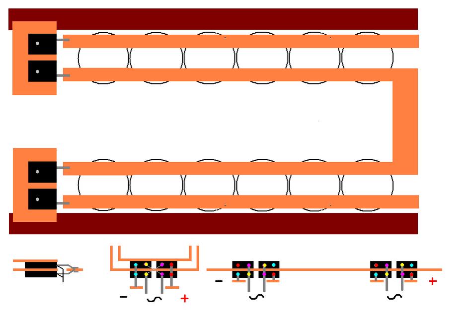

If of any interest, I have made a small change to supply
I was tempted to put in a couple resistors at the last supply cap, fore the Jfet/bias curcuit
But soon realised I better not do that, again
Instead I have "seperated" the last caps with a "thinner" wire
May not matter at all, or may be one of those little things that might make a small difference

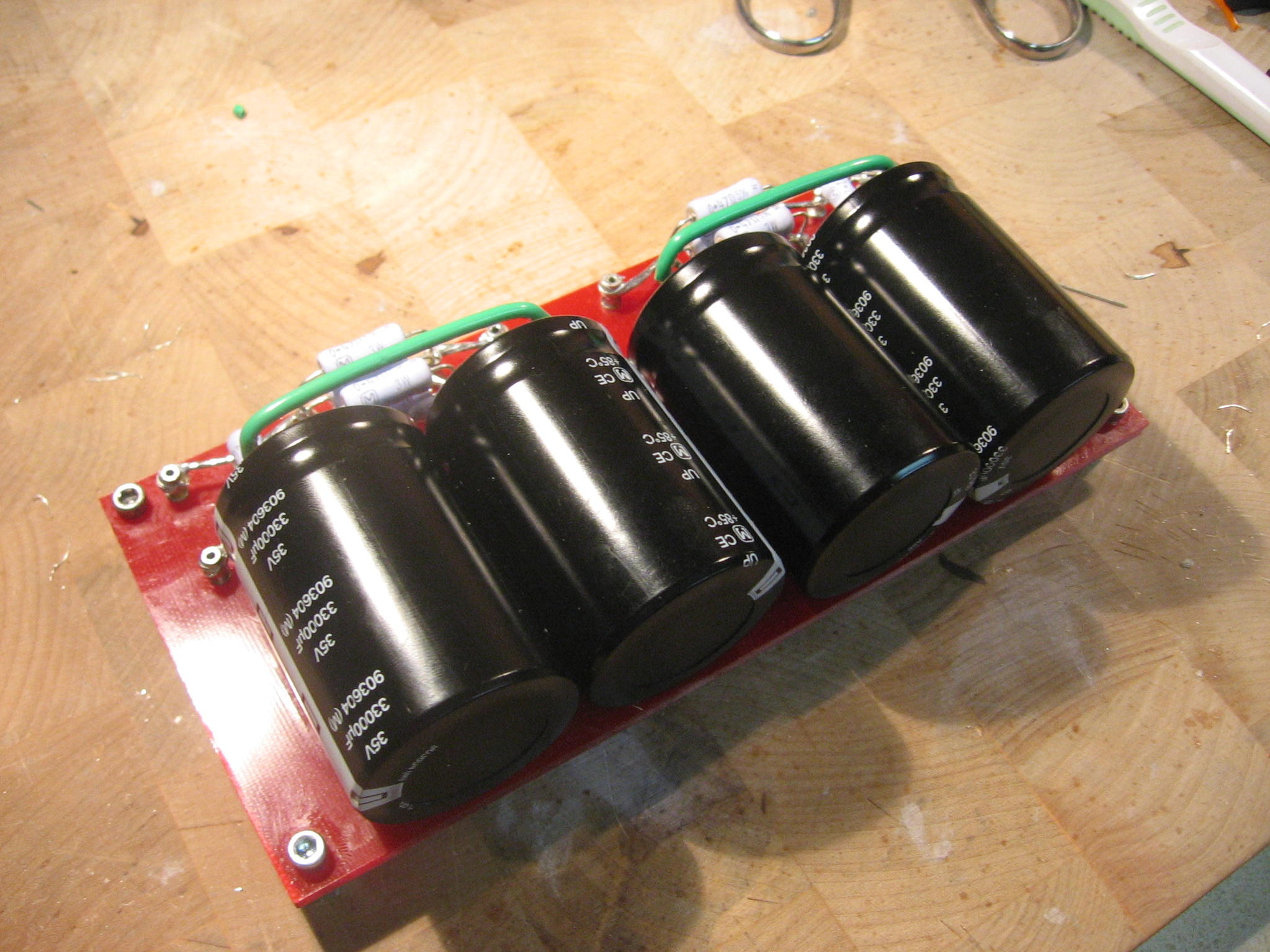

btw, supply caps are planned to be BC 22.000uf/40V

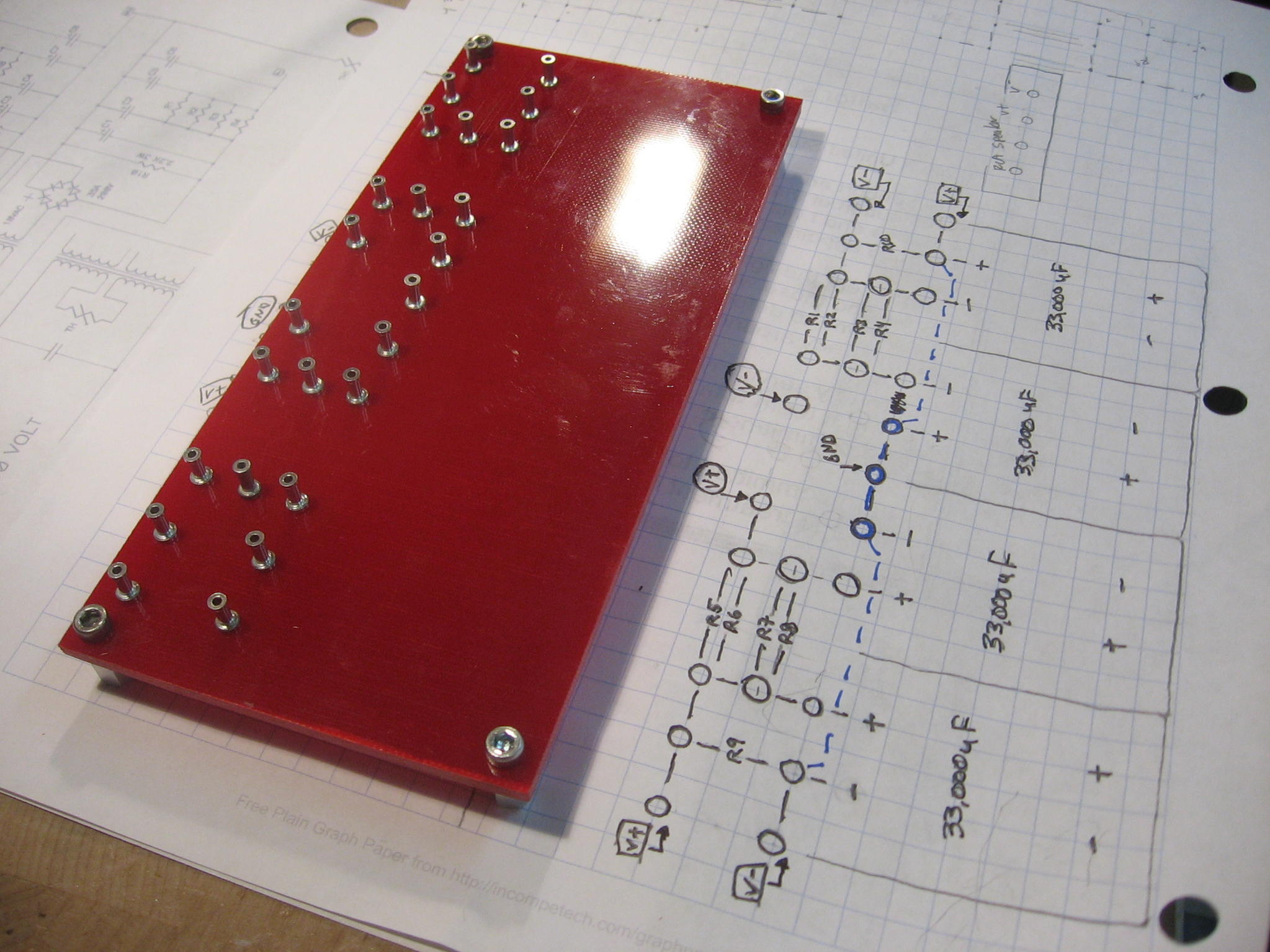

i made some progress tonight - doin' it the "big dumb way".. 33,000uF Panny UP x4. Panny power resistors. red G-10 board is 3-1/8 by 6-3/4. block rectifiers will flank the board, mounted directly on the chassis bottom.
I had to limmit the bandwith because I got oschillation(uncuntrolled heating)when connected to a DAC via transformers.Anyway I used a 2,2nf across R10 and that stopped the oschillating(heating)but I think I got some less detals after,can the 2,2nf cause that?Should I use a smaller cap to keep out of the hearing area?I find that the most important details relate to the bandwidth.
The typical - 3dB point is out around 1 MHz, so without
compensation you can see all manner of effects.
Any time there is a question about this possibility, it's helpful
to throw a small capacitor across the feedback resistors and
see if it changes anything.
Hi Ryssen,
I think R10 is a ground reference, not part of the feedback. To limit the bandwidth the cap needs to be on R5 and R6 (plus R7&R8 if used). Perhaps you can also consider increasing the gate resistors (R9, R13, R14) to see if it fixes the problem? Trimpot might be a friend here. If I'm mistaken (quite possible as my grasp is tenuous) someone please correct me.
Garrett
Correct, it is R6-8
I was recommended a cap in the pf range, but to be checked with instrument
I suppose that if you mount the wrong size cap you will just get a "ringing", and still have not dealt with the problem
Isnt 22-100pf often used
100pf is like 0.1nf, right
If you use multiple outputs, its also been adviced to increase R11/12 source resistors to maybe about 1ohm
In the manual it says"You can limit frekvency responce by an input capacistor across R10,and allso in the feedbackloop with capasistance across R5 and/or R8,i have choosen not to"
I tried caps across R5 and R8 with no effekt on the problem,cap across R10 had effekt,maybee to much...
Ofcourse, it makes perfect sense
R9 and R10 are there exactly to deal with problems like yours, oscillation caused by a connected source
- F5 power amplifier
