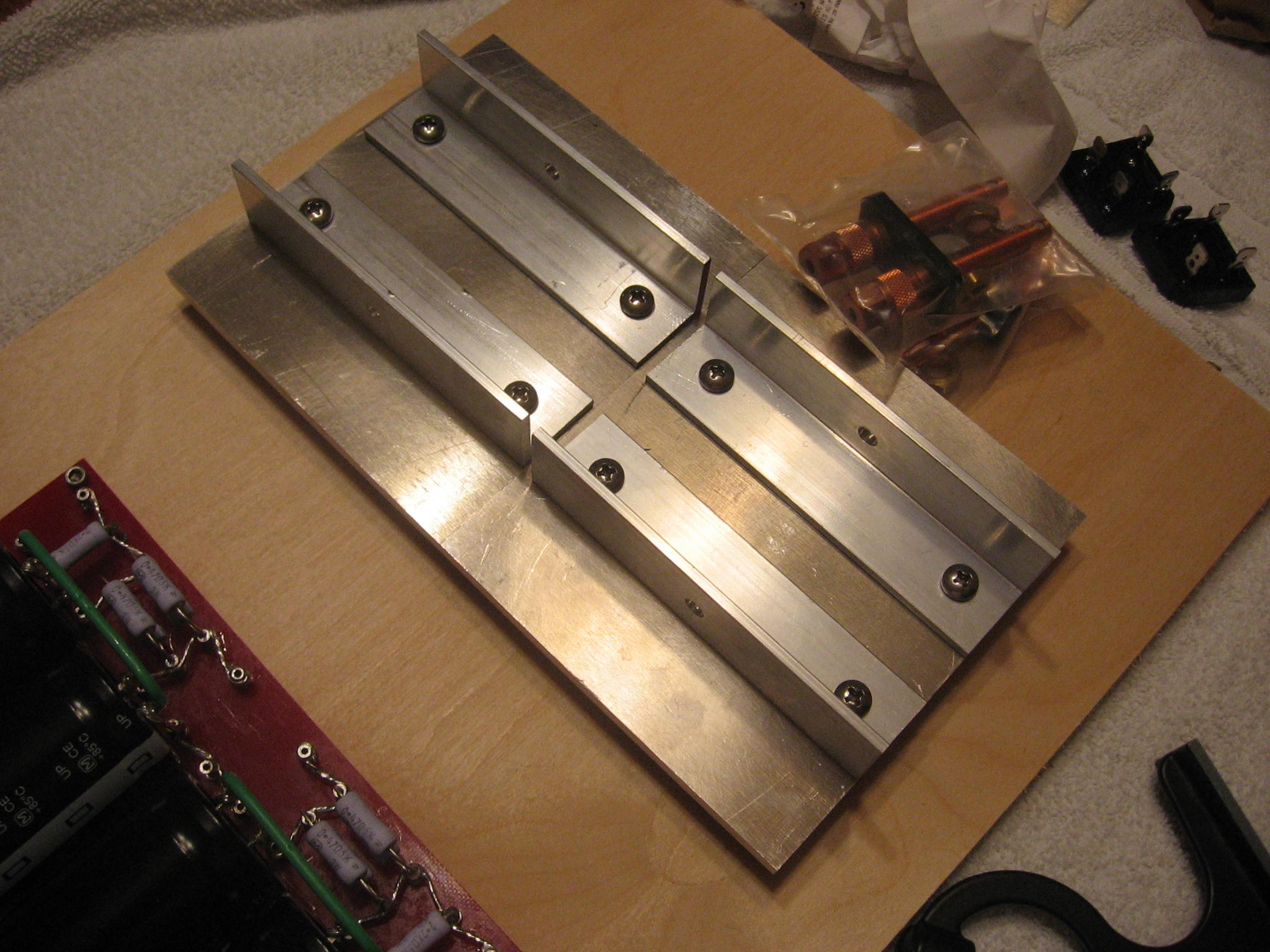

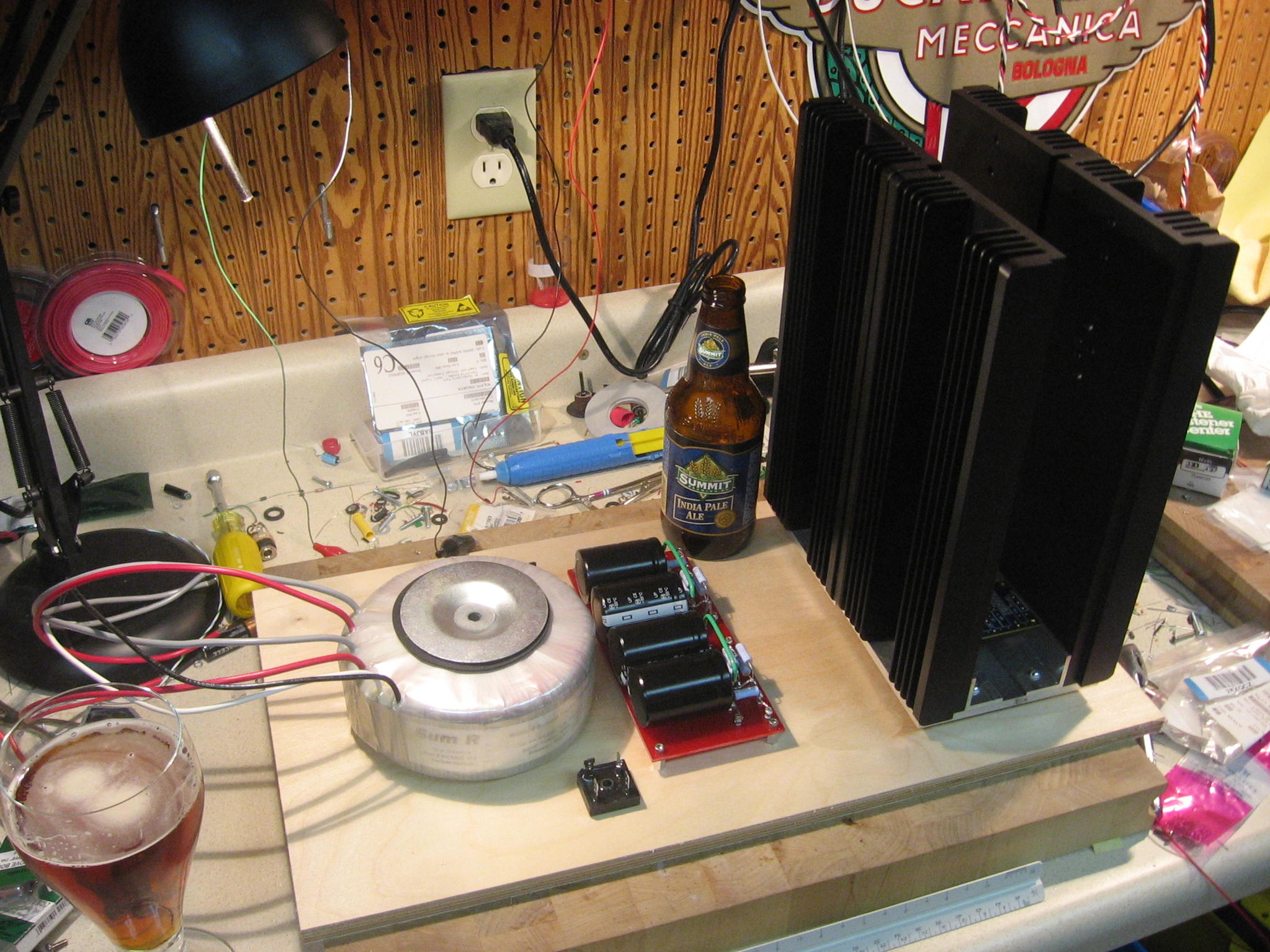

i hoping my heatsinks 11.25x4.5x1.25 with 5/16 bases are up to the task - this is the size of one heatsink. i'm using 2 per channel for a total of 4 heatsinks. below is a pic of my layout on ply. i really liked the fact that i could mount the MOSFETs without tapping a blind hole. i hope i can get the bias up to 1.3A. the second pic shows the 1/4" thick mounting bases for the heatsinks. i will need to reinforce the tops of the heatsinks as well, without choking the ventilation. i'll probably throw some shaving cream at the L-brackets on both sides.

... and maybe one more screw in the middle too... or am i wrong?i'll probably throw some shaving cream at the L-brackets on both sides.
Cheers! 😉
If not he can always open up the mounting bases by sawing 1" off and put some real feet underneith.
