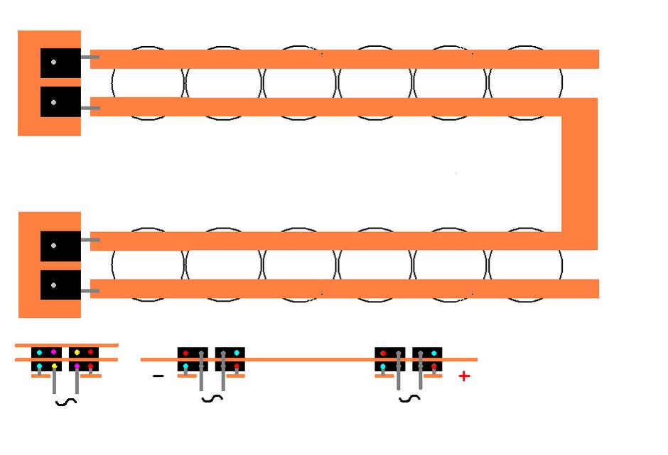

These fuses will be for + and - rails for both channels after capacitors (maybe i should have used fuse holders for PCB, but anyway now its too late for that solution). For primary i will use fast blow fuse (not decide yet - chassis mount or panel/socket mount).

Fast blow for each of the secondary fuses, i.e. FxA
There is nothing wrong with putting the PSU fuses at the PSU. Fuse upstream of the first risk area for abusing the PSU.
BTW,
the FxA fuses can be half the maximum RMS/peak current into your standard speaker load.
25W into 8ohm is equivalent to 1.6Aac and 2.5Apk. Fuse at F1A to F1.25A for 8ohm speakers.
For 4ohm speakers, double the fuses at F1.6A to F2.5A

Hi,Andrew, do we fuse AFTER the caps because of inrush current?
if one fuses the secondaries before the smoothing caps without any slow charge circuit then the fuse value will need to be so large to avoid nuisance blowing that no effective safety advantage comes from fitting the fuses.
With +-30mF on +-25Vdc, I suspect that instead of F1A on 8ohm speakers one would need bigger than 3A to avoid occasional blowing, i.e. F4A or F5A

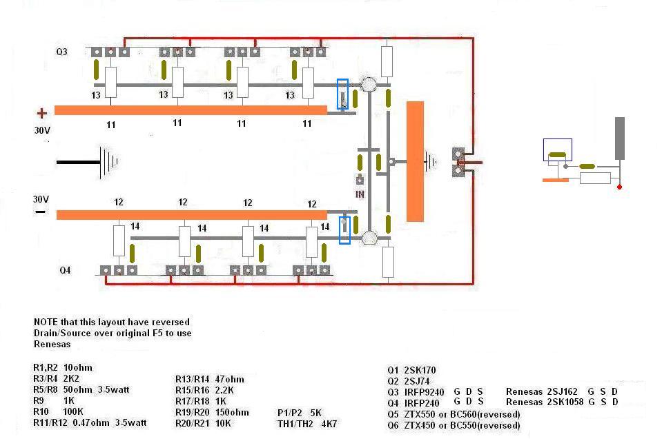

Michel le Bobo,
in case of the F5, at which side of the output devices is the bias referenced to ?
Secondly, what would the feedback do at the source of the JFETs if there was +/- 10Vdc at the output ?
(your BYW99 are heading for southern France first thing tomorrow morning)

Michel le Bobo,
I got it;
when one rail is open, the feedback resistor of the opposite half forces the corresponding Jfet to open , then there is no more bias on the facing mosfet.
Thanks Jacco, i missed this aspect.
No current from the open rail side is flowing through the load .
Neither any current from the opposite half (as stated upper)
So the load sees no current at all.
I do not really understand your question, Jacco.
Or am i wrong somewhere?
