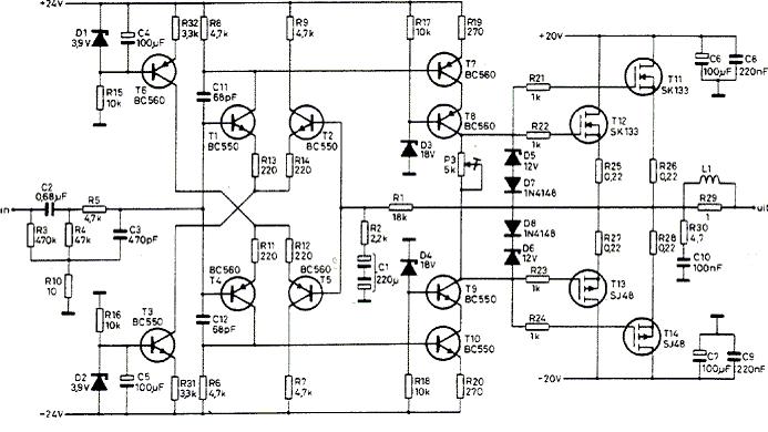

Even the 20W Class A Lateral Mosfet amp by K. Lang did not have that feature.
That thingus was biased to 2A btw, aka 32W rms Full Class A in 4 Ohm.
AudioXpress should still sell boards for the amp, the design appeared in audio/radio mags all across the globe mid 1980.
[and for the ones who still don't get the jokey after two decades and spare change : the author K. Lang stands for "Klang", which is the German word for "Sound" ]

Wasn't it Borbely who put 300pF caps across each gate of the N-channels to level out the input capacitance on both sides ?
AudioXpress should still sell boards for the amp, the design appeared in audio/radio mags all across the globe mid 1980 ....................
I have that issue of Audio Amateur #2 1986 page 7, 'The Lang 20W Class-A Mosfet Amplifier'. Pulled it out last Friday to see how high he biased it. He has two pair per channel at a quiescent current of 2 amps with a supply voltage of +-20volts.

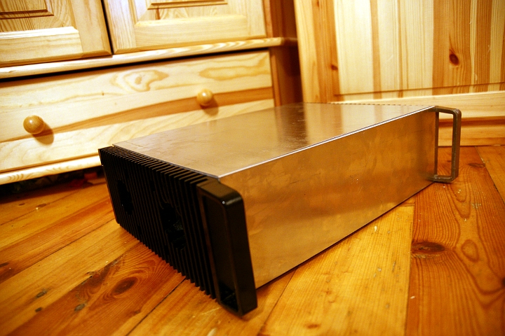

hello for all,
I started to worry (little) about my heatsink size for F5 when looking at these large on pictures above . Your opinion on my radiators- ? The size is 12x5x1 inches or 29x12x2,5 in cm. will be fine ? enclosure is almost finished and PCB also etched and soldered.:( My enclosure in attachment.
Thanks and regards.
Official Court Jester
Joined 2003
hello for all,
Thanks and regards.
it will be OK ;
one mistake - you must ventilate that box ;
you need some holes on bottom and top plate , or you'll cook all caps and blablah .
doesn't matter what size heatsinks are , air is a must for electronic in this case
