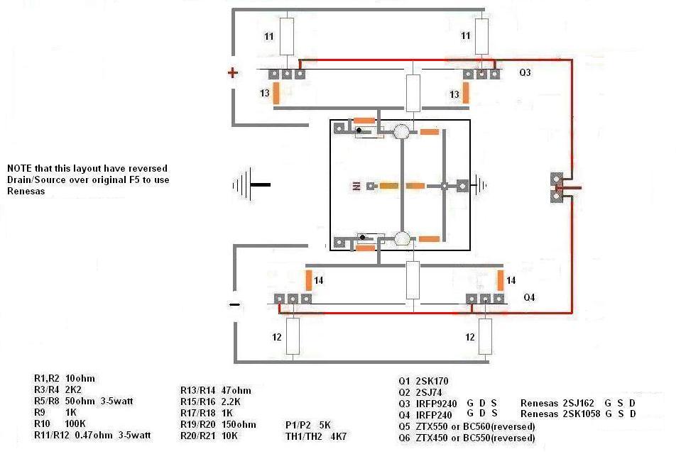

I hope its ok

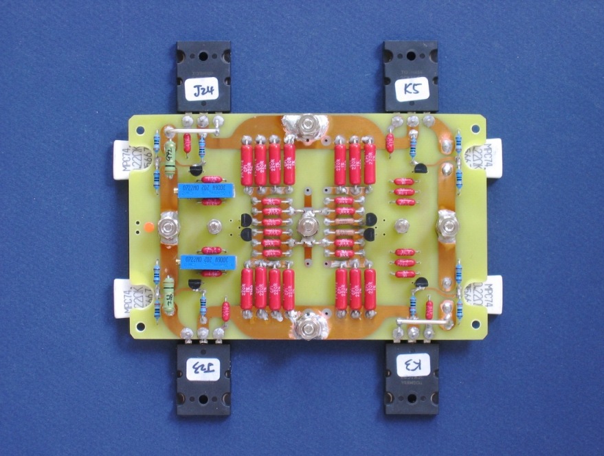

Hitachi Laterals w/F5
One channel of the Hitachi/F5 has been up and running since this afternoon.
Circuit same as F5 only with 2sk134 & 2sj49.
Biased up very easily to 1.24amps and >1mv offset which has not varied over a four hour period.
Taking this short break before heading back to wire in the +-G to the second channel.
Playing a Philips CD80 single crown dac w/ mod'd op amp outputs. BUF03 for the output buffer, I think the I/V is done with an AD797 if I recall. Running directly into the F5/H as the CD80 has variable outputs. Playing thru an old Maggie II.
I've got the mosfets on the paddle-wheel heatsink from the Old Colony Borbely B60 kit. I'm surprised it's running as cool as it is!
If this sounds good and behaves I'll switch the outputs over to the DC100's
which has three pair 2sj56/2sk176 per channel.😀

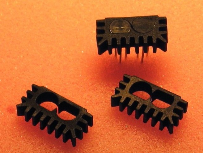

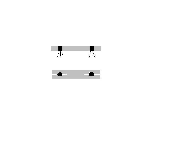

No, because the JFET die (actual semiconductor) in a TO92 package is at least 2mm away from any external surface of the encapsulation. You can calculate for yourself how much capacitance you might get with 2mm of insulation (the black encapsulation epoxy of the TO92 case).
Patrick

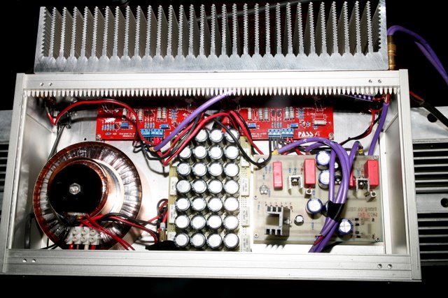

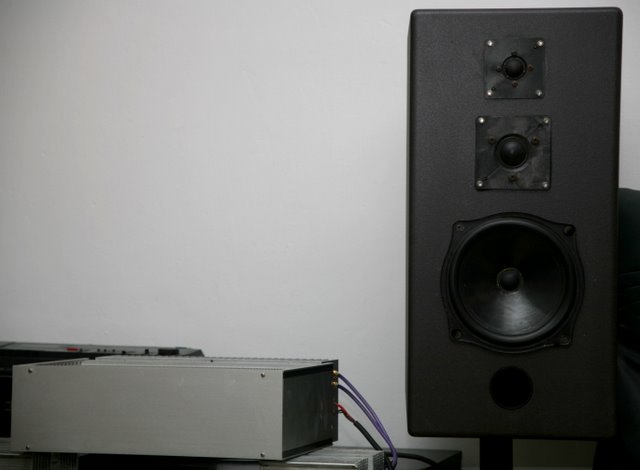

F 5 is working 🙂 thank you Mr.nelson for sharing your knowlege.First impression if i compare with phase linear 700b -warmer sound,lower bass,20 w is more than enough for normal listening.
