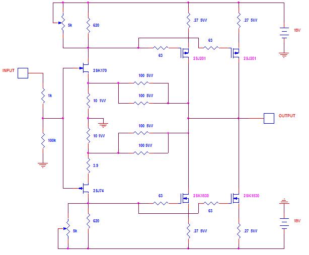

A while back while I cut and pasted from the 'main' F5 thread a post from NP regarding using dual (paralleled) Toshibas:snip....So far my changes are: 19V rails rather than the stock 24V, Dual output Toshiba FETs with .27 ohm Source Rs. in the output. ....snip
(about the Toshiba 2SJ201 and 2SK1530) NP 6408:
"Judging by the curves on those parts, when paralleling them
you can raise the Source resistor to 1 ohm and get greater
thermal stability yet."
But here you are suggesting 0R27 as output source Rs (R11, R12, R111, R112)? How is this value determined? Stock F5 has R11 and R12 as 0R47....

...But here you are suggesting 0R27 as output source Rs (R11, R12, R111, R112)? How is this value determined? Stock F5 has R11 and R12 as 0R47....
Some of what I am doing will lower the gain in the output and even the input stages. Driving 2 ohm loads causes a loss of gain by a factor of 4 over an 8 ohm load. Lower Rs will give me approximately 20-25% more gain than using the .47 ohm Rs. They would not be as much of an aid to thermal stabalization at this lower value. But, I would be recouping some of the gain losses.
So you plan on running .27 instead of .47 for the source resistors for a gain increase? why only 19V since you are doing cvilliers boards?
Higher biasing is acheivable with lower Vds. Only driving a 2 ohm load you don't need lots of voltage.

Having said that, I did a little Pspice over the weekend and found the Low Z F5 version (19V rails and Dual Outputs) to be producing an OLG of about 233 vs. 333 for the std. F5. Source Rs of about 0R22 would raise the gain to about 255.
I'm going to procede with the build as in the schematic above.

Yes I was talking 7 pairs. 7x150pF (roughly 1050pF depending on Vds) is less than 1400pF (which is below 2x2sk1530).
At 286mA each (for total of 2A) transconductance is around 0.7S. 7 x 0.7 = 4.9S
For comparison 2 x 2sk1530 biased at 1A each (2A total) gives a total transconductance of about 4S, with Ciss of 2x950pF = 1900pF
I am still not sure what you are talking about regarding miller capacitance issues. If you can explain that It would be appreciated.
