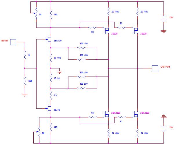

Speaking of different.
How about this one?
Edit: I was too lazy to add the gate resistors

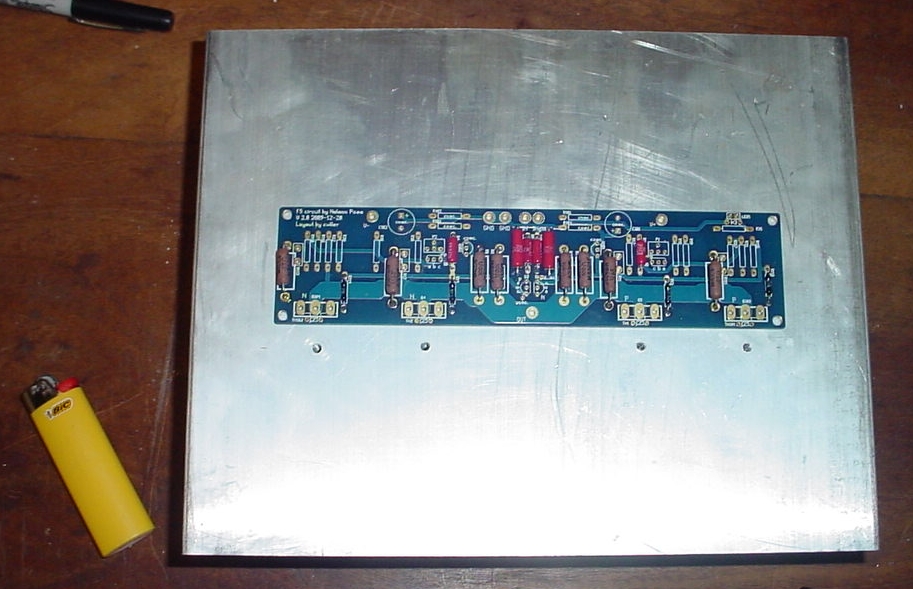

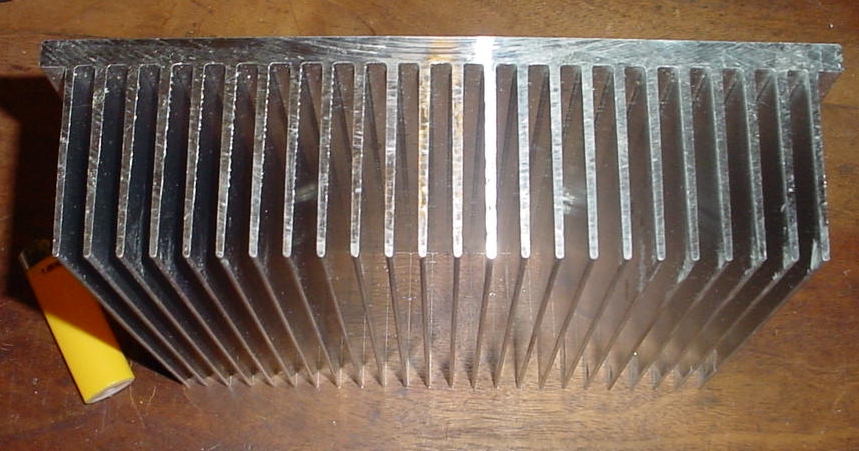

So, where was I... A few pics are in order. 😀 I actually thought I would be raising more questions too? Once I decided to change the output configuration, I'm opening somewhat of a can of worms with the sound and the original design. It's difficult to judge How much things will change the sound or where I should be correcting for the changes. So far my changes are: 19V rails rather than the stock 24V, Dual output Toshiba FETs with .27 ohm Source Rs. in the output. And, the low Vgsth of the Toshiba's will require a smaller Drain R in the input stage to maintain the correct bias, I'll go with 620 ohms for now and stay with the 5k pot. With the lower Vds on the output transistors, I should be able to up the bias beyond the 1.3A stock value (2x of coarse) maybe as high as 1.6A/FET.
Lets see, 1st pic is a H.S. from HeatSink USA. 10.08" x 8" (200mm) section. This should be good for around .35C/W but we'll see. Bias is adjustable to optimize for available dissapation.
Second pic is the back of the H.S. with the mostly stuffed CViller board set up for dual outputs. FET holes are drilled and tapped, just gotta do some board mounting and H.S. mounting holes.

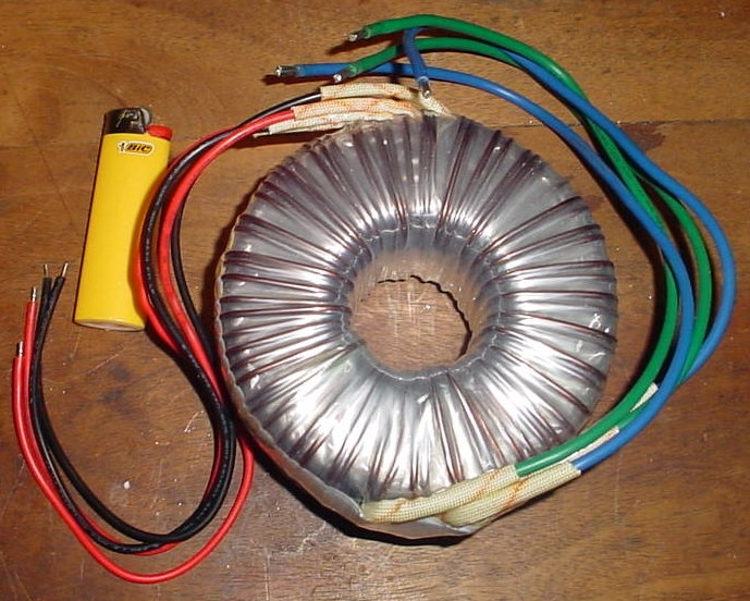

Last pic is 1 of the Antek 400VA 2X15 transformer(1/ch).

3 pr's with the standard front end or with cascoded front end ? ..

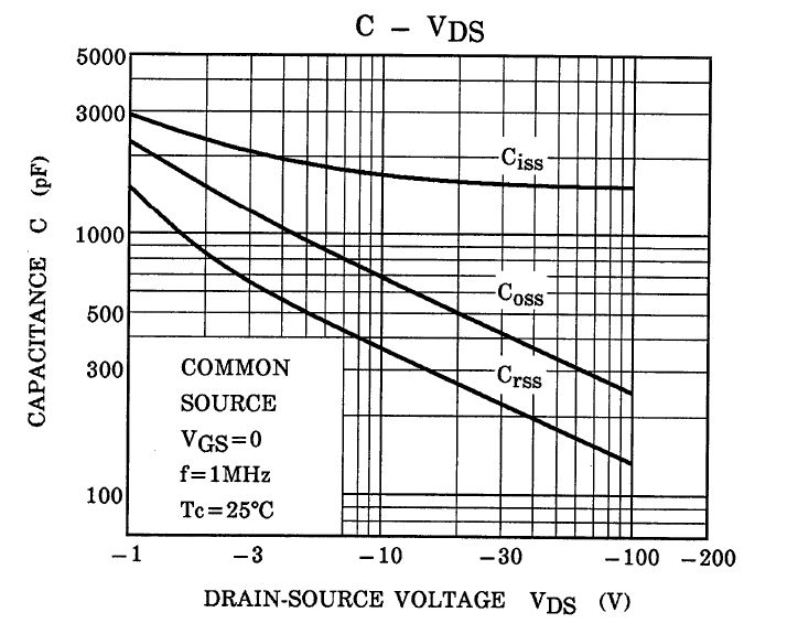

Well, because of the loss of gain by a factor of 4 in the output stage, when driving 2 ohms, 2 pair is necessary. Smaller Source Rs will help to a small degree. But, 3 pair would probably regain a similar gain figure to the stock F5. I'm willing to go the easy route for now. The CViller board is set-up for 2 pair of outputs.

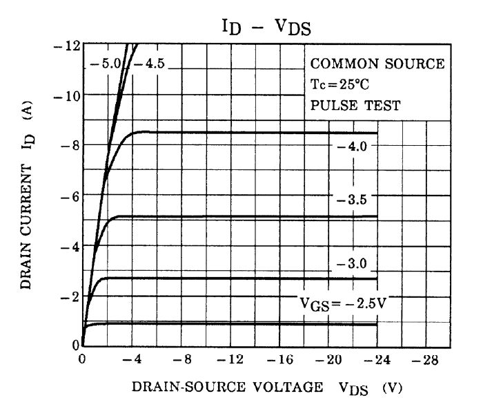

As far as power, my goal was to drive 2 ohms relatively well. At 1.3A/FET, I should be getting over 25Wrms max output into 2 ohms. At 1.6A/FET, I'm doing over 40Wrms. On a speaker with over 100db efficiency that's more than I'll need.

Both standard and cascoded. However I used IRFP devices.
