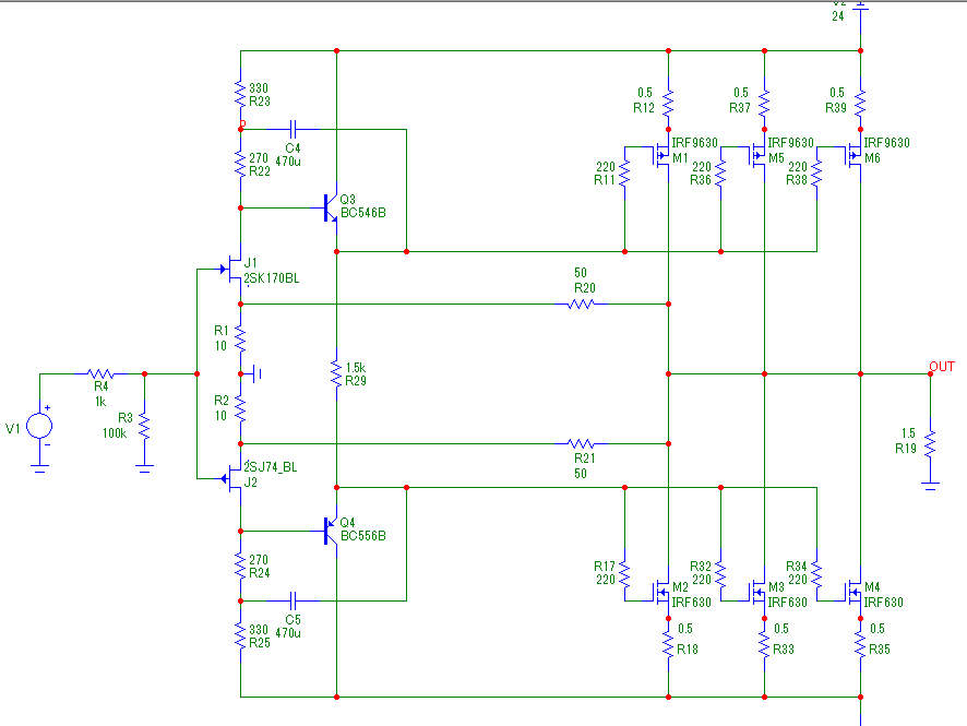

Output device dissapation will be the limiting factor in how high a bias current I can get away with. If like N.P. I limit myself to close to 30W per output device, at 19V rails I can run about 1.6A. If I'm running dual output pairs that's 3.2A Iq. This gives me close to 6.4A peak output current before leaving classA operation. That would be about 13Vpk(26Vpk-pk) or 40Wrms into 2 ohms.
All this is also dependant on having enough heat sink or intestinal fortitude to dissapate 120W without burning the outputs. Running 2 pair of outputs is also going to increase the open loop gain of the stage. This leaves the feedback open to tweaking a little possibly. I intend to use Toshiba devices which are said to be slightly lower gain but, I would still expect a factor of 1.5 increase in output stage gain with this configuration. Toshiba's are also said to be more linear which although sounds good, will effect the "sound" of the amp. Also, driving 2 pair of outputs with the same front end may raise issues. We may loose some top end extention? Hmmmm?
:Pawprint:
Wow, I guess I'll be needing that extra gain. My boards are stuffed with .27 ohm Source resistors in the output. Another oportunity to regain some gain? :eek:
The solution could be the schematic I posted, input stage is buffered so OL gain i higher (even without the bootstrap caps). Buffer also isolates high parasitic cap. of two output pairs working with lower rail voltages... Making PCB for this kind of amplifier it`s pretty easy and you could try point to point also.
With bootstraping you have higher OL gain and more feedback so you could easily tweak it and see what sounds better. ;)
