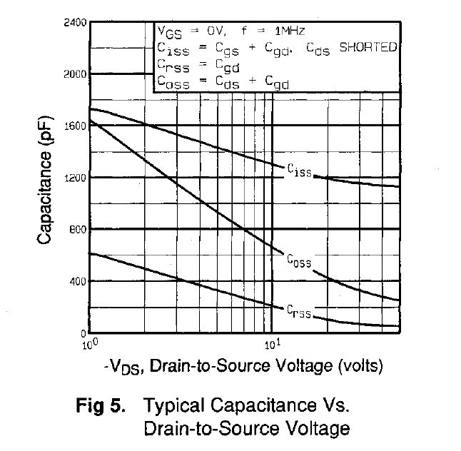

Well, that's kinda where I'm coming from also. At one watt the Cs are resonable but getting closer to the rail the C numbers start getting serious. Comparing IR devices to Toshiba's do you think the C curves are much different? The Tosh parts obviously have some different internal sructure going on.

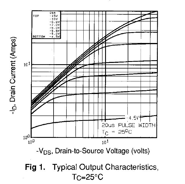

I've just got one more thing to say. for the last 3 years I have been doing some MOSFET testing that ends up on datasheets or verifies the data already on them, for one of the mfgs where talking about. At least once a week my manager says "data sheets lie!".
For the sake of completeness, C vs Vds for IRFP9240.
There is no reason for them to publish wrong curves.
The lie is sometimes in under what conditions figures (like Yfs or Ciss) are specified.

Using my eyes, as a percentage change, say from 20-10Vds they look very similar. And not as rediculous as is sometime depicted.
So, a 16V rail, as you have chosen, does seem quite viable.

This is true. We certainly are not intentenally doing such things. Some of it also has to do with production/process variance etc. Personally I get a kick out of the Vgsth 2-5V? Give me a brake. But, it is not exactly a targeted parameter in the process. I have not seen such a wide spread in the products or parameters I've worked with.
