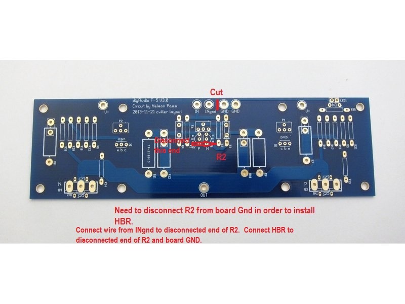

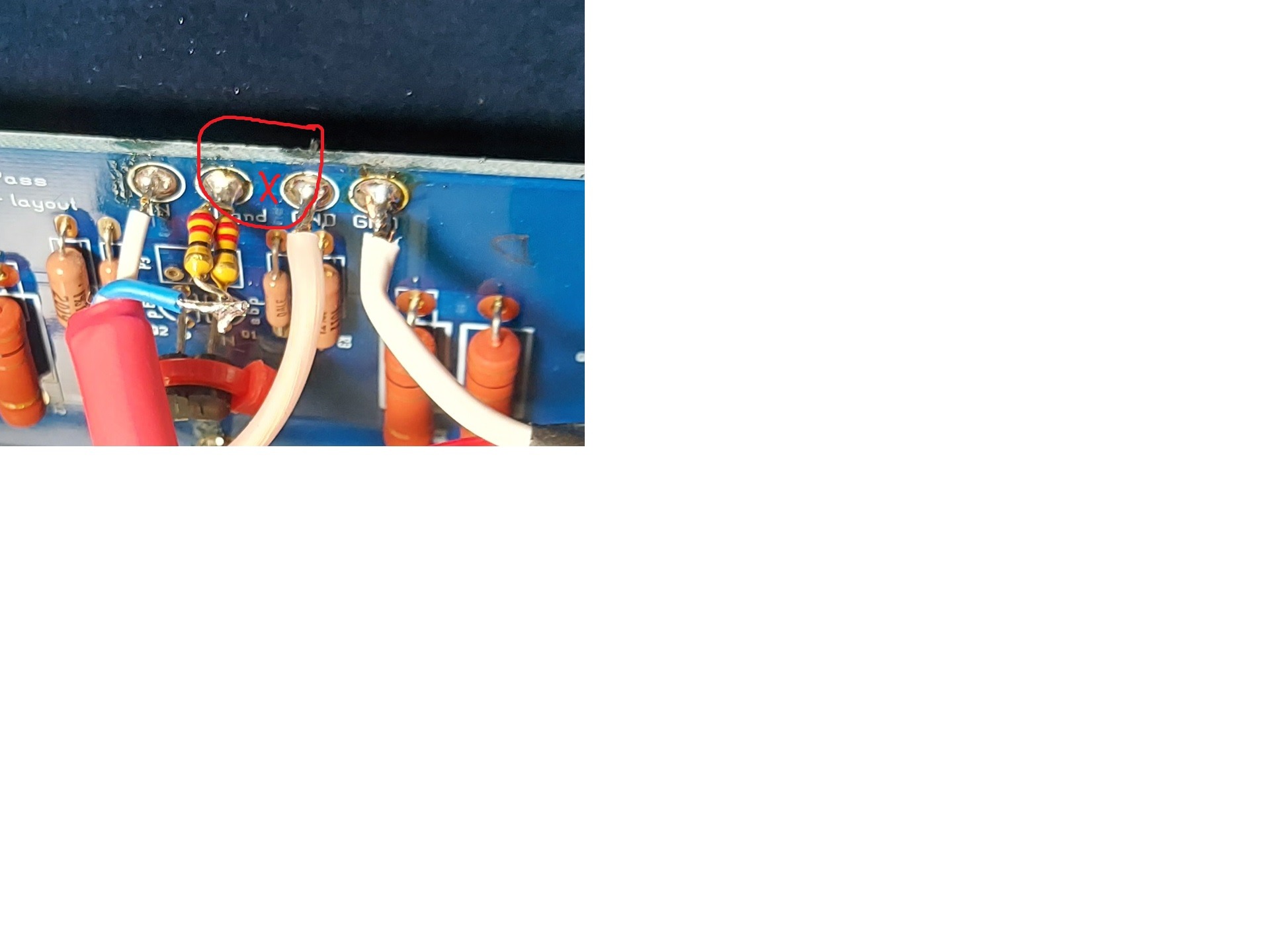

i can lift the legs of R2, R3 and R4 and connect those in the air with HBR that will go to power supply ground and on that connection point where HBR, R2, R3 and R4 meet together i can connect signal ground....
i am looking at pcbs... it seems to me that there is a single line connecting INgnd and GND... just in between them... maybe i just need to cut that line and put the resistor in between INgnd and GND and that will be it....
correct me if i am wrong but it seems that this would be the best to do....
I had another hard look at the picture of the pcb and I now see the connection of R2 to Ground. The easiest way to connect the HBR is to lift the ground end of R2 and connect there.
Also note that I edited my previous post to show the HBR connected to R2 only. I don't think the other ground needs to be lifted. At least try only R2 lifted and see if that works.

Alternatively, you could lift the ground end of R2, disconnect the INgnd wire from the INgnd pad on the board, solder the INground wire to the lifted ground end of R2, solder one end of the HBR to the ground end of R2 and solder the other end of the HBR to INgnd pad on the board. Then no cutting is needed.

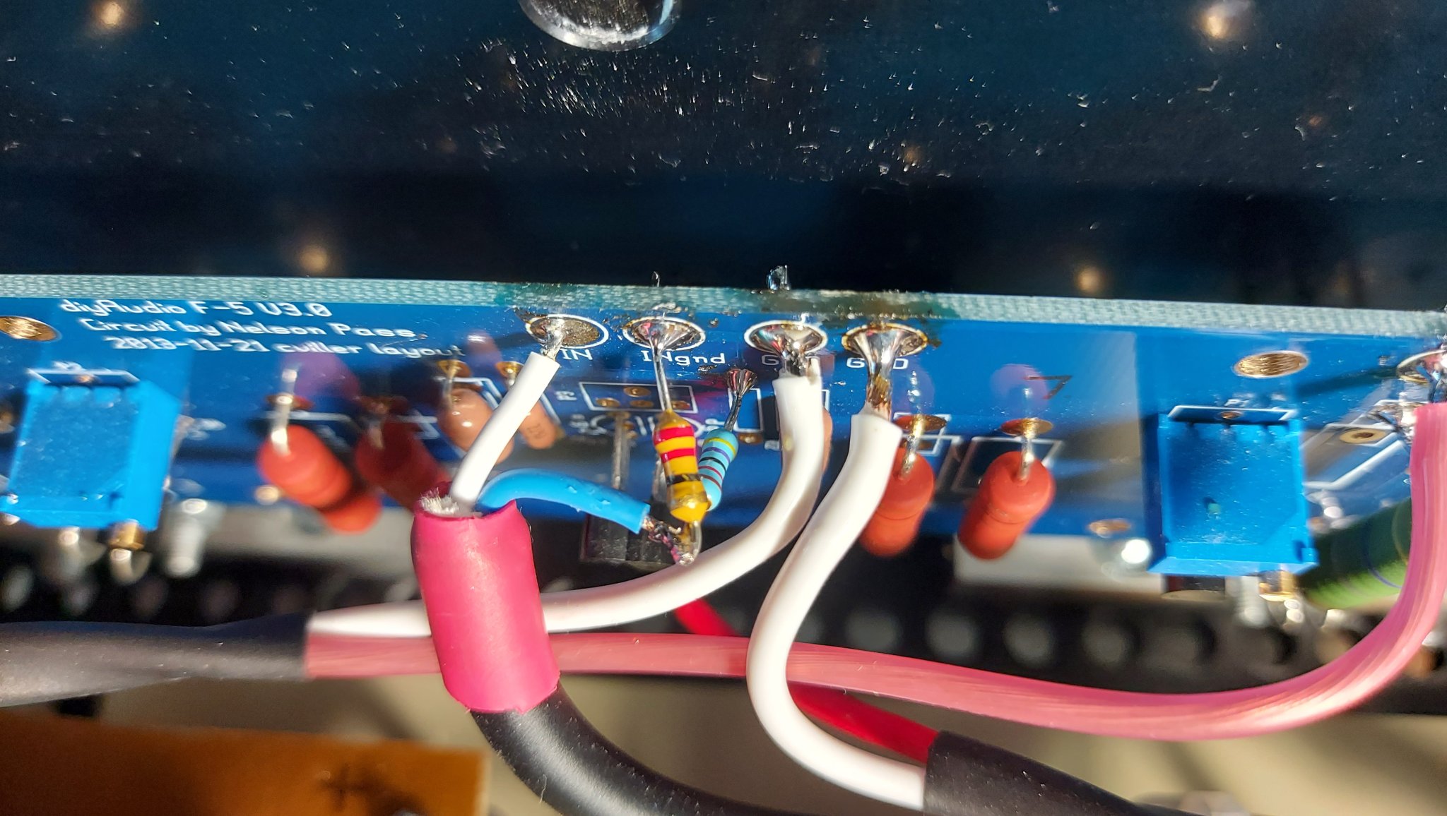

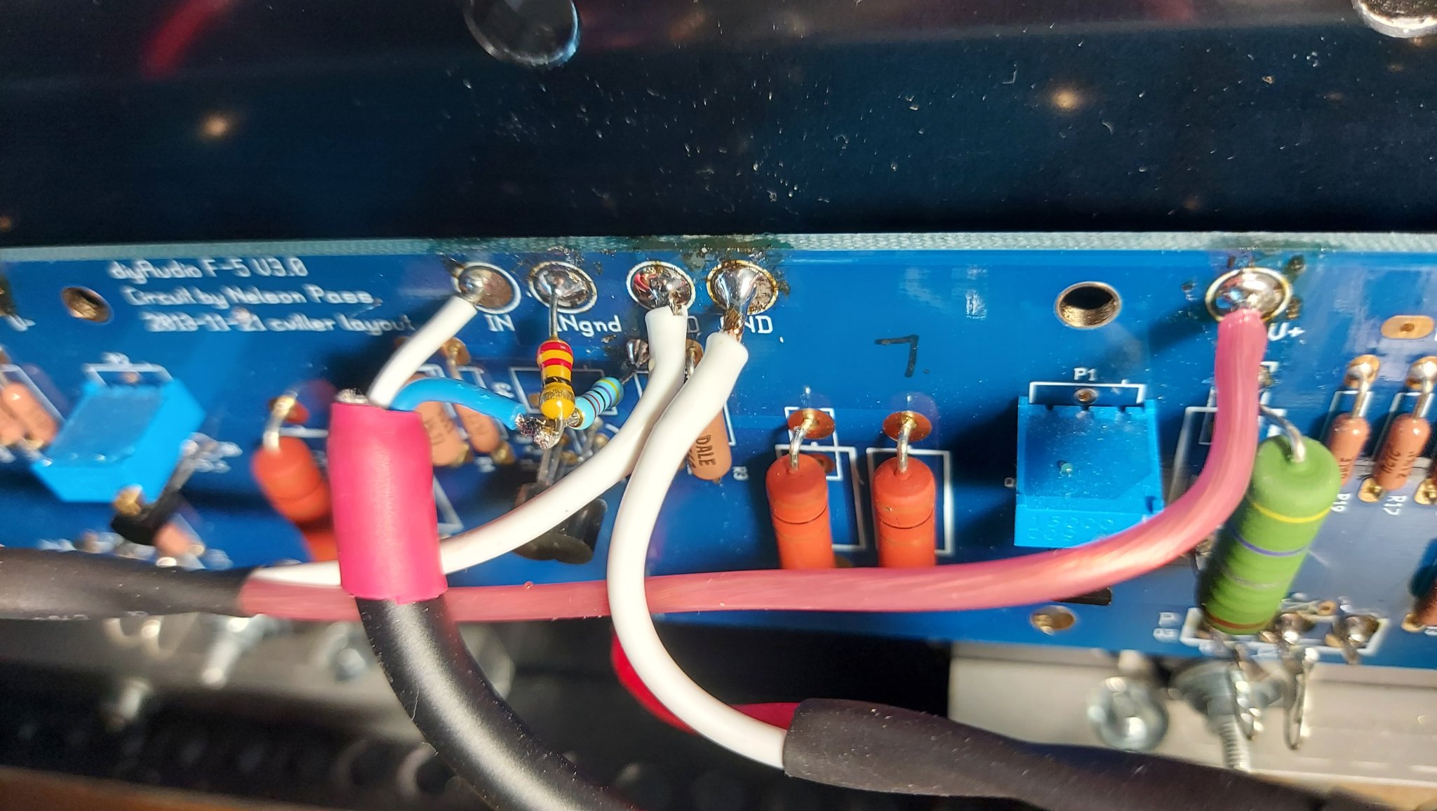

that is exactly what i did .... pic's included.... it is buzzing a bit more then it did before - and it added some lower end to the buzzing (maybe some hum)...
HBR is 22R and when i was removing R2 i broke one of them (room is tight there), so i had to replace both of them with some Vishay metal-film...
point is - it is stil buzzing and now a little bit more then before.... arrrghghghh 👽👽😱

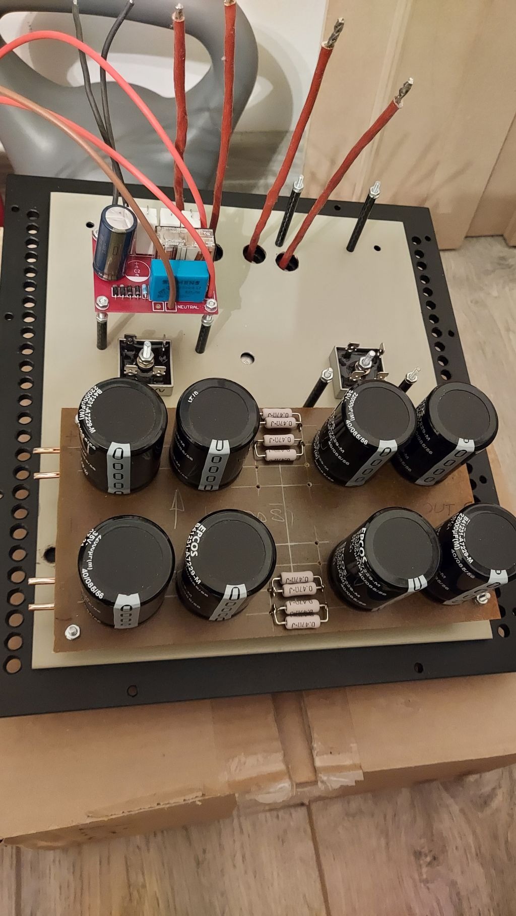

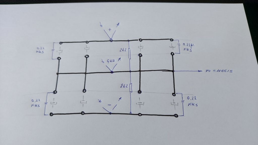

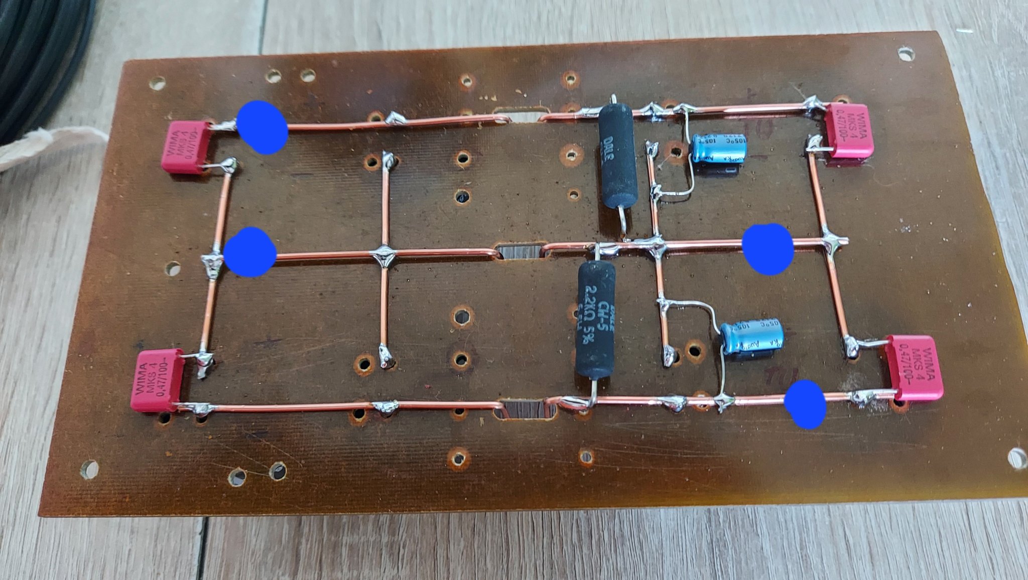

The challenge with class A amps is that they are at full power all the time which demands a very good PSU with low ripple.
I think you need to find out if the hum is caused by PSU ripple or it is magnetic coupled noise. It seems the amp hums all by itself without being connected to any source. I have found that just CRC filtering is not sufficient to get a "hum-free" amp. Toriods with magnetic shield is also a good thing. A smps in an external chassis with additional filtering in amp chassis works for me. Push-Pull amps should have very good PSU ripple cancellation and other seems to have built a "hum-free" F5 just using CRC filtering. Maybe other F5-builders could give some advices or show how they built their amps. They you maybe could copy this and start all over 🙂

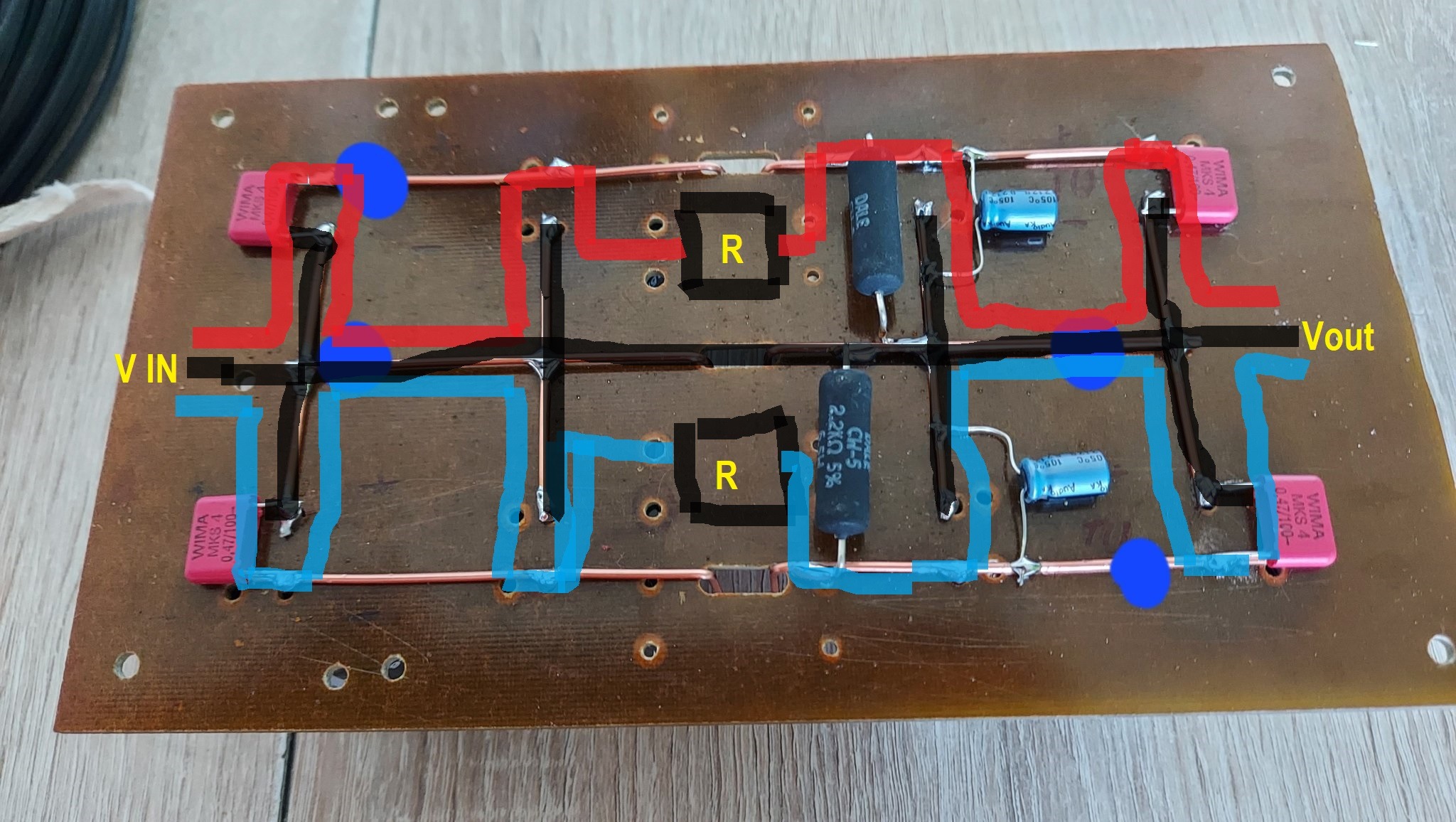

Looking at your picture and sketch, the layout probably contributed to the noise that you heard.
First I recommend re-installing the resistors to make the PS filter CRC. That will reduce the power supply ripple. With 108dB speaker, you need a low ripple power supply.
Second I recommend re-wiring the PS board to reduce the loop area. With 108dB speaker everything matters. Also the high ripple DC V+ V- Gnd from the bridge rectifiers should enter the PS filter at one end and the low ripple DC V+ V- Gnd should exit from the PS filter at the opposite end.
Please see the picture that I have marked up. The red, blue, and black lines are the V+ V- Gnd lines. The V+ and V- lines should be kept as close as possible to the Gnd line to minimize loop areas.

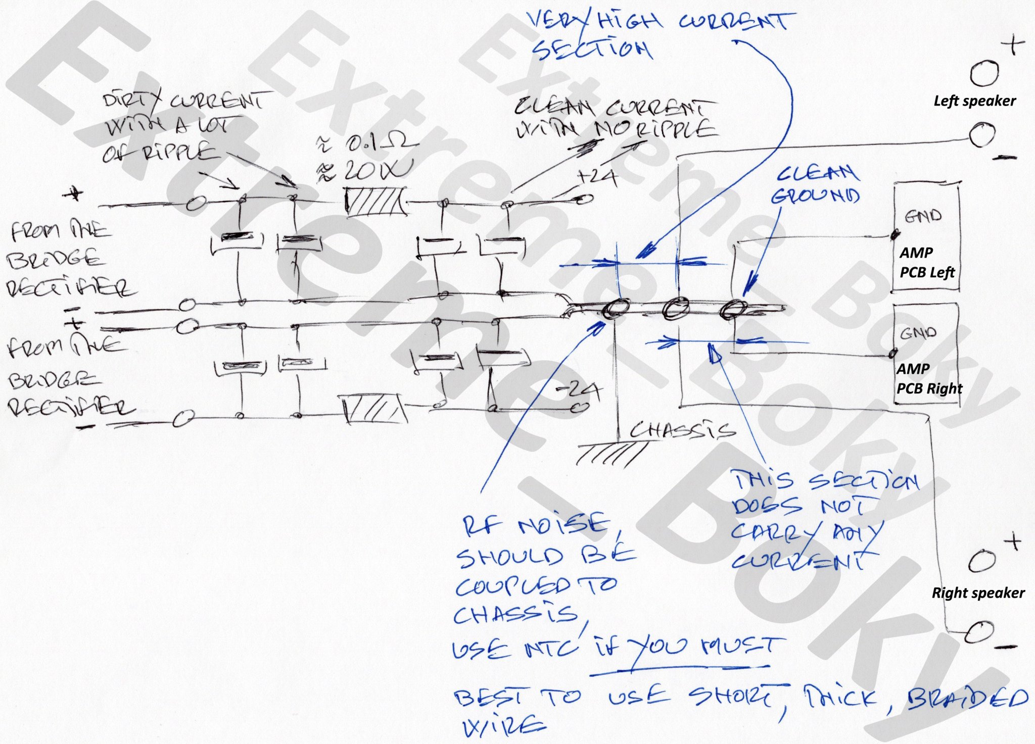

If the answer is: "to learn new things and try the real DIY nitty-gritty"... you should learn first about proper grounding, return currents segregation, RF noise, and coupling the noise to the ground.
Anyway, my intention is not to discourage you... here's the proper grounding. Enjoy...

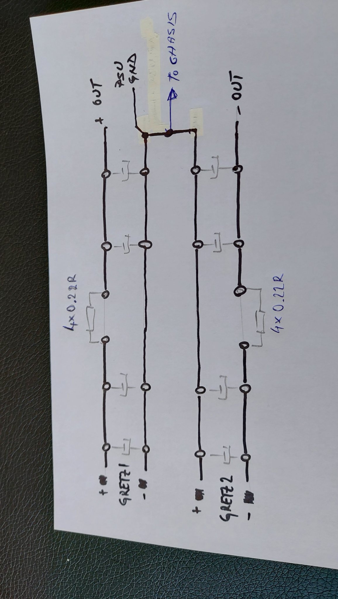

that is exactly how i did it first time but then the ground was closer and in a C shape... i have uploaded first version that i rewired now with a sketch how i wired everything... it was buzzing the same... only time i had more buzzin with some humming is now when i added that HDR....
