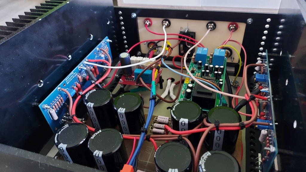

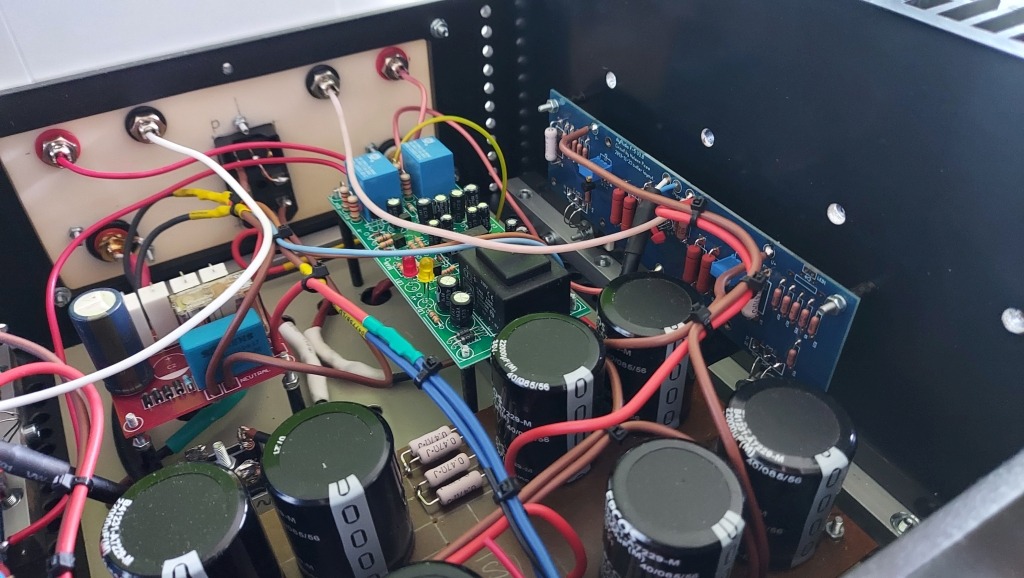

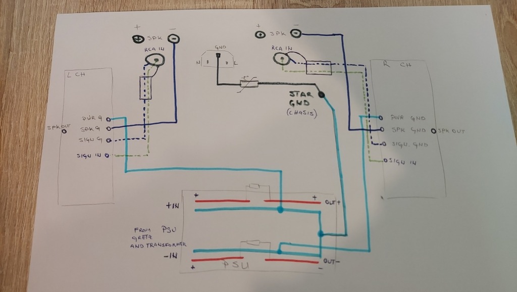

Found the thread and the lucky guy who removed the buzz:
HBR Cviller boards
So it is cutting 2 traces and adding a wire and a resistor. I didn't use the reverse diodes, was quiet even with the one resistor.
I wish you good luck, it is such a relief when finally there is silence. Although 108 dB speakers are really sensitive...
O.k.... so, i can happily say - no more buzz ... Amp is dead quiet.... literally dead quiet - when it is operating without signal you can't hear anything from my tweeters... no buzz, no hum........
I am 100% confident that, IN MY CASE, the problem was in cviller amplifier board at the input.... it can be solved by following instruction in the quote above - THANK YOU JOGI... you saved me .... (i used only resistor - no need for diodes - 4R7 resistor was enough)
what i will do now - i will shorten those input wires... no need to have 60cm of moderate quality input cable running inside the amplifier any longer.... as short as possible as always .... and that should be it i think....
thank you all for keeping up with me and for support and to @Jogi for his input that saved this project....!!!
