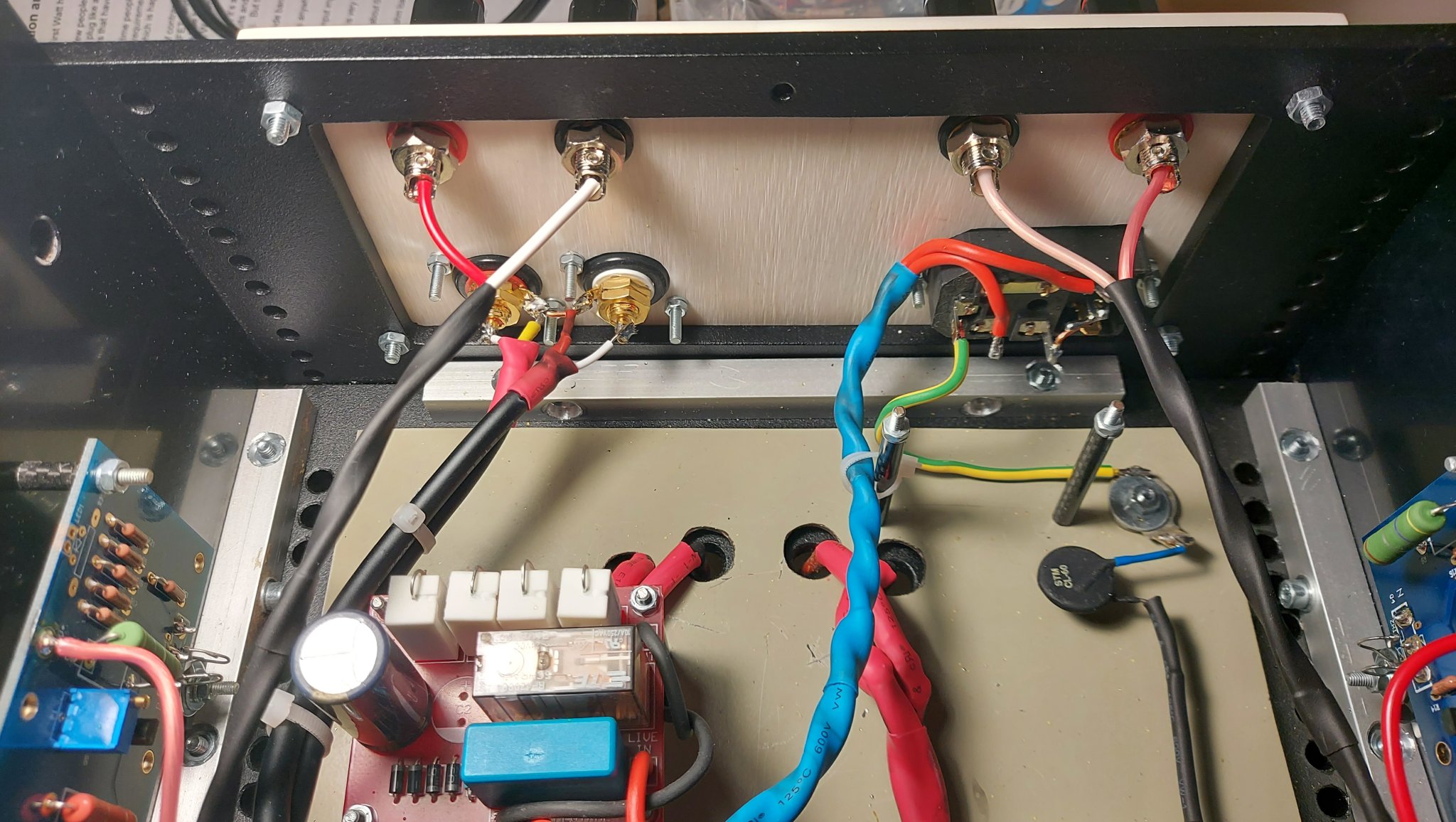

Than i reversed everything to how it is suposed to be by schematic and for some reason buzzing stopped in one channel... following that road i figured that even if i have input wires shielded, they were to close to power lines having AC rectified.... with over 2A of total current flowing there, it was more then enough to trigger my amp to buzz.... moving those input wires away from those power lines, reduced the buzz significantly....
Also, i figured that my interconnect between my dac/preamp and F5 is simply old and it's shielding is not firmly connected to rca jacks on one end and i had to resolder this ....

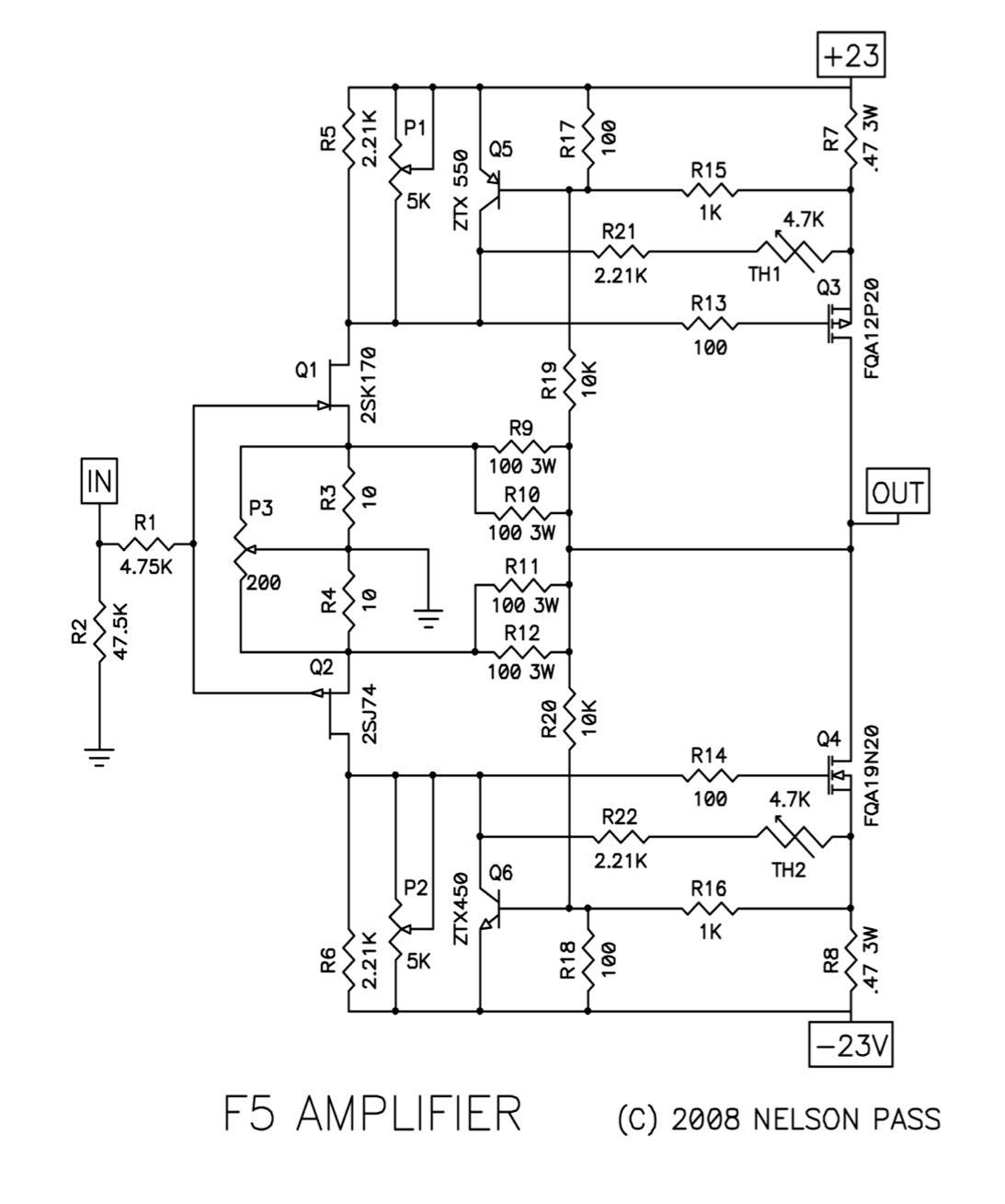

Since it is small now but enough to be heard from sitting position when everything is quiet - i am asking this - would lowering the input resistor to ground (47k now) to 10-15k do any good in lowering the buzzing even further?

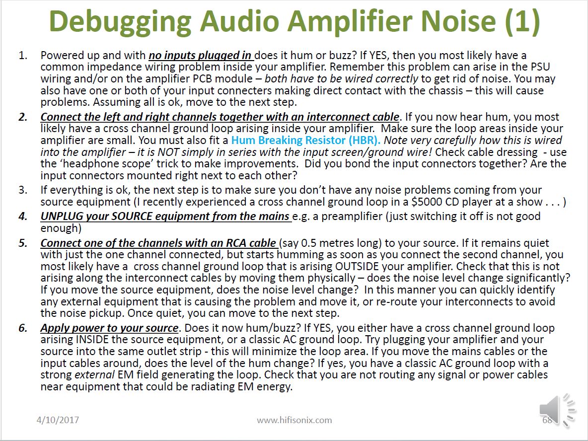

Have a look at diyAudio member Bonsai's article on amplfier noise and grounding. Some debugging information is near the end of the article on page 68. It seems you have a case of cross channel ground loop. You can test to see whether it is inside your amplifier or caused by your source.

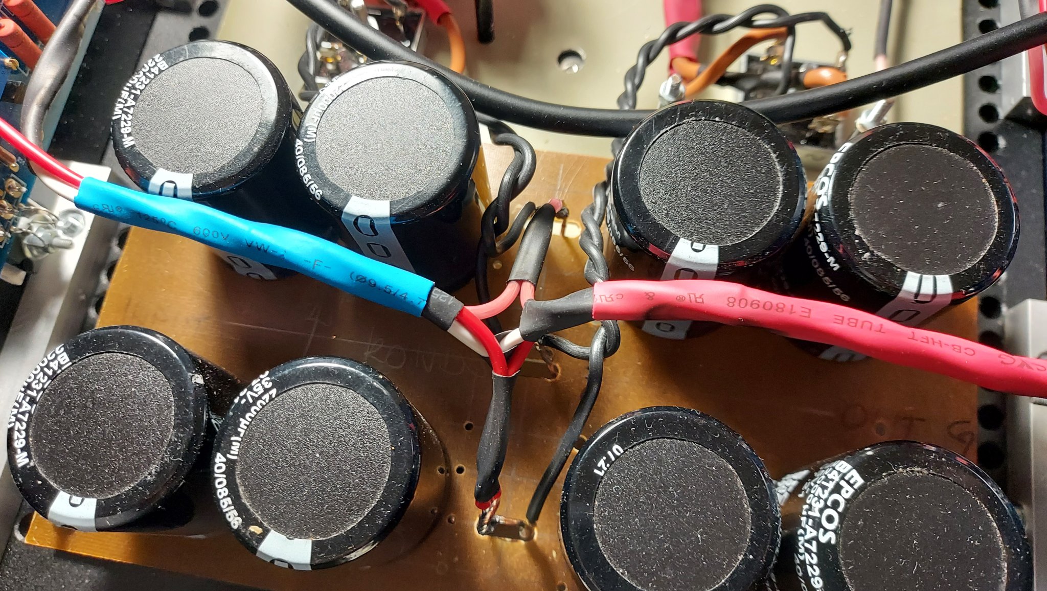

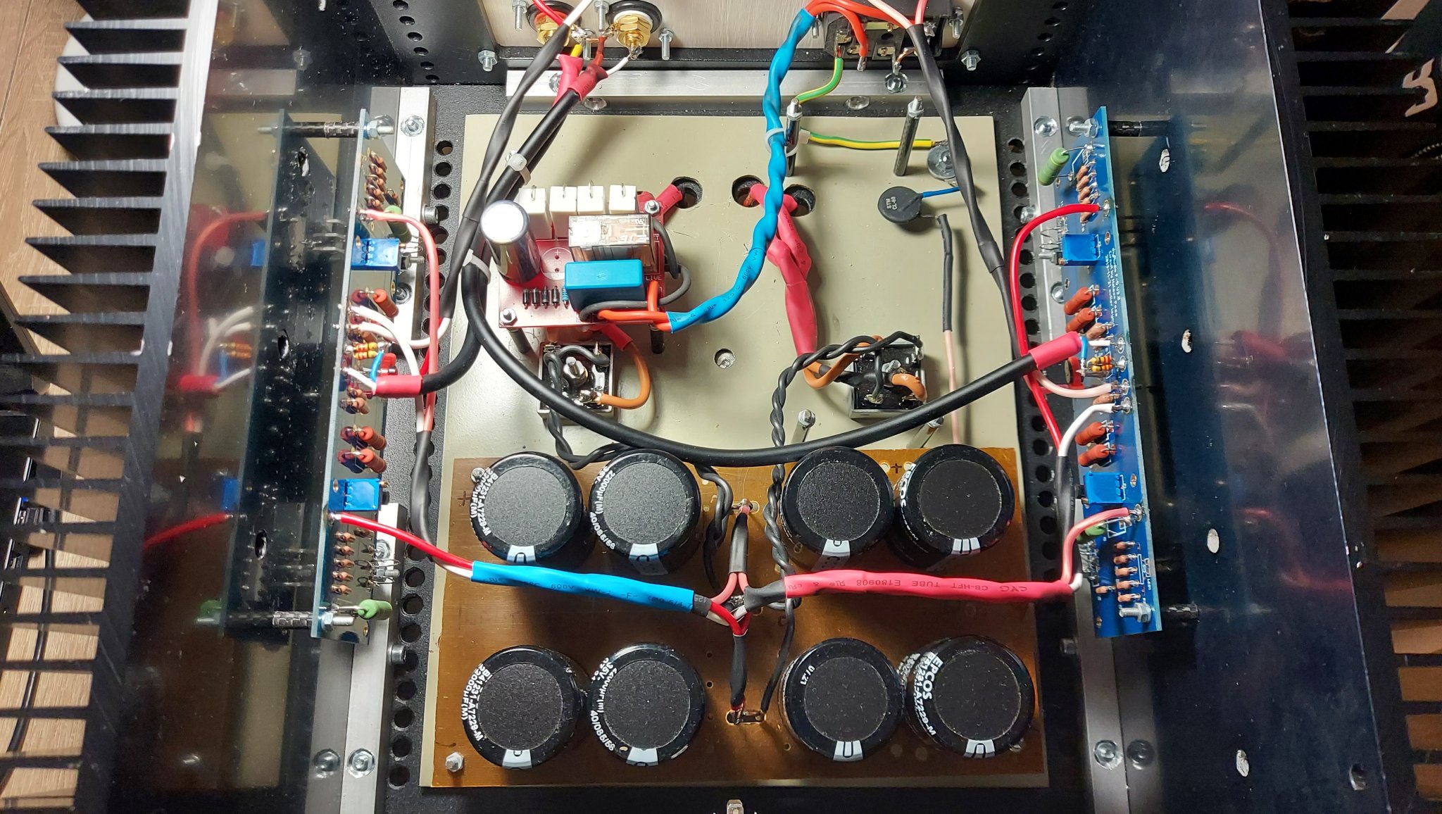

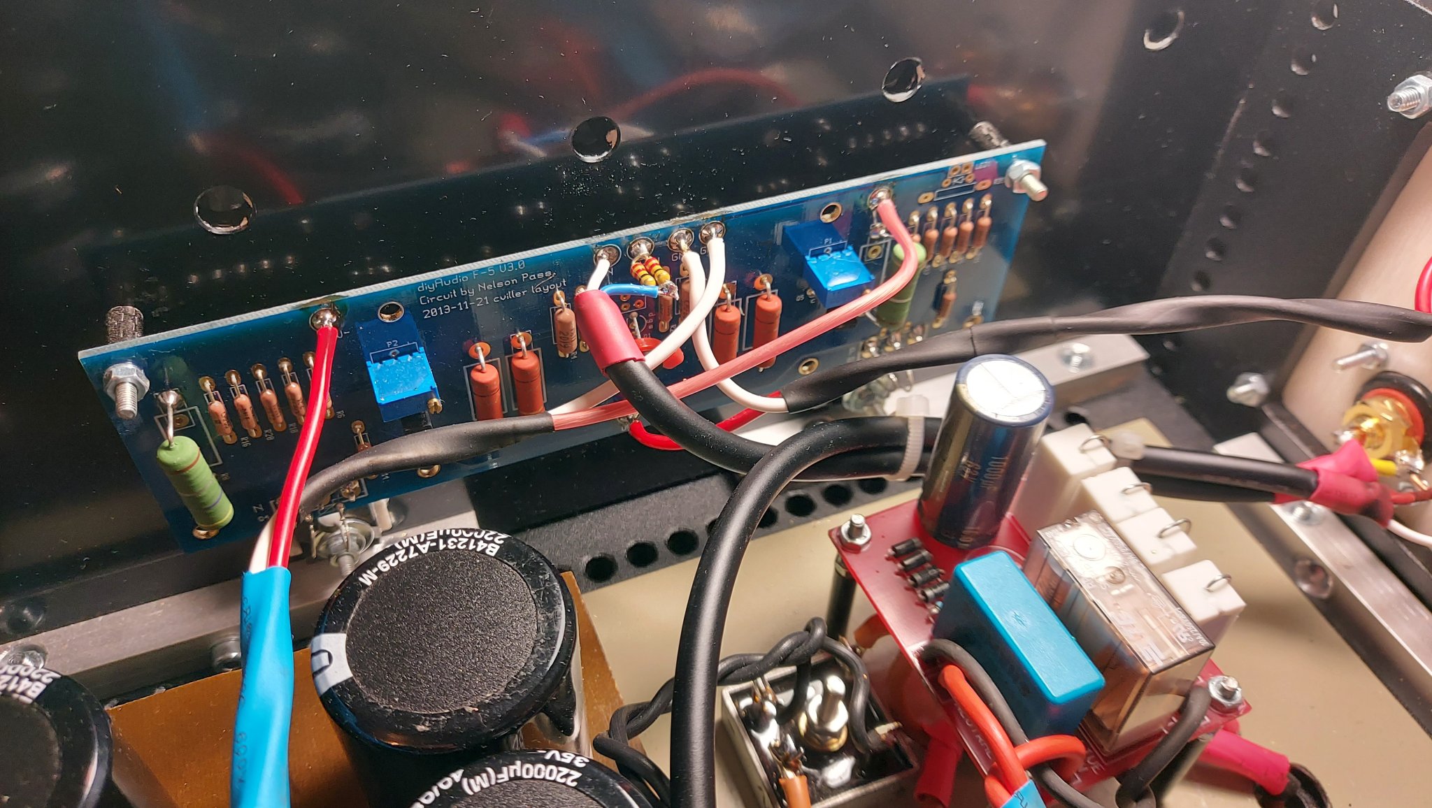

Removed the protection circuit completely and for the sake of having things a bit easier - i removed the resistors in power supply that form C-R-C filtration... I left only caps there and from that central point i hooked everything i had to connect there.....
So twisted everything, tried to minimize loops - IT IS BUZZING LIKE IT WAS BEFORE.....
so, now i really don't know what to do....

now - my tweeters are 108dB/w, mid's are around 95dB i think... maybe to lower the input impedance resistor to have something like 10-15kohm?

The R in the CRC filter should reduce noise, not cause noise, so it is best to put them back in. Also the centre of the power supply board is not best location for taking the power from the power supply. So I suggest putting the resistors back in and taking the power from the end of the board as designed.

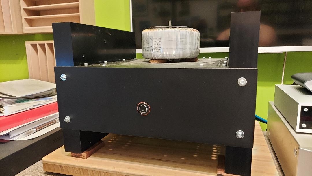

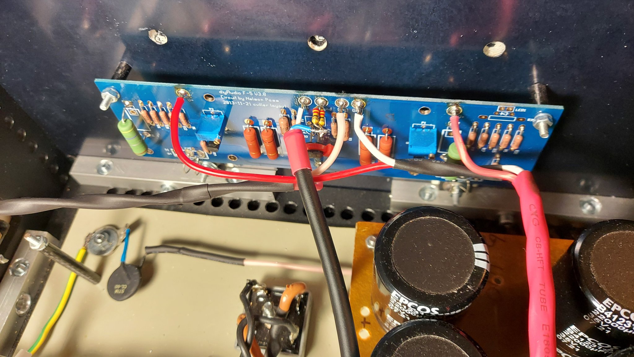

New pictures of your amplifier may be helpful in debugging. Include some overhead shots that show the whole amplifier.
Did you go through the Debugging procedure outlined in Bonsai's article?

I went through that debugging procedure and it is a proble with cross channel ground loop... that is why i used HBR resistors at the input of the board on signal ground... buzzing did not change in any way.
Also when i disconnect my dac/pre from mains power and have both channels connected between source and power amp, it is stil buzzing the minute i connect both channels.... when i have only one connected, it does not buzz at all....
so, according to that pdf, it is a problem outside of the amplifier (most likely)....
however, not one of the power amplifiers or integrated amplifiers i connected to my M2Tech Young DSD dac/pre did not buzz... only F5 is buzzing - so, i can hardly say that the problem is outside of the amplifier but probably inside - where is the question..... i don't know...
I also tried to use a passive preamp driving that F5 from a cd player from Marantz - it did not stop buzzing.... behaved the same way as with my dac/pre.... so, changing the source to a passive device and cd if front of that, does not do anything .... it buzz the minute i connect the second channel....
in between the transformer and electronics inside is 4mm aluminium black in color plate (on the outside and on the inside is the iron plate connected to the ground to shield the electronics from the transformer on top.... i even used the iron pot (used magnet to see if it is magnetic) and put over the transformer - the buzzing did not change at all....

It looks like the ground from the input jack goes through paralleled 22 ohm resistors to the board. Do you have a ground lift resistor between the power supply ground and the chassis which is connected to the mains ground. That's where the ground lift should be.
Since the underside of the power supply filter board is not visible, I do not know whether there are issues there or not. A picture or drawing of the wiring of the power supply board would be informative.

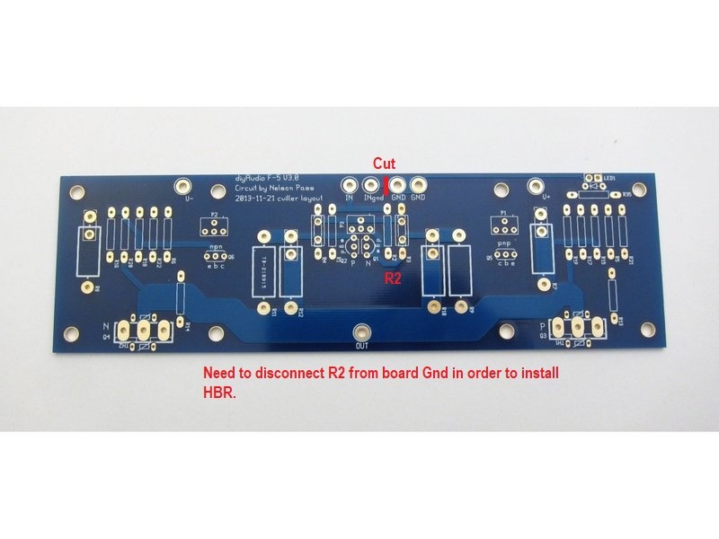

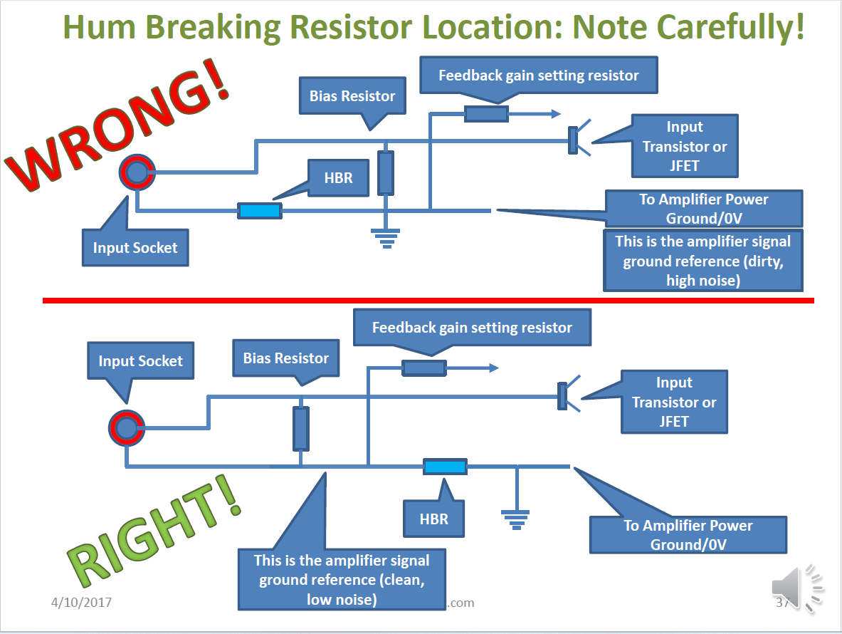

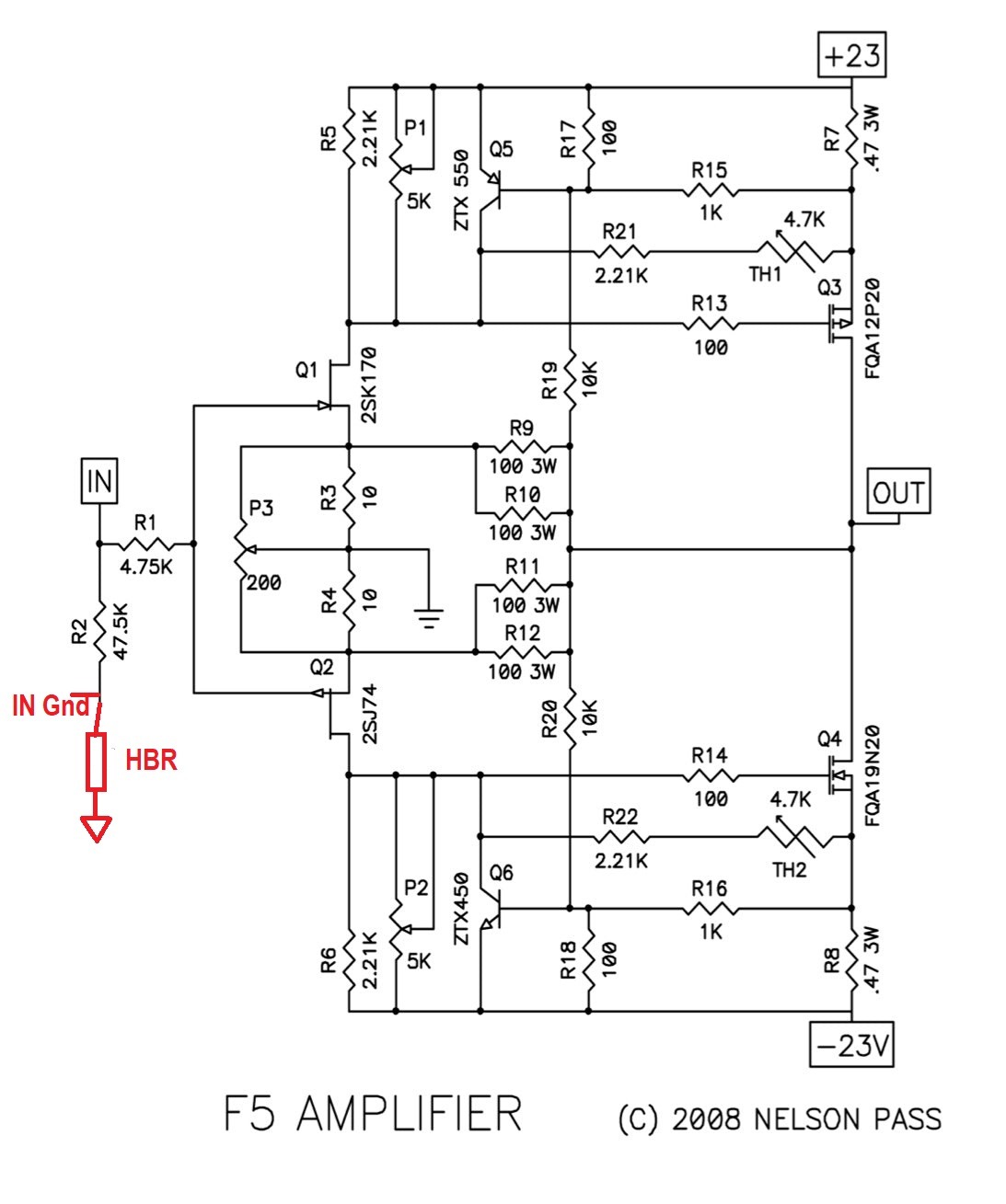

It looks like you placed the HBR at the INground input of the amplifier board. That is not the correct location. The ground of the input circuitry on the board needs to be isolated from the power supply ground on the amplifier board. Traces need to be cut to accomplish that. I also could not tell from the photos of the pcb that I found on the web how resistor R2 is connected to ground, but that connection needs to be undone in order to install the HBR.
I do not have a F5 so I have no personal experience with F5 hum. I have 103dB speakers (not quite 108dB) so I do have experience in building quiet audio components. This is my take on Bonsai's HBR implementation.
Edit: revised HBR scheme
from what i understand NTC is doing that like on the schematic of the F5 power supply... you can see it on the last picture i posted ...
