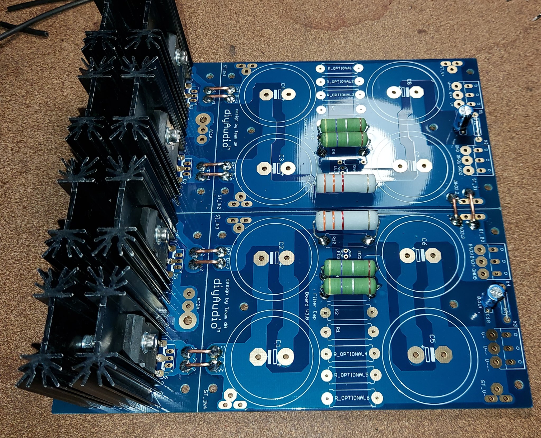

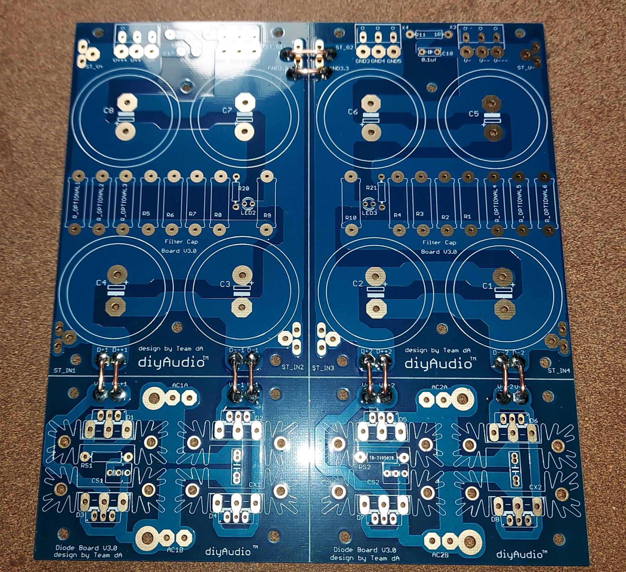

O.k.... started to assemble the new psu board... will use FEP30DP diodes and i plan to connect the central ground only at the output like on a pictire attached.....ST_IN2 and ST_IN3 will remain separated..... RIGHT??

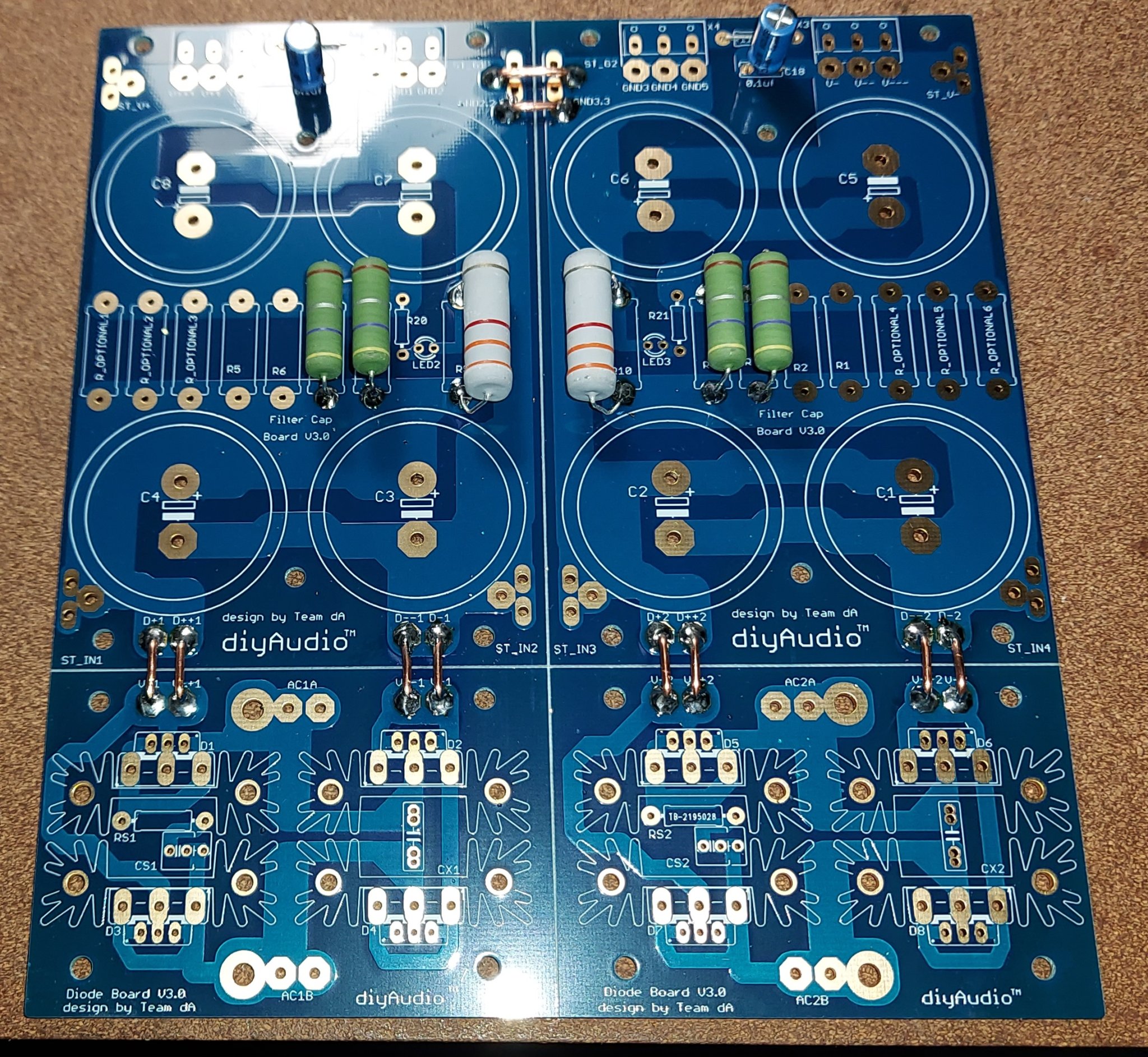

Well, i really hoped 0R47/5w resistors will arrive today... they did not so i am kind of stuck for now with what i did shown bellow... with this hot weather, i have an excuse to actually rest...
Can't move forward because i need to install those 4 pieces of 0R47 missing.... the small cap's at the end are 100uF caps (i bypassed R12 and R11 and installed them in place of C17 and C18).....
