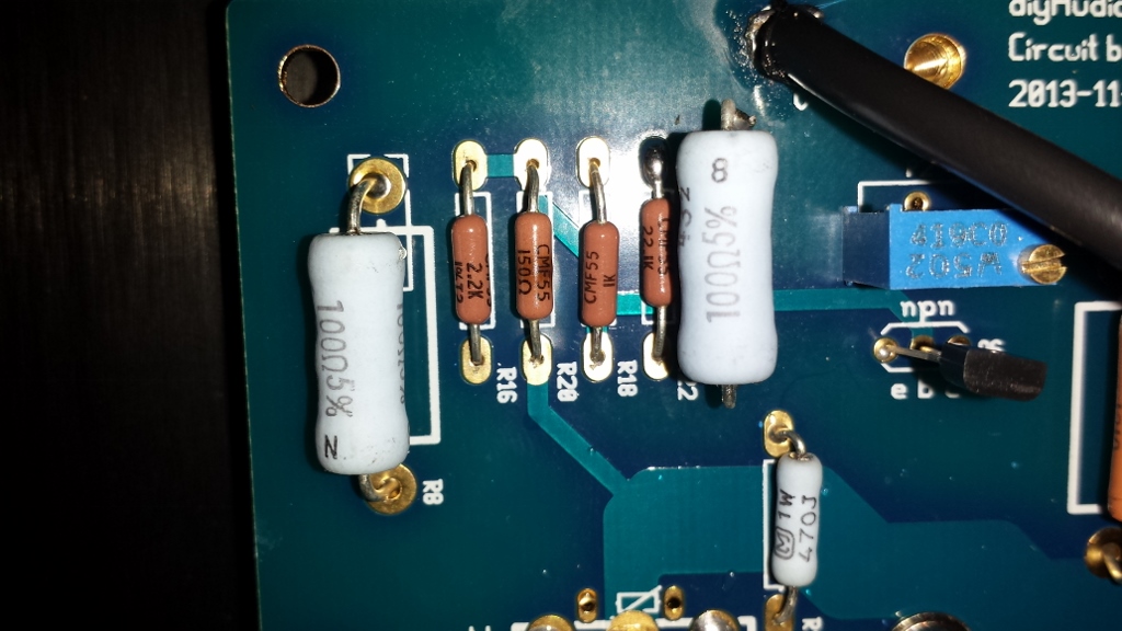

I started building my F5.. Power supply tested good. So I fired on with a dim bulb attached. The bulb lit for a second or 2 and dimmed completely but I saw some smoke coming out of R19 and R20... Here is a picture where you see R20 discolored :eek: ... any advice before I do more damage:D
Edit: One channel attached, I have not yet assembled the other board. The short ti,e it was up, I read 0V across R11 R12

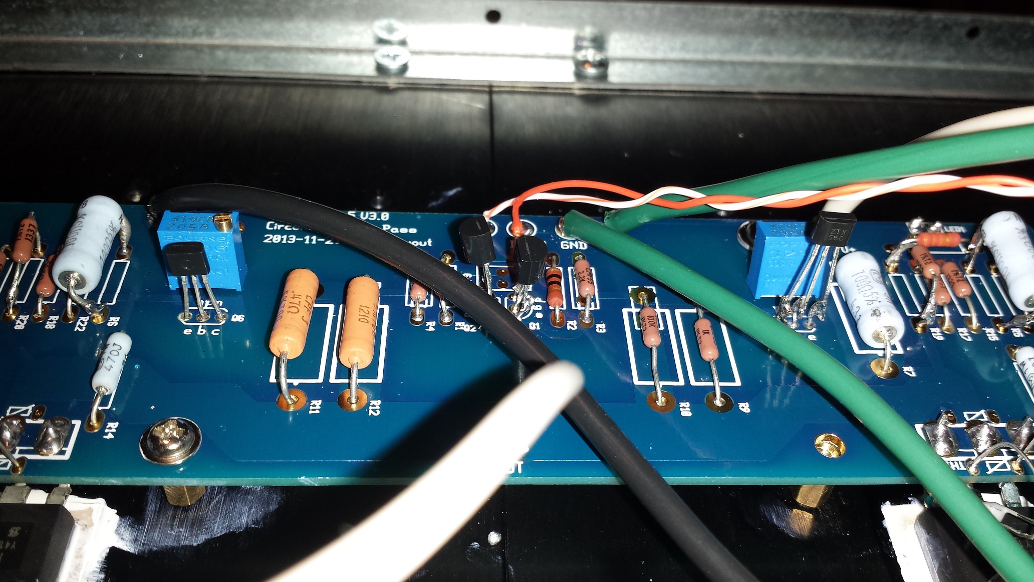

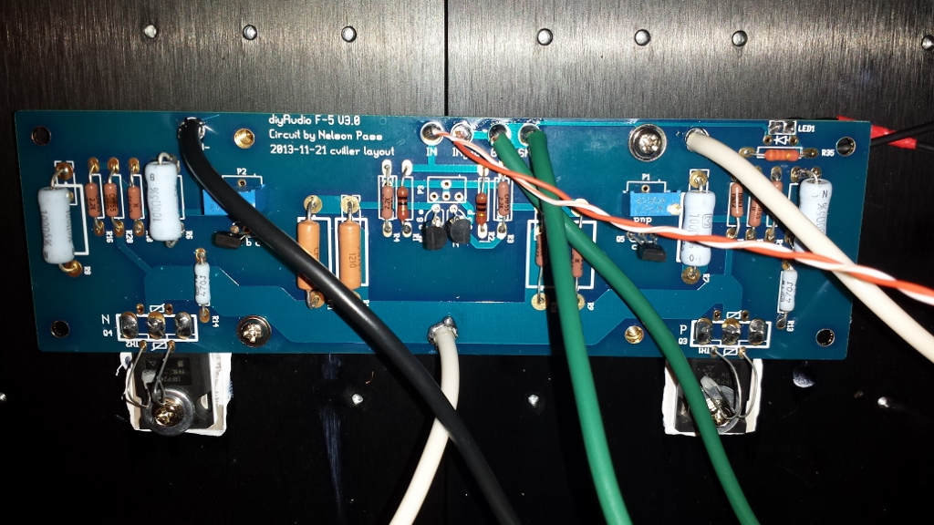

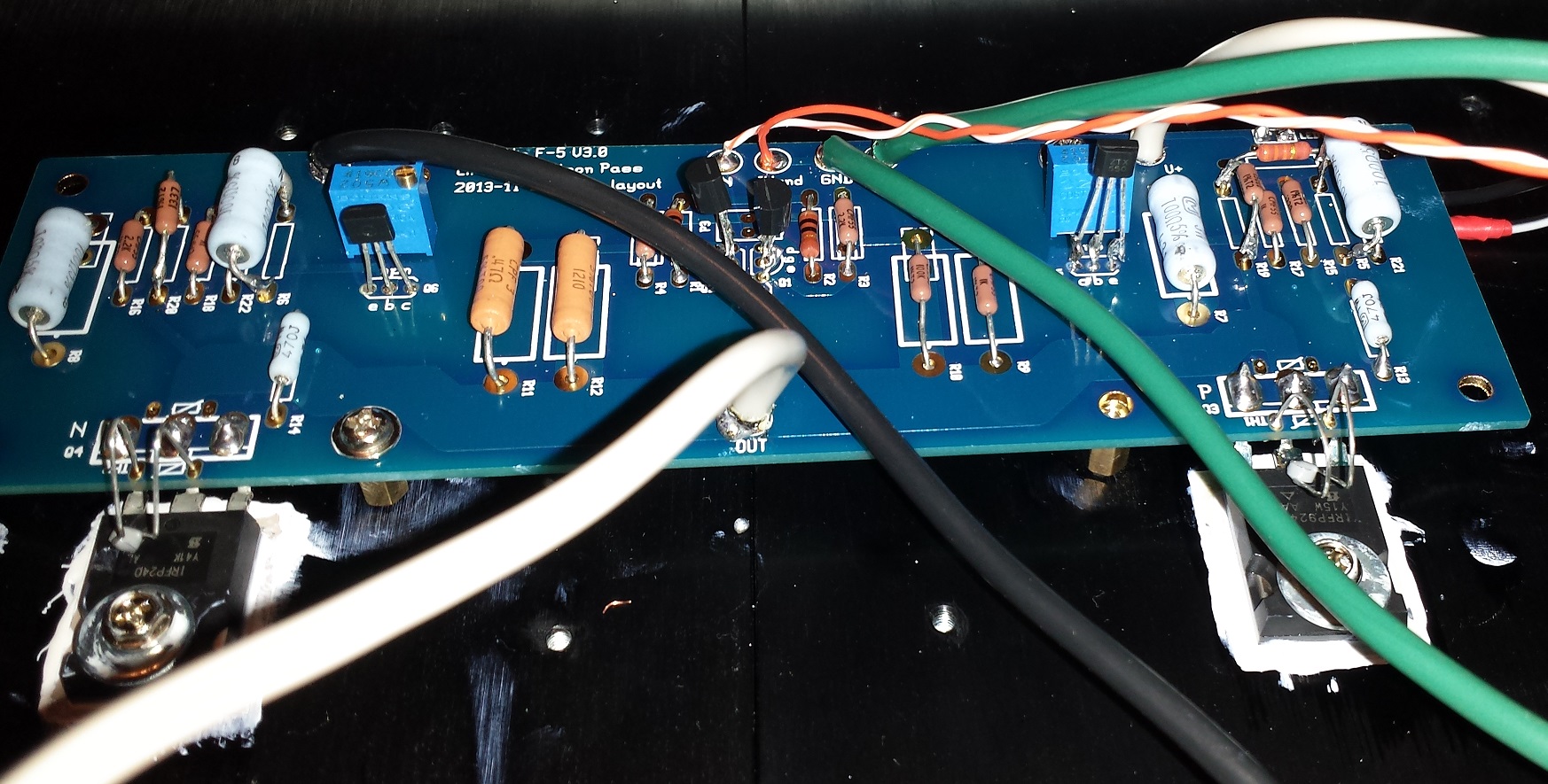

I turned around the transistors (replaced ZTXs and resistors). Does the board look ok now? Can I go ahead and power it on?
PS. I will probably replace the whole board but I want to make sure that it's fine the way it is so I do not waste another pcb/parts
Many thanks

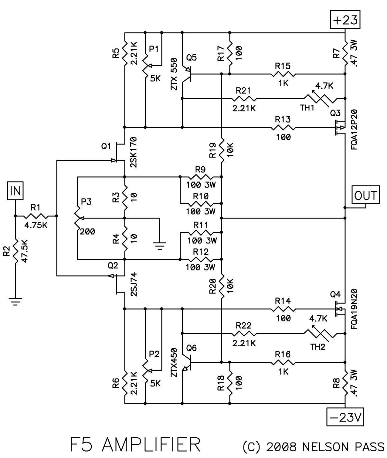

Thanks Eric... before I do that, I did some googling and double checked the resistors value and the ones I am using (from the BOM - for board rev 2, I am using rev 3 - are 100R) but the ones on this schematics posted by 6l6 on the F5 board thread are 10k? Actually there are other differences, for instance the schematic shows R21 and R22 as 2.21k while in the BOM they are 10k. Are versions 2 and 3 of the board using different schematics/versions of the F5?
If someone could clarify this to me, I would greatly appreciate it.

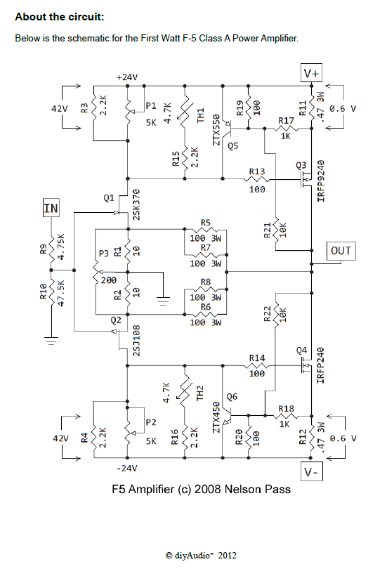

Well I have bigger problems then... the resistors are not the right value...R19 and R20 should be 10k and I am using 100R ! I was following the wrong schematic all along. In the attached schematic from the pdf guide, R19/R20are 100R :( ... like I said in my other post, there are other differences in the values... can you please confirm that 6l6 schematic I linked to is the right one for the store board version 3? Many thanks
Thanks WalterW, I think you are right. I should use the schematics from the 5FT article where Nelson Pass talks about the F5 first before talking about the changes for the Turbo version.
Actually it's all written on the board page in the store... I should have paid more attention to the change log... unfortunately the Schematics button on the same page links to the one for board version 2!
V3.0
Change to F5 schematics from F5 Turbo article
Minor diagram change in NTC and limiter sections
P3 added to adjust N/P variations to reduce distortion
Relabelling of resistors to match schematics
Joined 2012
yep, I checked. The schematic I posted is the right one for the V3.0 boards.
It is from the F5 turbo article with the addition of P3. I have both v2.0 and v3.0 boards here so it was easy to check.
So all resistors, except R13 and R14, seems to be wrong...
