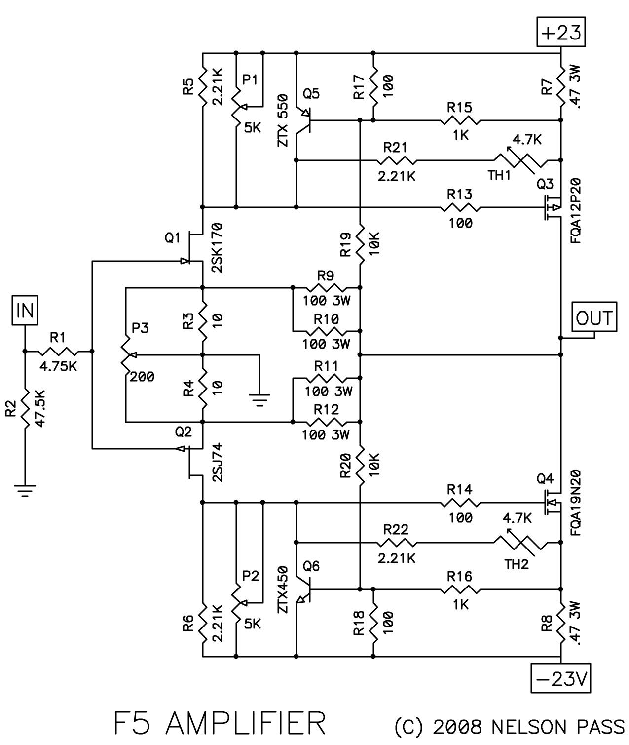

So all resistors, except R13 and R14, seems to be wrong...
lol I might as well start with a brand new board... thanks a lot for confirming

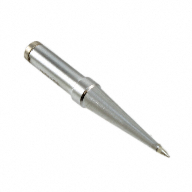

Yes, you would cut the leads close to the body of the resistor. heat it up and then quickly grab it with a needle nose and pull it out. Now get a very fine tip for your soldering station. push it right into the hole and suck the solder out from the other side.

Hi Guys,
I am happy to report that after using the right schematic and parts (attached below for beginners like me ), it all went smoothly. The bias setting went ok too. I just closed it up, put the cover on it at 0.5v and 0.3mv offset. I will check on in a hour or so
Cheers
KJ
P.S. Matched fets (i.e. 2SK170 and 2SJ74) are not in the parts list.

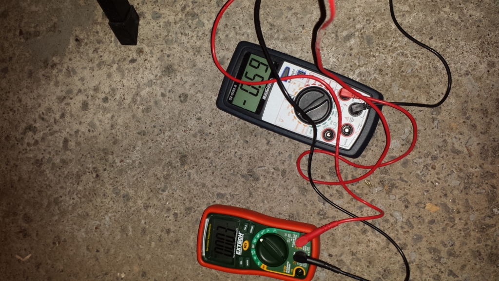

Ok, it's been an hour or so. The offset went up to 6mv...is that normal/acceptable?
I played with P1 and P2 again to lower it a bit...after I have put the cover it started to go up again. It's now at 1.3mv. R7 and R8 are stable at 0.59v
What do you think?
Edit: I have been staring at the meters for the last 10 minutes and the voltage across the output resistors is stable one at 0.59v and one at 0.6v. Offset is going up and down from 1.5mv to 2mv
KJ

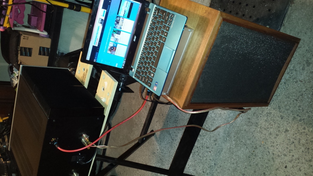

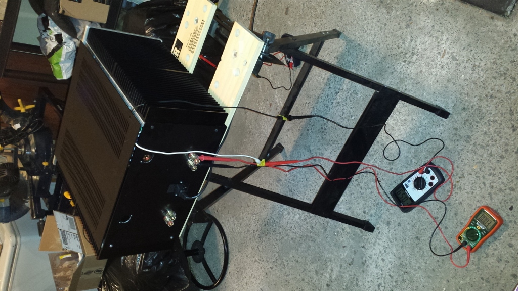

Ok, so I hooked up the one channel I built so far and tested it for close to 2 hours and it worked perfectly and sounded very good. I measured the temp of the mosfets just before I shut the amplifier down and they were 39-40c, so 17 degrees above ambient temp so we're good
Now, on to the other channel...

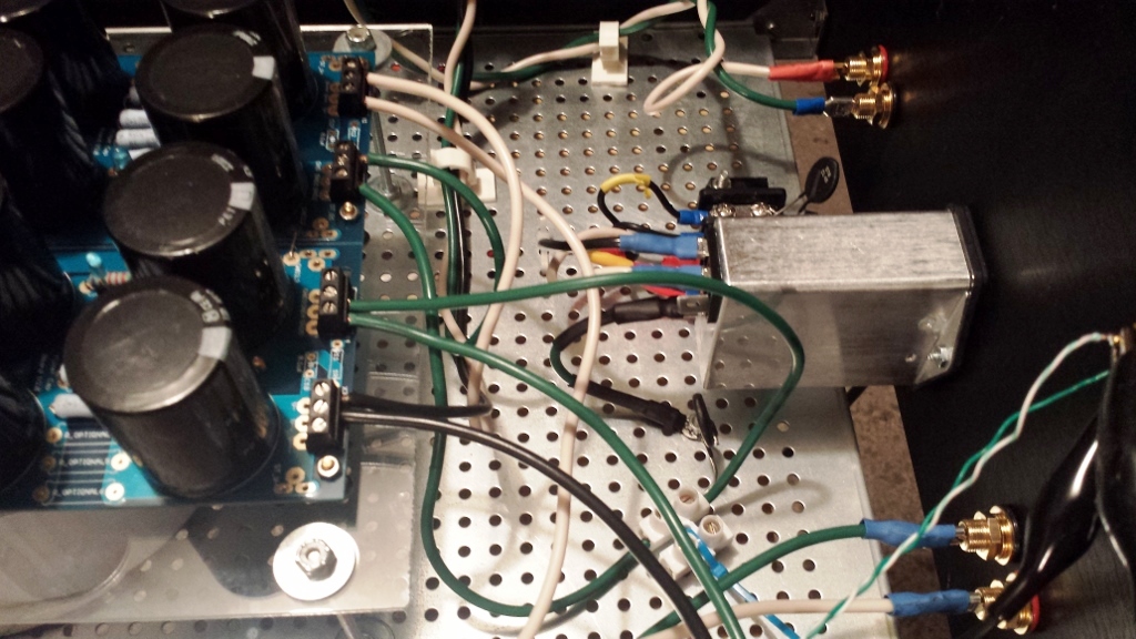

Well the 2nd board did not go well. The bulb stays on... what does it mean? a short? or could it be that I am not wiring the boards properly. Here is a picture of how it is now. I started with only 1 green wire going from the PS board to safety earth through the CL-60. Before I connect the 2nd board, the bulb used to go off very quickly. How long can I afford to wait before I do serious damage?
Any help is much appreciated... thanks
KJ
