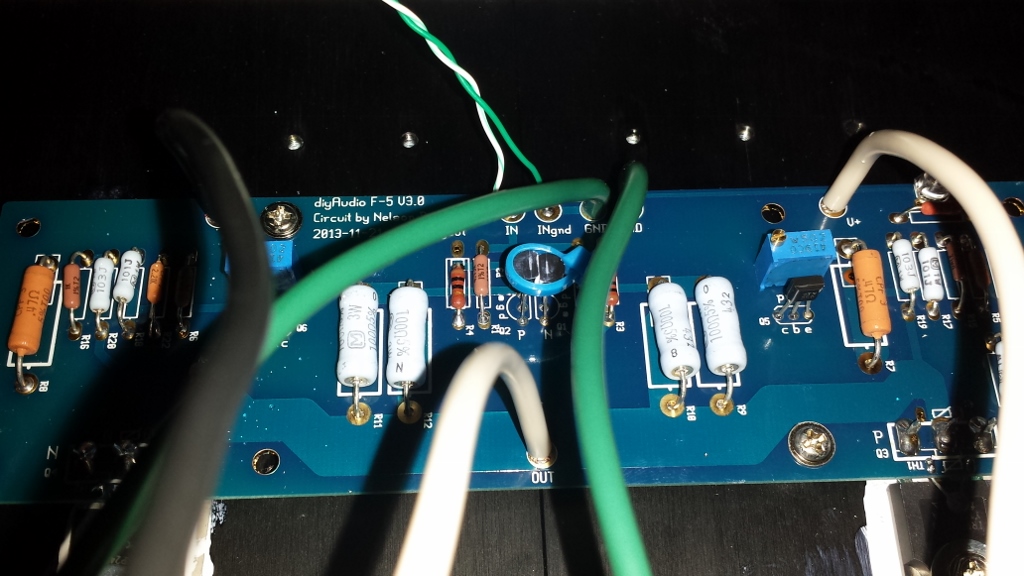

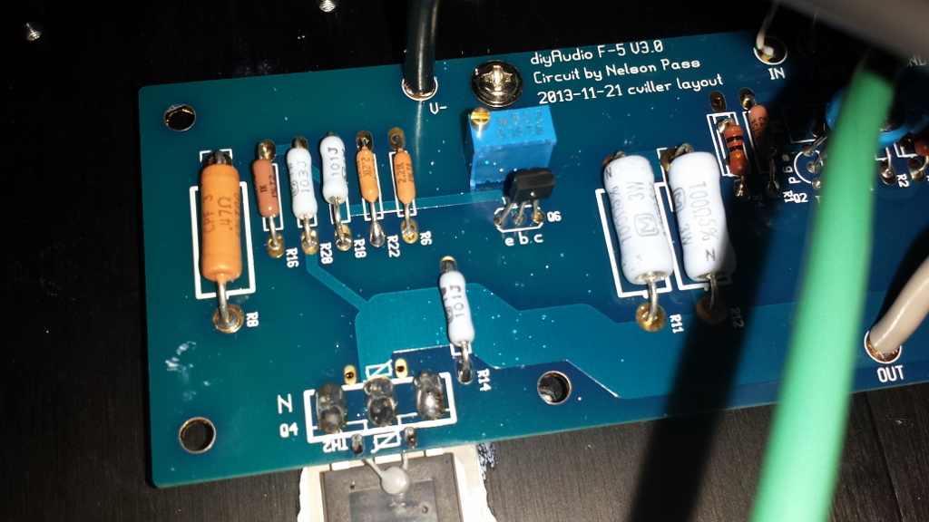

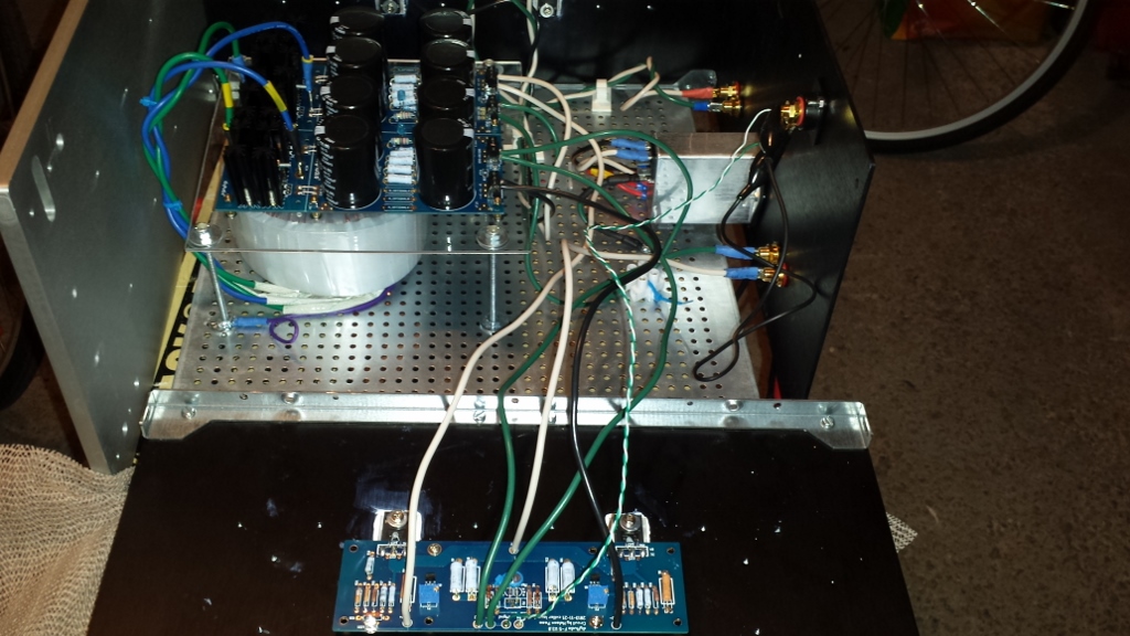

F5 build power on with smoke from R19 and R20
Yes, an antek AS-4218 (2x 18v). I am using the PS board from the store. I am attaching more pictures if it may help you see something odd or miswired.

you can't use bulb tester with fully loaded PSU (first channel soaking juice)
de-attach first channel , then proceed with bulb tester for second channel........ if everything is ok , remove it and proceed with biasing procedure
when done , connect again first channel , check Iq an offset
it may indicate a short. check resistance between center leg of output transistors and sink. and make sure the pots is at minimum resistance. 0 ohm (or Close to 0) across R5/R6.
EDIT: never mind. missed that the first ch was still attached.
Of course 😀 did not know that
disconnected the first channel and tested, the bulb went dim very quickly 🙂 ... I will now proceed with the bias setting
check for both channels, right? or should I leave the first one alone?
Thank you so much
Yes I did check that. No shorts. The pots are at 0. Double checked by moving the pot and measuring R5/R6 to see in which direction the pot works.
Anyway, now with the 1st channel disconnected, the bulb test works fine. Thank you
