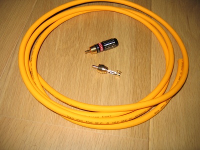

it's the only (easy) available source i have right now.. i need to make some new interlinks to connect my cd player again. Yesterday i bought myself a nice cable (van den hul d102mk3 hybrid) but the rca connectors don't fit well... now i have to buy new plugs too

That cable should fit into your rca's might have to use a drill / dremel to open the end part a little, i had to once do that, where did you get that bright yellow rca cable ? got a picture of the tip so we can see the inside ?
