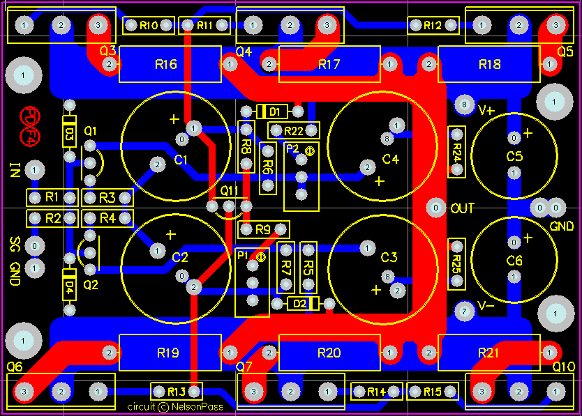

F4 power amplifier
r22 750
r5,r24, r25 1k
p2 500
I changed r22 for a 600 ohms resistor and the problem still there...
Playing with p2 doesn't move the voltage at the output. Is it right to have 12,16v dc at the speakers terminals?
What about the reversed voltage at the speakers terminals?
I can set the bias at 200mv across the .47 resistors with no problem.
Thanks again!

I am using 2SK170BL N-channel and 2SJ74BL P-channel for the input transistors, any indication in case of using these transistors? And 1N5235 (6.8v zenner) instead of 2n4736 (6.8v zenner), but this diodes are there just for protection and they should not affect to the dc offset at the output (I guess).
Vref at the TL431 is 2,49v so it is right.
I think it can't be a bad solder joint because I have the same problem on both channels, I don't know.
Maybe my IRFP's are dead.... how can I check this?
I will try to post a pic of my set as soon as I charge my camera battery...
Another clue... voltage across gates on my IRFP's are around 6v on the 9240's and 4,5v on the 240's, volts between gate and drain.
Thanks again
i agree with the soldering, having same problem on both channels would a big coincidence if it is soldering/faulty part related.
but the only way you can create any dc huge offset is via r5/r7 and r22/p2/r6 (if the fets are working properly). the rest of the circuit is decoupled via c1..c4. if you can adjust the bias and measure 200mv across all the .47 ohm resistors it seems to me fets are oke although i wouldn't know what you would measure if they were broken, that leaves the zeners... and if im wrong i hope someone will correct me!!

Noticed that Peter's PCB has the input go through R1 before shunting to ground via R2. Whereas the latest 6/4/07 Schematic has the Input connected to both R1 and R2 and R2 shunts to ground.
I guess by nature these 2 setups are both voltage dividers.
What's the difference between the 2 circuits?

So should I cut the traces between R1&R2 & R2&D4, jumper between R1/In &R2 to achieve the latest schematic? Worth the effort?
Oops noticed that if I do that, I also need to jumper between D4 and D3/R1.

It seems that there is a problem with P2.
As the adjustment of P2 does not change -12.16V, the P2 must have a problem.
If P2 has the problem at the value of 500, the DC offset must be - value
because the resistance of (P2+R22) is greater than R5.
Hope you will find the problem soon.
:darkside:
P2 works allright, I can pull the resistance up and down.
By the way, I am checking the dc offset on the speaker output with no load and with the input shorted. This is the right way, isn't it?
-12,16v dc output offset, could it be because a mismatch of the IRFP's?
I get different readings of milivolts across de power resistors on N's and P's, around 0,005volts diferences. Does this mean that they are not matched properly?
How can I check if any of the IRFP's are broken?

I think all of your mosfets are ok.
By mistake, I made one of my mosfets damaged during construction and testing, but the trouble was quite different from yours.
If the offset voltage keeps frozen despite the P2 adjustment, I would hardly believe that the P2 is working ok. It is illogic. It doesn’t matter how big the offset is. The offset voltage should be changed according to the changing P2 values. I hope you will check up once again whether all pins of the P2 are connected to the right positions.
You don't need the input shorted. Leave the input open.

Mongosound, if you have the same phenomena at both amplifiers, maybe you made the same mistake around C1/C2 and C3/C4 and maybe D1/D2 and D3/D4:
check polarity of C1/C2 and C3/C4 with schematic and on PCB:
"+" of C1 and C3 should be on internal "+" sub-rails
"-" of C2 and C4 should be on internal "-" sub-rails
If this is okay - please remove C1 and C2 and check dc output.
Remove C3 and C4.
For sure check also "directions" (positions) of D1, D2, D3, D4. Maybe one is upside down at both amplifiers.
