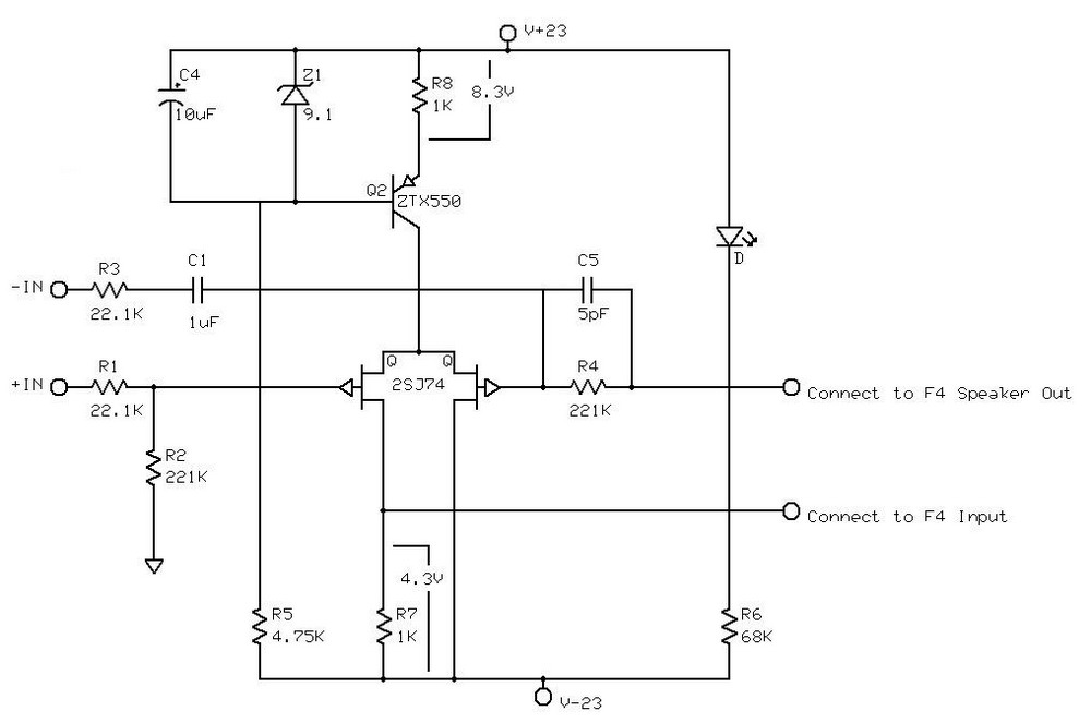

carpenter said:Can I use an Aleph J front end?
yes you can;
but even your compression driver will remain sleepieeeeeee
you forgot that output stage in Aleph have gain , so this front end gives you really eeeny weeeny modulation .
I would like to correct my comment.
NO, YOU CAN'T!!!
You are applying positive feedback.
When the input is +, the output is -.
The feedback should be +.
NO, YOU CAN'T!!!
Babowana said:I would like to correct my comment.
NO, YOU CAN'T!!!
Do I need to use a cap?
I will use the pumpkin for stereo listening, but when I use home theater, I need the receiver for dolby. So, I have to come up with a way to enjoy both.
carpenter said:Is there 18.7 volts above R7? How much of this voltage is available for AC?
if you are still talkin' about Aleph J front end ........ not much .
