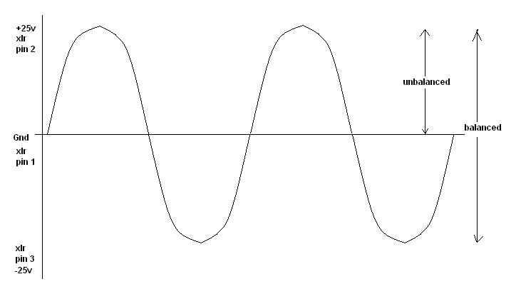

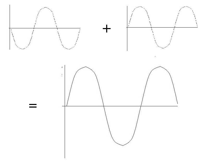

Please help me on this Mr Mod. If I have a sine wave from plus to minus on the balanced output, wouldn't I simultaneously have a half (or clipped bottom) sine wave plus to ground?
In other words: I scope plus to minus and see a full sine. At the same time I scope plus to ground wouldn't I only see the top of the sine?

think A class ........... not see-saw in your workshop , ya crazy yank :clown:
Variac :captain: - each leg is pulling half ; two halves make one ;
half is -6db of one
so - twice :

mpmarino said:
I'm not bustin' on you here, my friend 😉 . I just can't understand how both outputs can be used at the same time. Please see my ugly pic.
Wouldn't this hold true??
edit: I wanna 'get it' :smash:
lookie lookie pic ; disregard difference in frequency .......... I repeat - think Class A - both sides conducts all time ......... or - one leg is conducting all time , other side is just kibitzing and moaning ..... what's work without moaning ? ....... :rofl:
