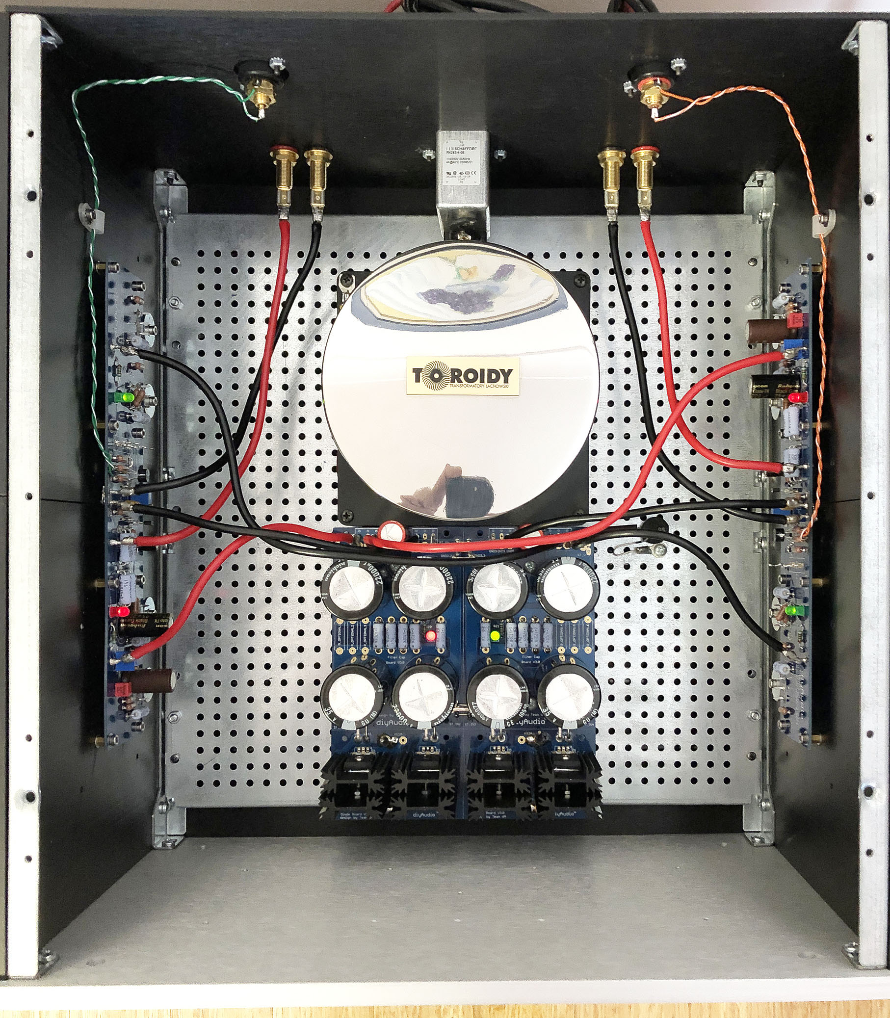

Have a look at the attached photo. You need to be careful with the PCB placements and the length of important wiring.
The mains wiring (most important; has to be shortest possible AND placed very close to the chassis- away from all other parts/wiring) is 10cm long, that INCLUDES the CL60 which I mounted on the IEC RF filter lugs. There is no need to use the terminal block at all.
The DC rails wiring is also minimised (also very important... for the sound quality) because the power supply board is "turned around". I also used a very thick wire here, and the pure copper round lugs that I managed to feed into AMP PCB eyelets.
The non-important wiring, which is the secondary AC wiring, is actually the longest here; it is tucked underneath the transformer base plate and the power supply PCB. Twist each windings' wires tightly.
This is an old photo... I moved to a balanced config a few months ago, which helped remove the mains buzz/hum I had to tame with the 10ohm ground-break resistor. The amp is now completely quiet without the resistor.

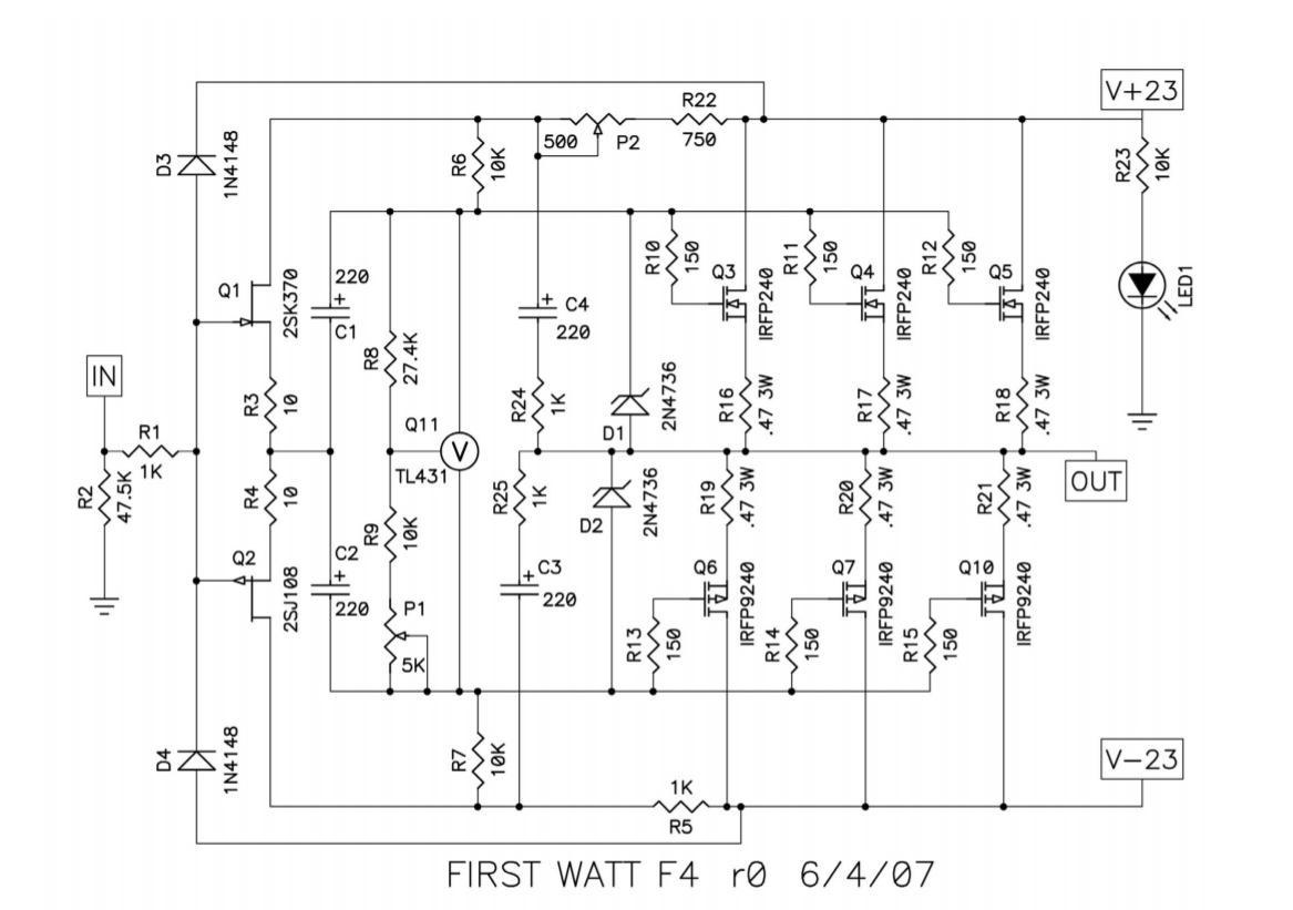

Ideally you want a 13V drop (or larger) across R6 and R7. I am assuming you used the standard version of TL431.
Measure that.
No, I am measuring 9.85 V or so in both channels and both resistors.

This particular device requires a minimum of 1mA cathode current to operate correctly plus you have an additional 0.25mA going through the programing resistors. So you should have a 12.5V drop across those 10k resistors bare minimum.
Maybe replace them with TLVH431 these operate at much lower cathode currents, or change the jfets with lower idss devices or other adjustments.
Proper operation of the shunt regulator will affect PSRR of your amp as proper bias control.

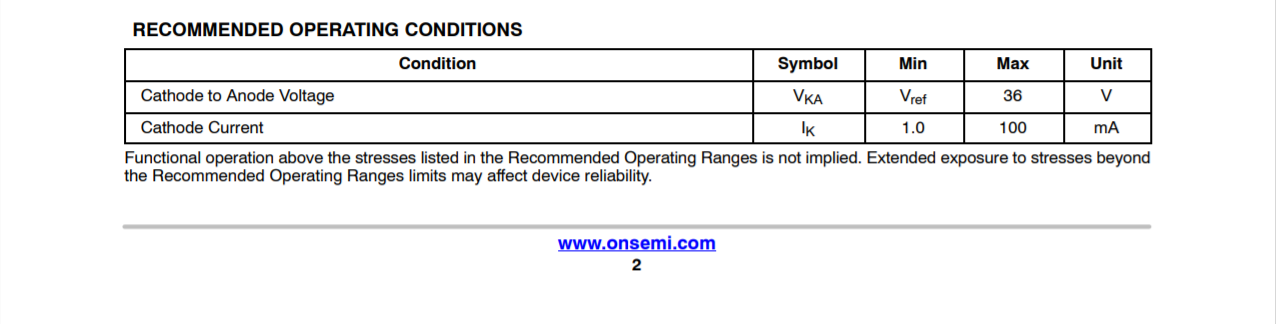

I am confused, is that attached picture shows values 1-100mA for a device appropriate for F4?
All ON devices from have 1-100:
Search results for: tl431bcl Voltage References – Mouser
Those are not appropriate for the circuit?

Should I be getting 2.5 V across R9 and P1? Would that tell me if the current TL431 is working correctly? It is tight in those spaces, but will try to measure.
Edit: there is 1.56 V across the R9 and P1. That should be 2.5 V, yes?

Yeah. You should measure 2.5V
You have a problem with your shunt. You need more current. This should further improve things quite a bit.
TLVH431 will operate with 100uA. You could try that. There are some other that operate with lower current.

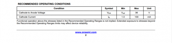

It is appropriate but only if you're jfets don't draw too much current.
To be on the safe side TLVH431 would be a better device as it will operate at much lower currents.
I have a tl431clpm from 2010. It is actually in a sealed bag from digikey. Lol. Would these work?
This one also requires at least 1mA, so that won't work either.
Ok here is another good one
This will operate with a cathode current from as low as 40uA according to the datasheet.
