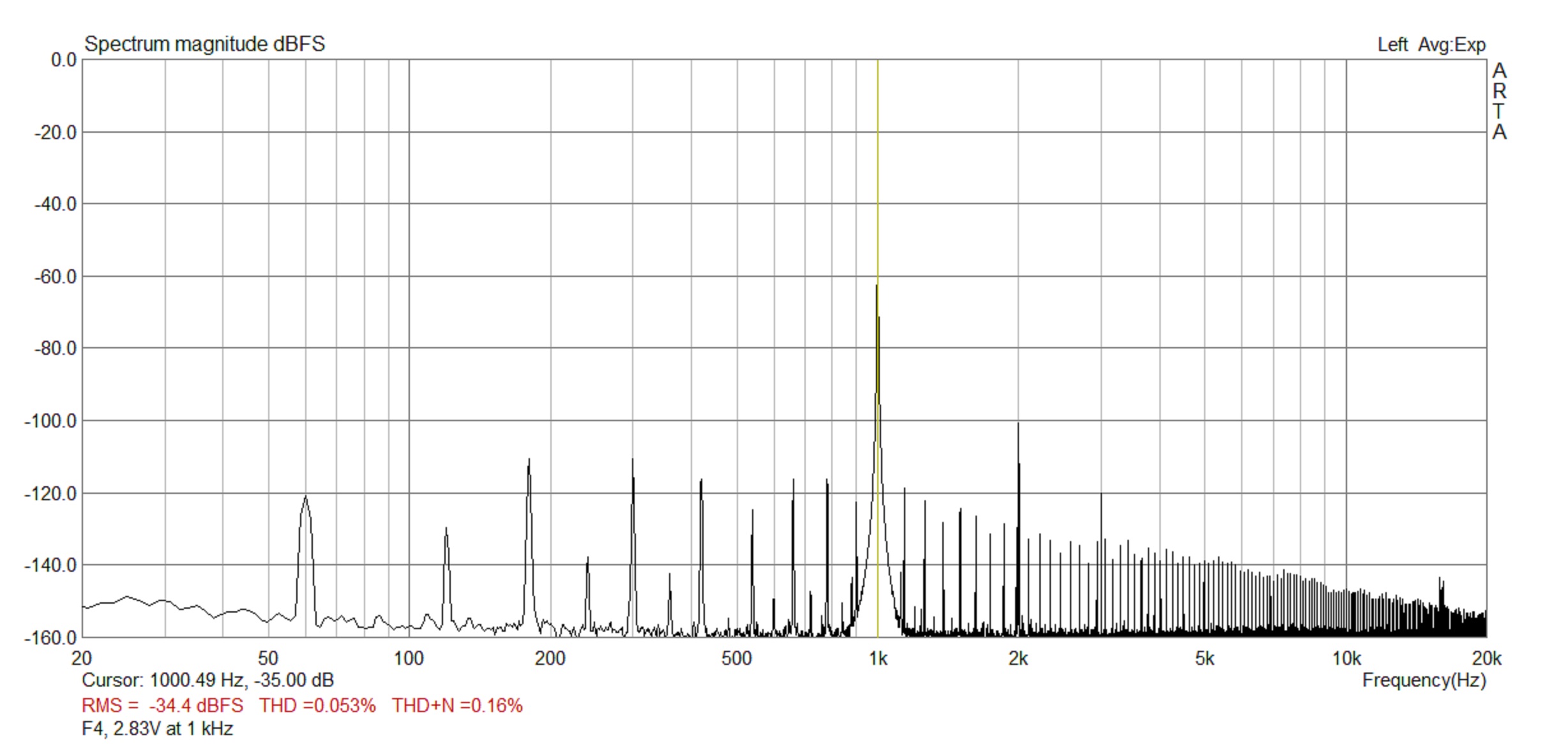

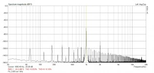

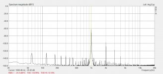

Here is my 1W into 8R. It is right on the spec from the F4 product manual, at 0.05% THD. However, the noise is too much. Looks like multiples of the line frequency. Hmmm... might be my layout and wiring. There is no hum. Very slight buzz can be heard if I put my ear on the 110 db/W horns. Nothing at the listening position.
I also checked the mV on each source resistor, all good. They don't match exactly, but aren't too far off.
Thoughts?

Wow, that noise is crazy. Around -50dB to -70dB relative to the signal is bad.
Should be aiming for -80dB to -100dB. -80dB bare minimum relative to the fundamental signal at 1W.
Seems like it might be from the AC mains wiring.
Do you have X Caps installed across the mains?
Even better get a top quality filtered IEC connector eg schurter etc. Get the nickel plated steel housing one not Aluminium.
Are all your caps in the power supply in good condition?
What bridge rectifiers are you using?
What does you power supply look like?
Then obviously wiring layout, bad connections etc.

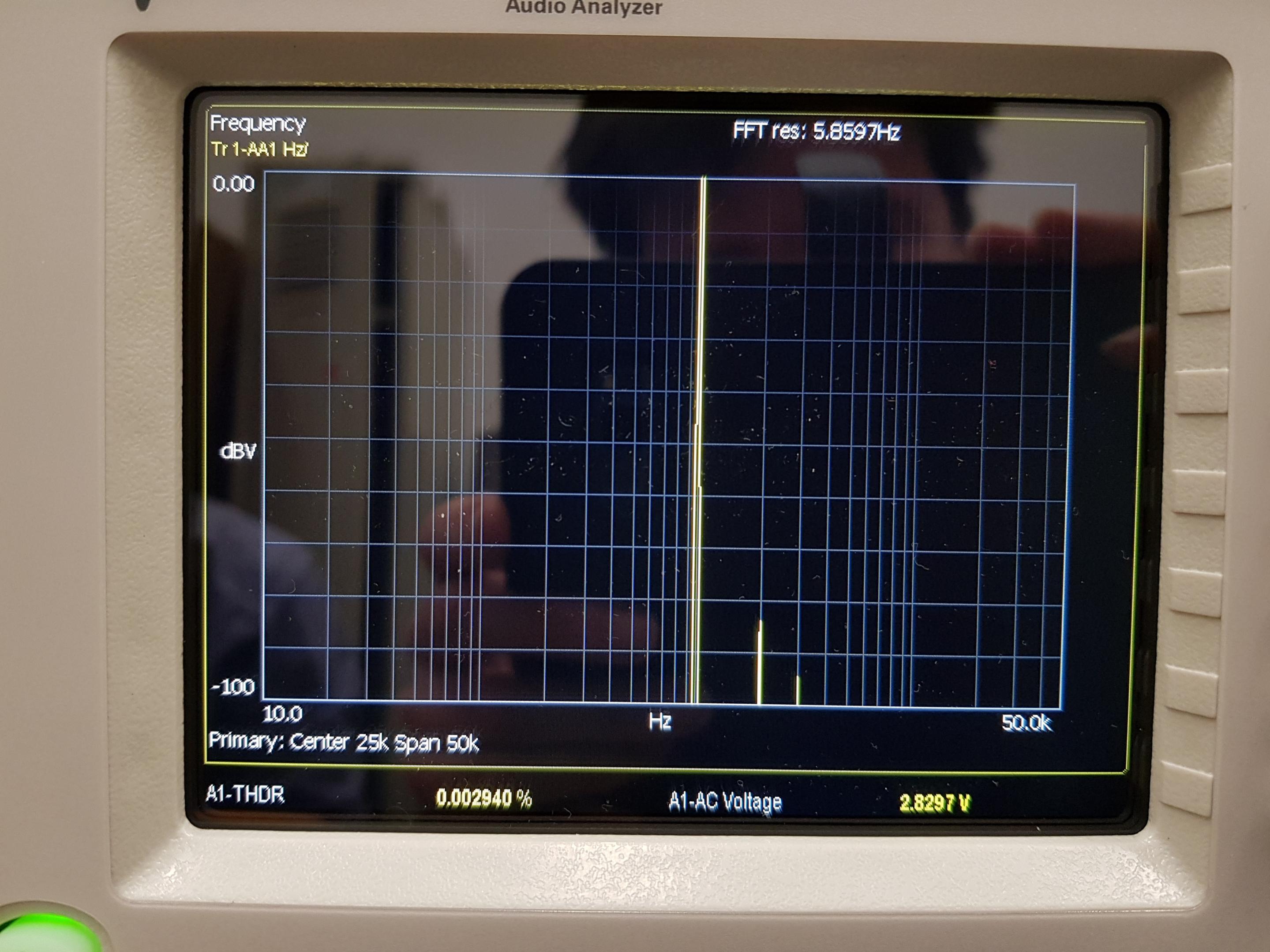

For reference here is mine 0.0029% and no noise down to -100dB, there is noise once you get below that though.
Sounds absolutely beautiful.
Well my amp is not a stock build, but I posted just to show what is achievable.
Let's get your amp fixed. It should sound beautiful.

If you remeasure with the least amount of attenuation necessary how does the measurement look?
Just want to be sure the result is fairly consistent.
Checked JFET Vp of other JFETs from same batch, looks good. These JFETs have been gathered many years ago from members Zhou, Spencer, and others. Some from Mouser. I also have some from LS for testing, but not enough for a full F4.

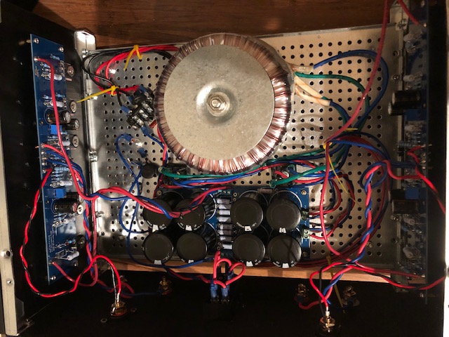

PS is exact copy from FW manual. See pic. I do have a cap across the line terminals.
Yes, I can do a better job with the wiring. I was too eager to finish it and hear it.

Try twisting the transformer secondary wires, and any other wires together.
Keep all signal wires short and routed far away from any ac mains wiring, and away from the transformer. Looks like you have dc wiring in very close proximity to the transformer.

I suspect it is the PS caps or the bridge rectifiers. I have a hard time believing this much noise can be picked up through the wiring.
Heatsinks are getting toasty at about 50 C. The transformer is quite warm to the touch. It is 600 VA. I don't why it is getting so warm.

If you got a piece of right-angle steel say 2mm thick and mounted the transformer on it with the vertical wall facing the direction of the power supply, that could improve things a bit. Shielding the transformer from the dc wiring loom.

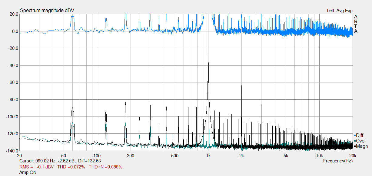

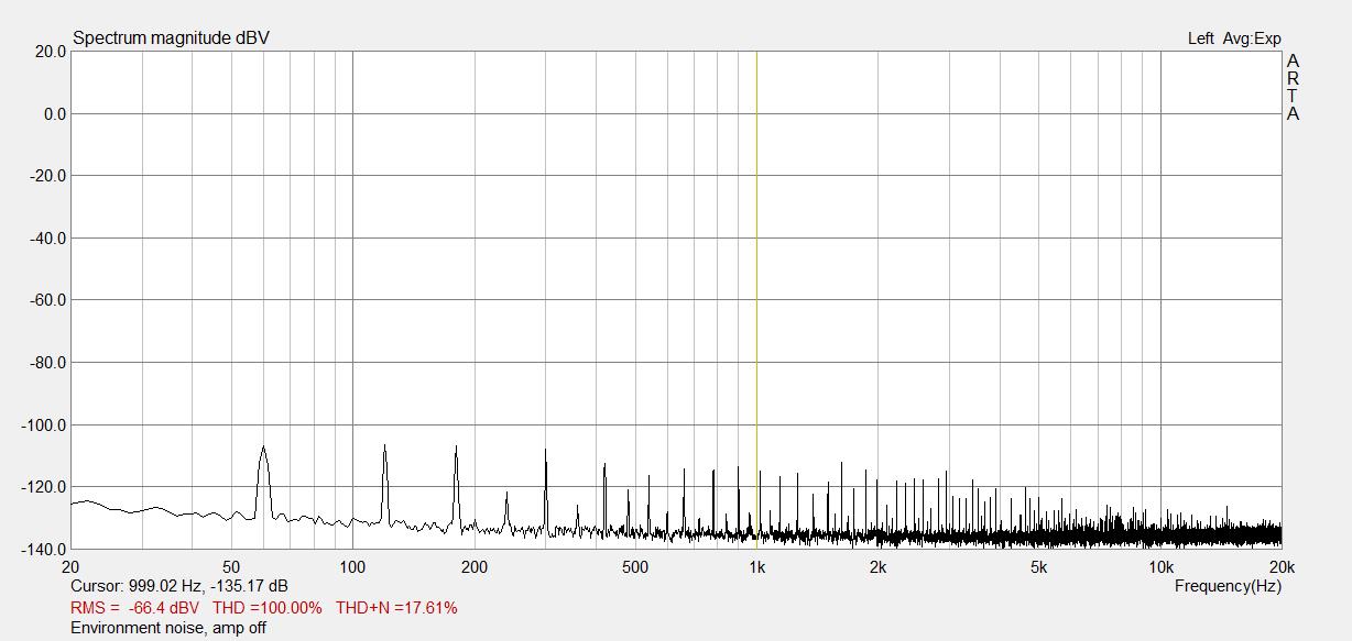

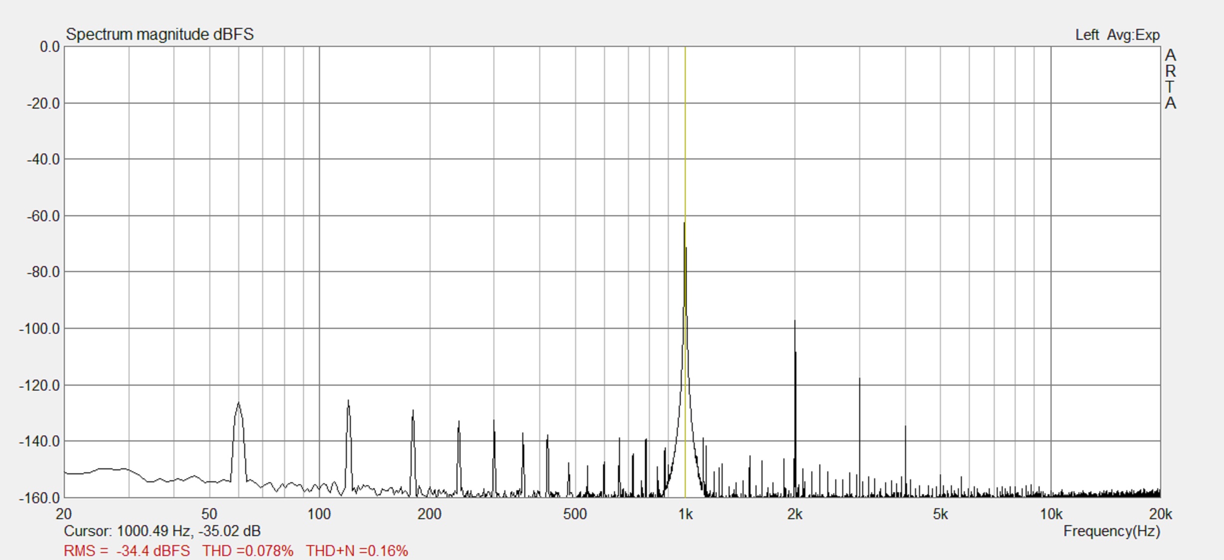

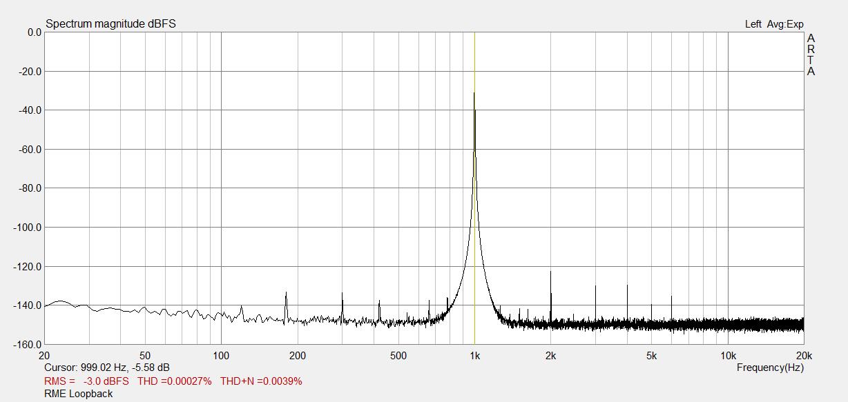

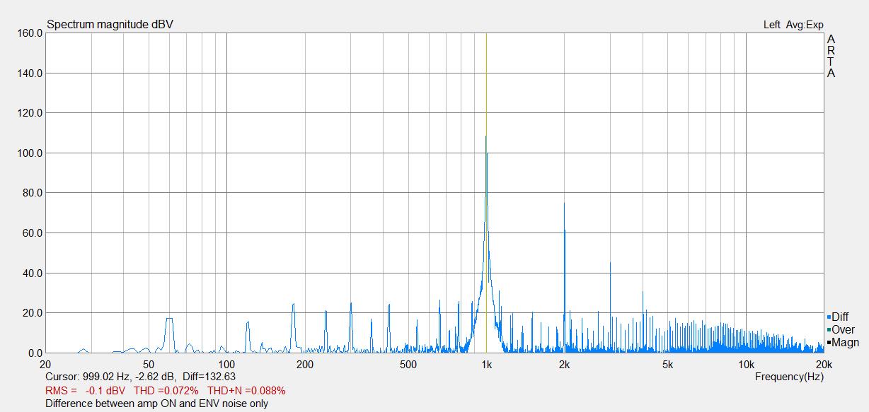

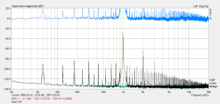

Made some progress today. Moved the rectifiers back and away from the DC out from the PS board. That did it some good, the noise is not so bad now, though it is there.
Here are some more measurements. I adjusted the scaling and levels.
1. First, the environment noise. This is with the amp OFF.
2. Amp ON. A lot better than yesterday.
3. Loopback with RME.
4. Difference between environment only and amp ON.
Ignore the THD. After running it for an hour, it drops to around 0.045%. I was turning it on and off for these measurements.
