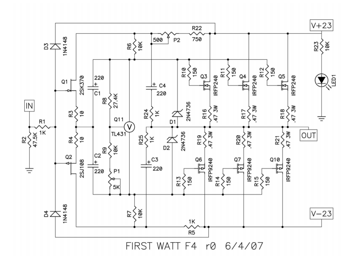

If your jfets don't draw more than say 7mA you're probably ok to use the regular TL431 but then you also have to take into consideration the temperature coefficient of the jfets which will tend to draw more current as they get hotter etc.
So it could be a borderline situation using TL431 depending on the jfets you have.

Also, would I be able to get biasing and everything else working with the wrong part? .
Bloody oath. Essentially what you have is a biased amp through a resistive voltage divider circuit.
The shunt reference is doing absolutely nothing in your circuit.
This is like mixing vegemite with peanut butter. That's a bloody jailable offence right there.
Yeah. You should measure 2.5V
You have a problem with your shunt. You need more current. This should further improve things quite a bit.
TLVH431 will operate with 100uA. You could try that. There are some other that operate with lower current.

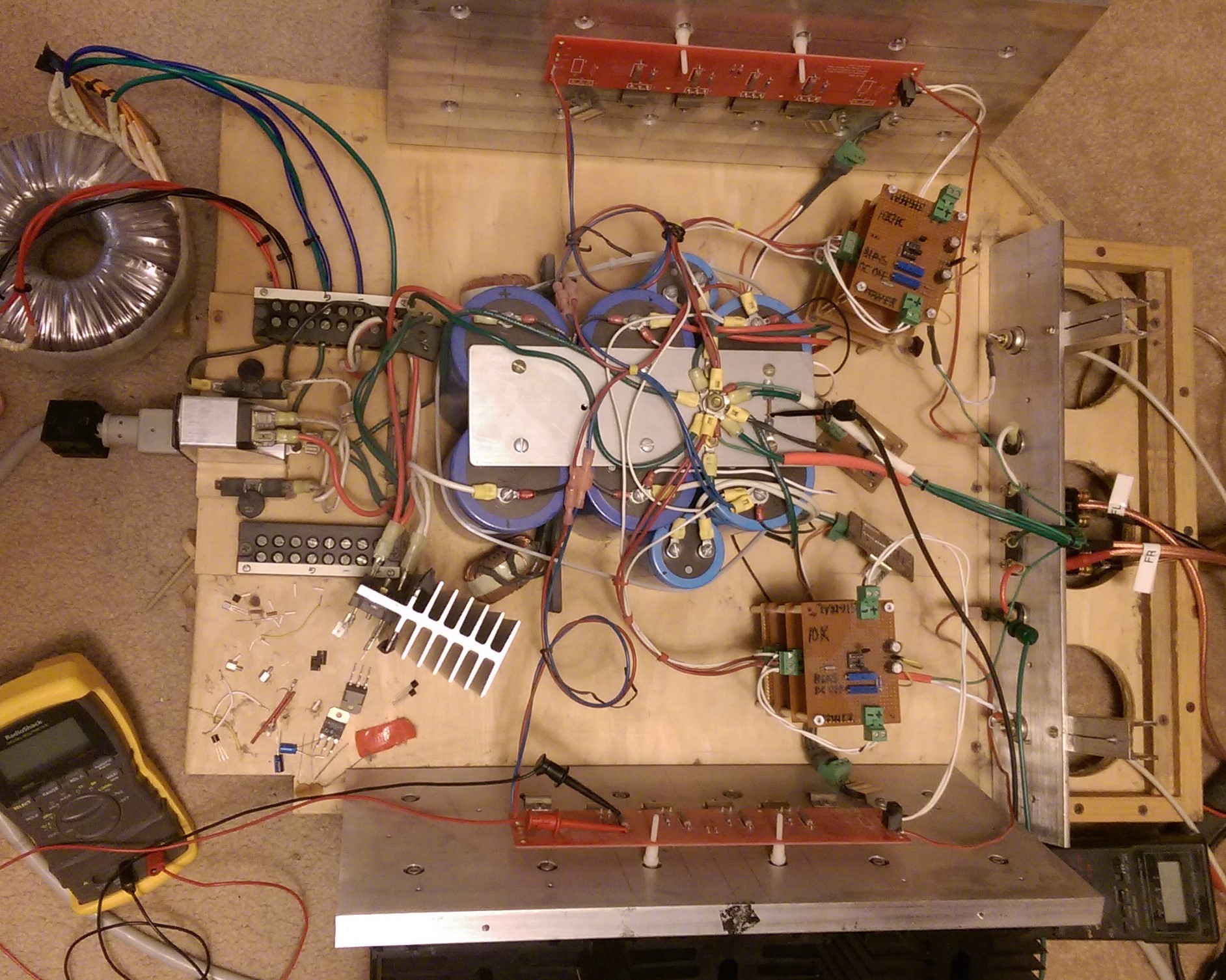

This discussion cued me to open up my amp and do some measurements. I've got 2.23v across r9 and 12.67 across r7. This looks to be right on the edge of ok. Should I be concerned?

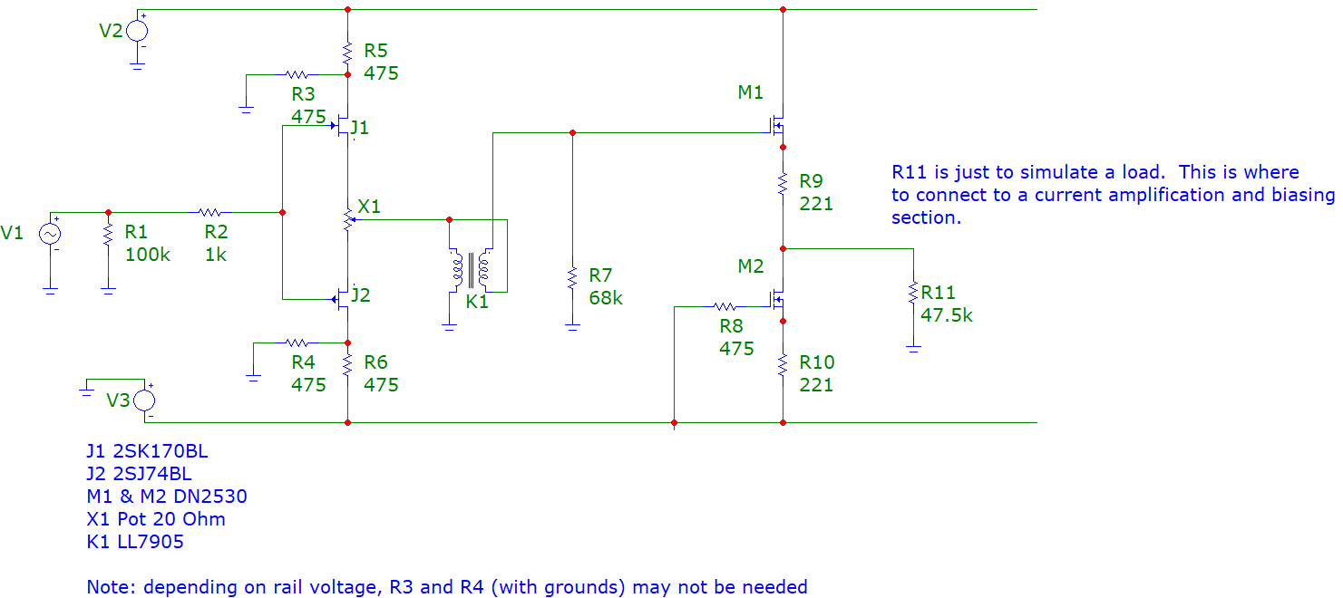

Here is a schematic of the input buffer, voltage amplification section, and
the following buffer. This is from my memory and notes I have here at
work, but I think it is correct.
Whoops. I had J2 upside down. This is corrected (ie: the sources of
J1 and J2 should be toward the POT).

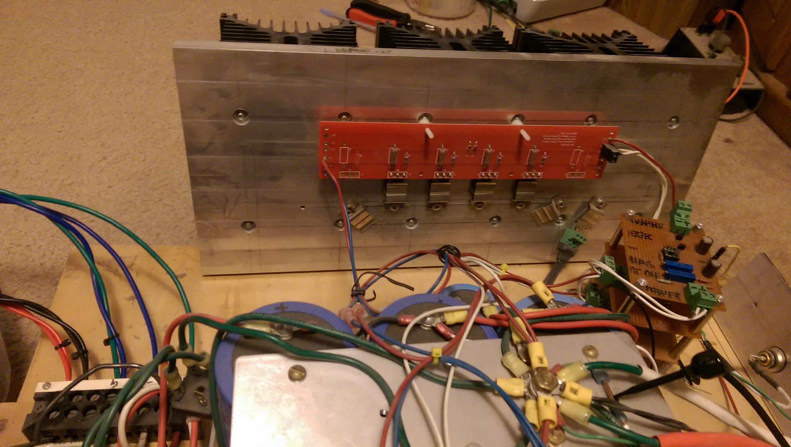

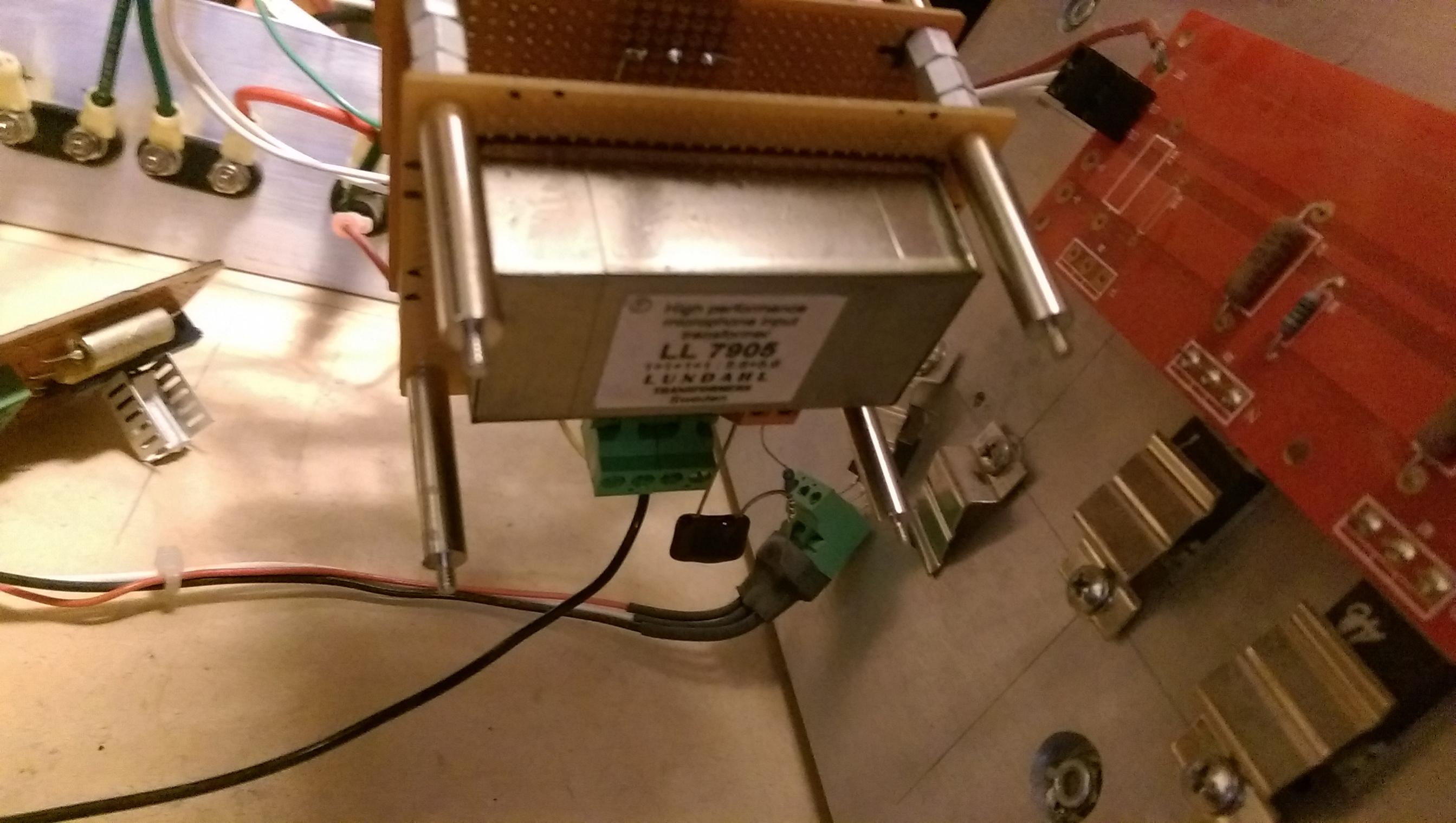

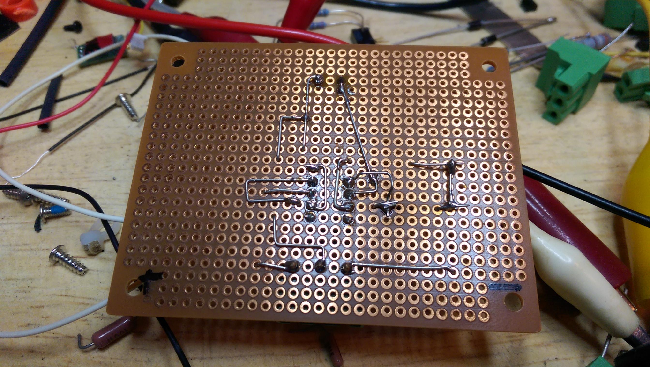

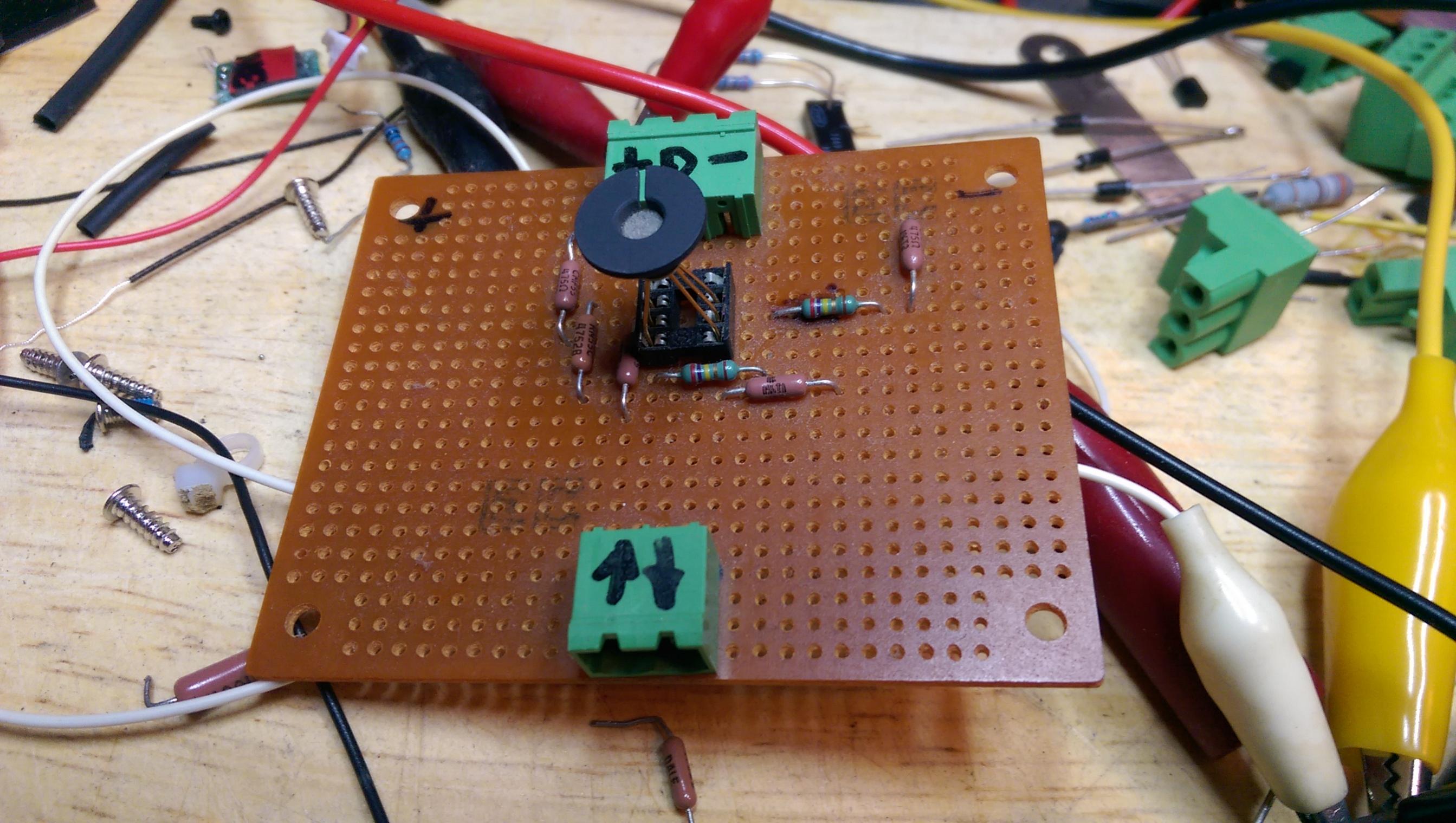

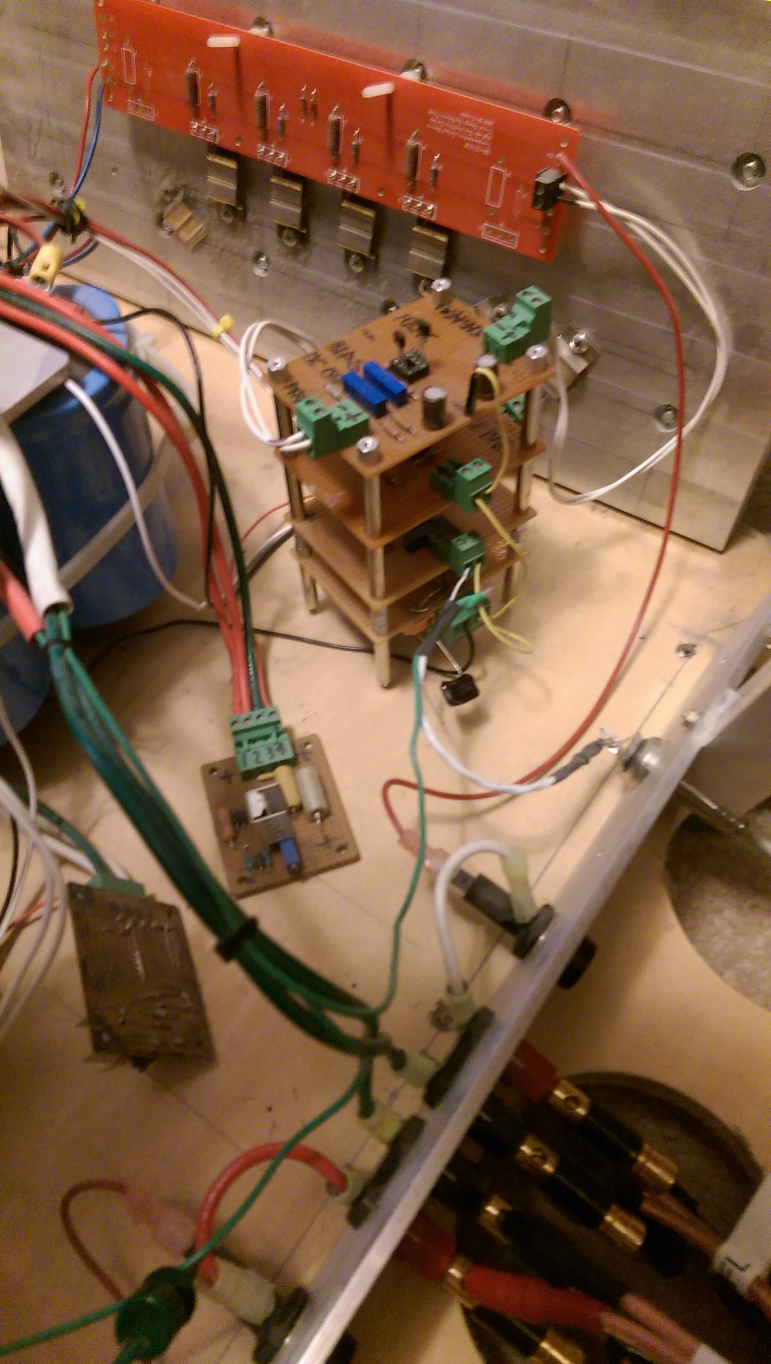

Some pictures would also be nice. I'd love to see an example of an f4 with pTp wiring. I think these are my final amps, so I like to entertain any option that people argue increases perceived sound quality.
Here are some pics. The stack is the LL7905 transformer, the input buffer, the second buffer (the one after the transformer), and the biasing section of the OPS. The picture shows an LSK389 input section. It is not the input section I am currently using (which is shown in the schematic), but it does show the PtP wiring. The other boards in the stack are of similar component count and complexity.
I would measure voltage drop across 10k resistors, R7/R8.
If it's less than 12V then yes. You should fix it.

I read through this thread and some of Jacco's comments on the TL431. I still don't think I understand how it operates. If the Vref is at 2.5 V, then Vout, or the voltage between the gates should be 2.5 x (1 + R8/(R9 + P1)), which is between 7 V and 9 V approximately. How do you calculate the current flowing through the device, I-ka? Is it simply the current flowing through the R6? In my case, that would be 9.6 V / 10k = 0.96 ma, less than what is needed to operate the part. Is that right?
Found one of Papa's comments that the TL431, presumably the part he used, needs at least 300 uA for proper operation. So, any version needing I-ka min below that value should do the trick.
BTW, since yesterday, after the rebiasing and relocation of bridges, the amp is dead quiet, even with my ear on the 110 db/W horns. But I am going to use a riser panel, tilt the trafo and put one of those Antek cans on it, if they will fit. That should give more room in the chassis center to put the bridges.

First measure voltage drop across 10k resistor R6 or R7.
This will tell you total current eg 12V/10k = 1.2mA
Now determine current in programming resistors = 2.5/(P1+R9)
Let's assume P1 + R9 = 10k
So current would 2.5/10k = 0.25mA
So cathode current would be 1.2 - 0.25 = 0.95mA
That would be bad.
So simplifying things, you want to have a 13V drop across the 10k resistors if using TL431.
Or use those devices linked earlier. They require no more than 100uA, to operate correctly.

I'm pretty sure I-ka equals the current through R6 minus the current through R9.
Correct
