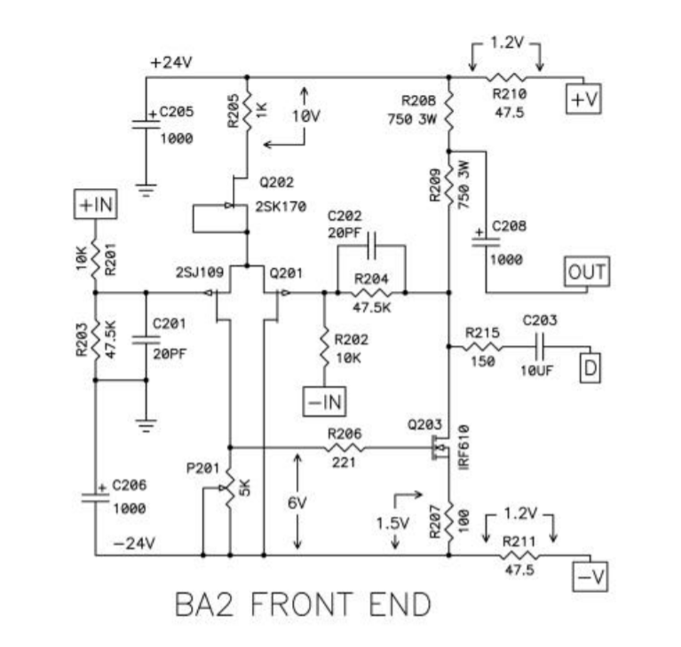

1) Make R207 ZERO
2a) Reduce R208/R209 to 500 Ohms
2b) Increase Bias of Q2 to between 22mA and 24mA
3a) Make R205 ZERO
3b) Make Q202 - 2 or 3 N-Channel Jfets (in parallel) as constant current sources to achieve total of 10mA
4a) Make R210/R211 10 Ohms
4b) Make C205/C206 4700uF
3a) and 3b) may not be super important, I am a little OCD about certain things.
The other mods should definitely be implemented.

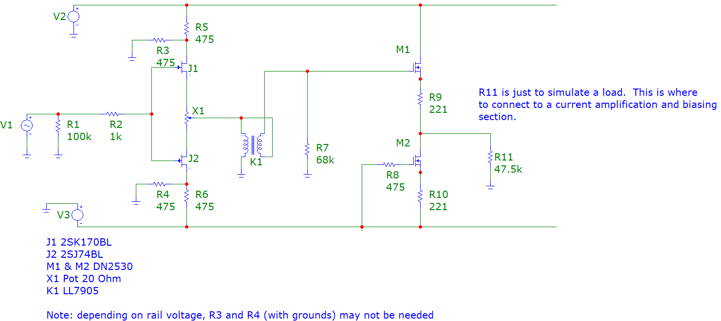

Here is a schematic of the input buffer, voltage amplification section, and
the following buffer. This is from my memory and notes I have here at
work, but I think it is correct.
The exception to that is R7. R7 is used for transformer frequency response
compensation (filter the ringing). R7 is a theoretical and is a goal. In my
working circuit, this is actually an RC circuit, but I don't remember the values.
I also have a 475 ohm resistor on the gate of M1, but again, I think the
inductance of the transformer with R7 should relieve that need. But this is
and area that shows the difference between theory and practice. (or maybe
I'm a perfectionist). 🙂
Remove R11 and the associated ground, and connect to your output section.
My OPS is capacitor coupled and therefore needs the current supplied by the
second buffer. At 33V rails, the second buffer is biased to about 10mA. I
use heat sink caps on the DN2530's as they are near their power limit.
I should be able to post some pictures later.
Thanks,
Robert

Don't expect anything artistic from me! 🙂 I have no kids or pets,
so I can keep the amp pretty open and accessible (as you will see
when I post pics). You're quite right about the rest. That is something
to keep in mind when looking at the performance graphs.
Dividing the circuit into sections helps with experimentation and
making the PtP wiring feasible. The buffers are simple to make and
easily switched to a different design (which I took as the main point
of the BA project.)
