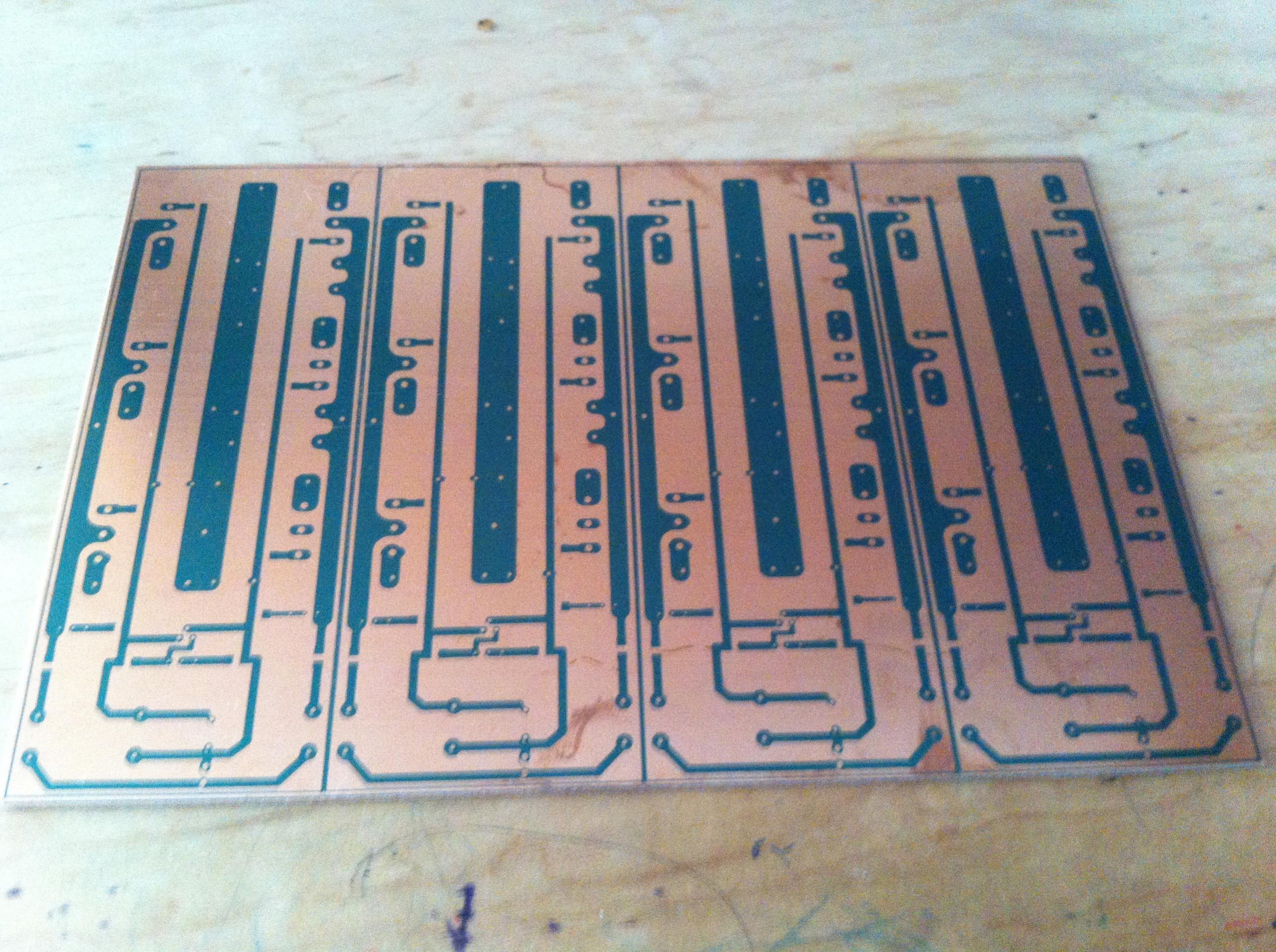

F4 power amplifier
Soon enough.

Sorry. missed some questions. These boars are 6" long. THey will allow a bias at my chosen point of .5a/fet for total of 1.5a Iq. The SE bias will be about 1/10th of that. With a bridged amp , we are talking something like 30W class a into 8R, similar to the Firstwatt series. This is mainly a test of the Se bias concept as well as the FE boards that will be pushing it along. AB power will be higher due to available rail voltage. On my expected set of speakers, this will be an exuberant amount of power. That being said i may use more fets in the end.
