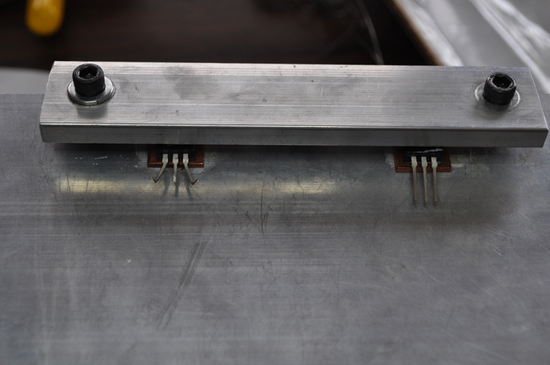

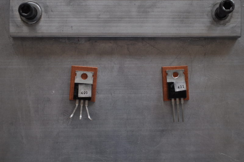

What is the impact of being too small? They cannot dissipate as much heat?
In the F4, the MOSFETs only dissipate about 10 watts each, which should not be a problem with their smaller footprint. If you need to dissipate 30 watts each, you can attach TO-220 MOSFETs to copper heat spreaders using thermal epoxy and clamp them to the heatsink like shown below. In the left image, the TO-220 FETs had not yet been glued to the copper. In the right image, the FETs are secured to the heatsink using an aluminum bar and misc&grease insulation.What is the impact of being too small? They cannot dissipate as much heat?
