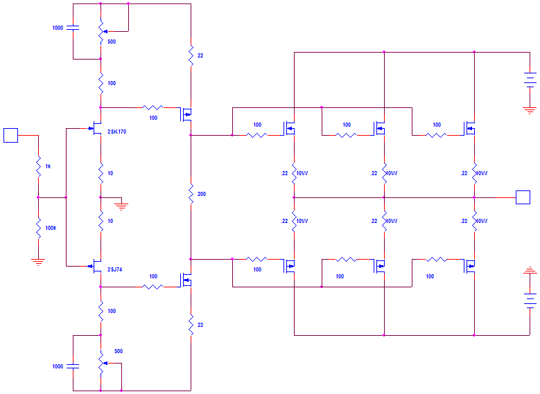

How exactly is it to build a crippled F4 with a BA3?
I thought of building them in modules and interconnect like a BA3 pre to a F4 power. The BA3 gain should be more than enough to drive a F4 properly from what i understand.
If someone could suggest a better way, I would be happy to learn it. :)
I was thinking of trying something like you see below. This is only a start. I think maybe more thinking is in order around that 200 ohm resistor... Guess the front end needs some power too...
Crippled F4 is basically BA PP output stage. You make FE capable of driving it,like BA2 or 3, or even what FLG is suggesting. I thought an LU SRPP or mu Follower biased at about 300ma might do the job nicely.
Euh, any reference ?
I have been playin garound with the LU in sims for quite a while. After i get th eFairchild thing sorted, i plan to actually build it. From what i ahve read, th SRPP lperforms very well as voltage amplification stage into high impedance loads. Perhaps in this case, the F4 might be better suited than BA output. I hope to see.
http://www.diyaudio.com/forums/attachments/pass-labs/272489d1332079795-
The bias current resistor should be variable one way or another; R200 becomes P1. Or use a TL431 setting like in BA2 output.
And - - - have a DC point as this is floating now. Instead of DC feedback to the input sources, it is also possible to connect the speakers to a pair of capacitors of say 10.000 muF to both rails.

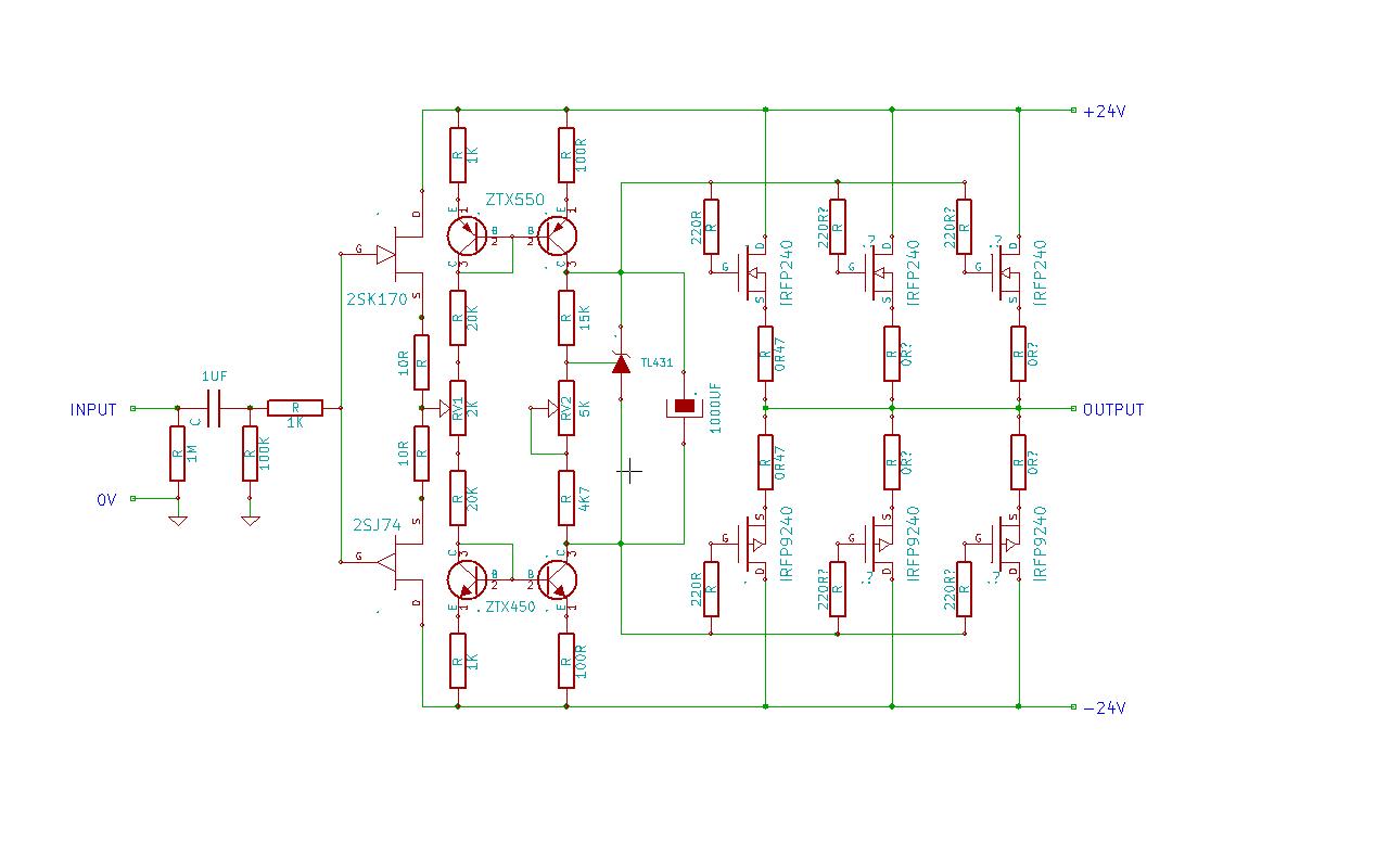

F4 variation
I haven't built this yet, so I don't know if it works. I am curious to see how much the 220uF coupling caps affect the sound, probably not much and easier to find out the 'cap sound' by fitting one to the input of an F5 - but the cap wouldn't have a bias voltage as it does in the F4. Anyway, this is my brain fart, the 1M and 1uF at the input can be dispensed with, and some of the values may need tweaking. Can't help feeling I've over looked something, I'm sure someone will point it out.
