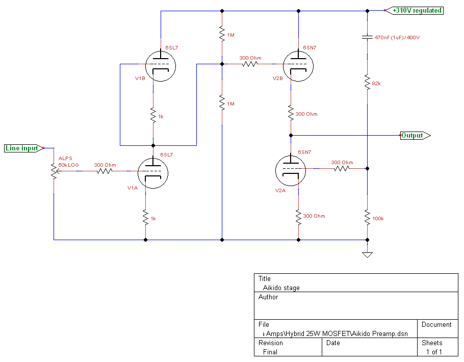

Direct drive
Just to be sure. I have aikido preamp driving directly crippled output stage. Aikido has 500 Ohm output impedance and 8mA max output current capability. Is 8mA output current able to drive the crippled F4 without any problems?
but you can always do better
That means that there is some benefit of more current drive? Less THD or something else?
well , it's easy
try your Aikido with crippled and with regular F4 , then choose what you like more
I don't like Aikido ; somehow lacking in dynamics , comparing to some other brute solutions (which I like more - killer PSU and high xconductance toobz)
I know certain toobz pre with excellent psu that makes a sweet combo for naked F4 if you are interested. Beats any SS pre I have tried, but I have not tried them all.
Sure, why not. Can you post schematics or link?
Look up Salas 6v6. Excellent musical pre. Will give you a taste of big triode pre.(triode strapped beam tetrode, i think)
